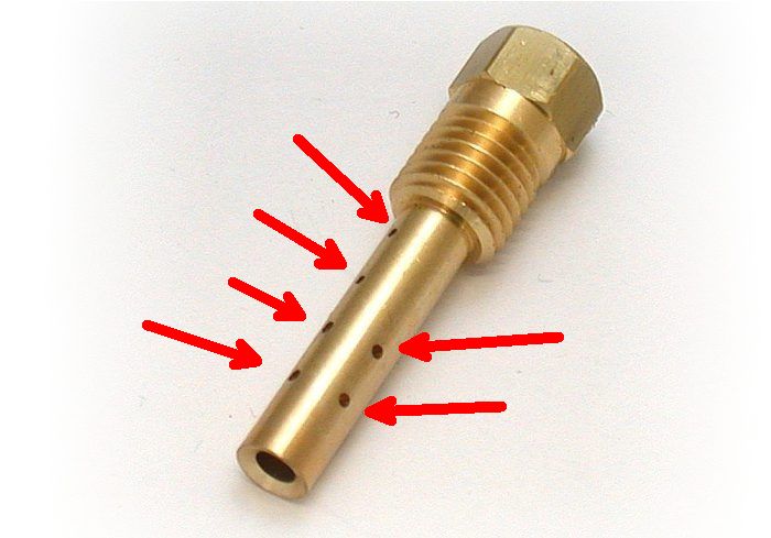

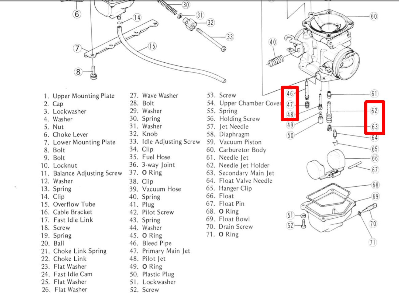

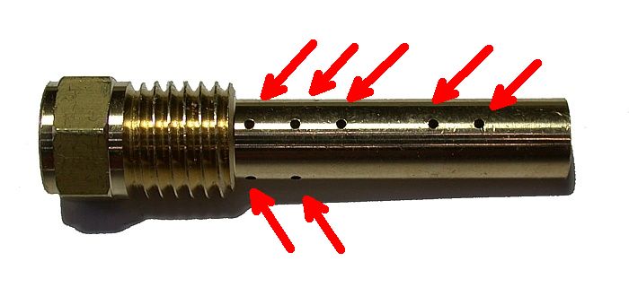

Sounds like your engine runs very lean on the pilot circuit. Are you sure your jets and needle holder tubes ( main jet ) are clean and not clooged.

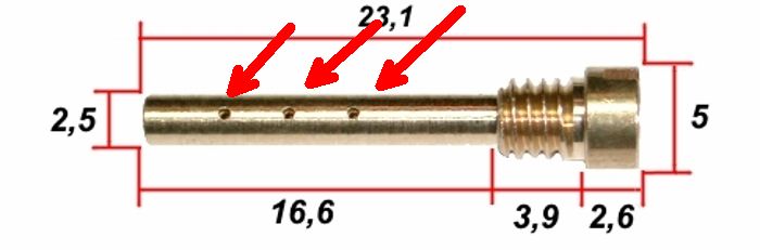

took all the jets, holders, pipes, what have you, out and shot carb cleaner through them, then air compressed all around, and repeated that twice; so everything got it three times. Then I checked to make sure I could see through them, so I can clean it again I just don't know if that would even do anything.
Did you cleaned these holes in the main jet holder pipes and pilot jets too?
