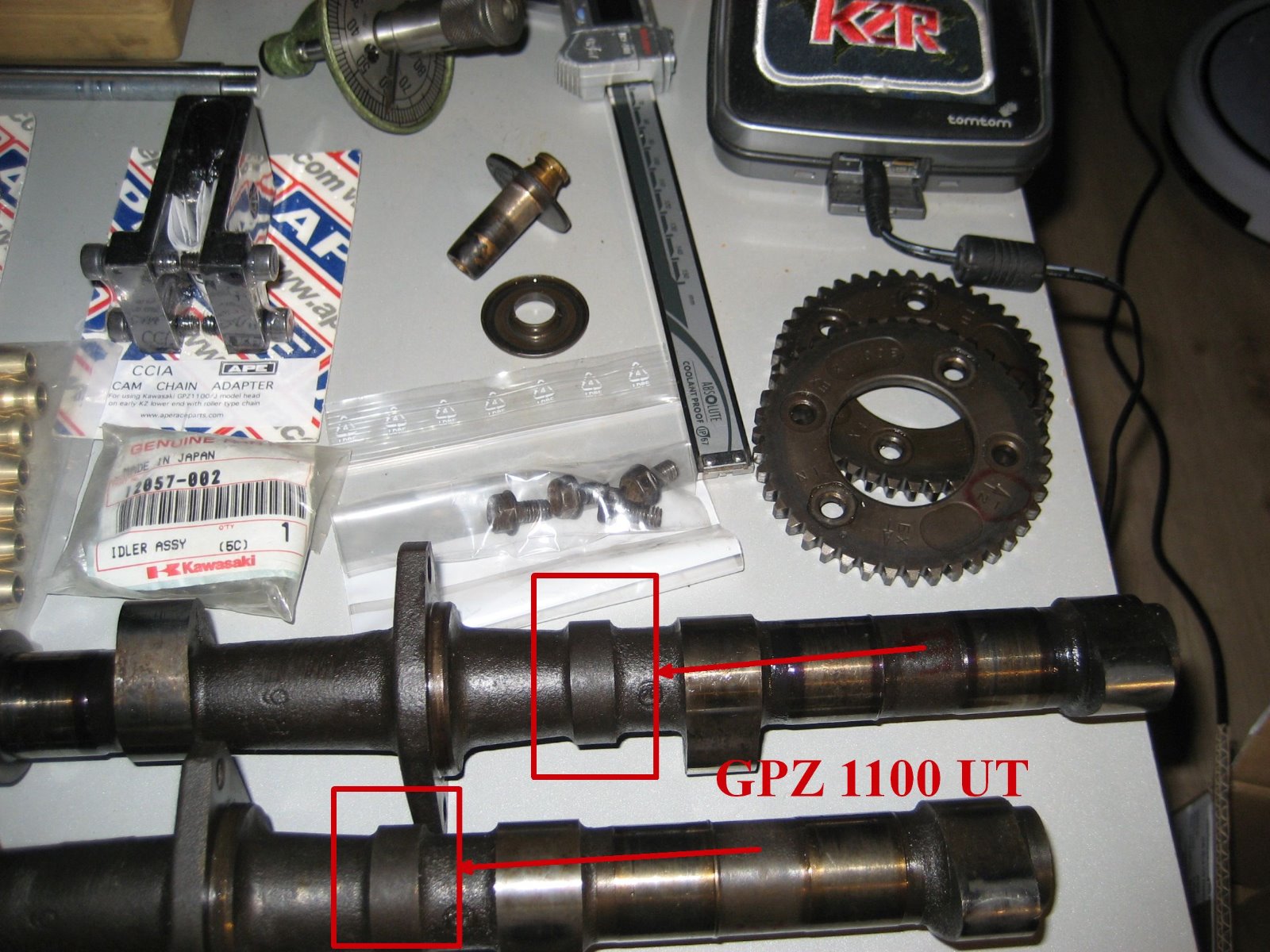

GPZ cams are plug and play. I put GPZ1100 UT cams into my cyl. head with no prob. GPZ1100 UT cams has the highest lift.
GPZ1100 UT cams had NO grooves.

21 Jul 2019 14:22Scirocco wrote: GPZ cams are plug and play. I put GPZ1100 UT cams into my cyl. head with no prob. GPZ1100 UT cams has the highest lift.
Nice, where did u come across those, cause I figured since I’m gonna be in the top of the engine anyway I thought I would look around and maybe come across something.
