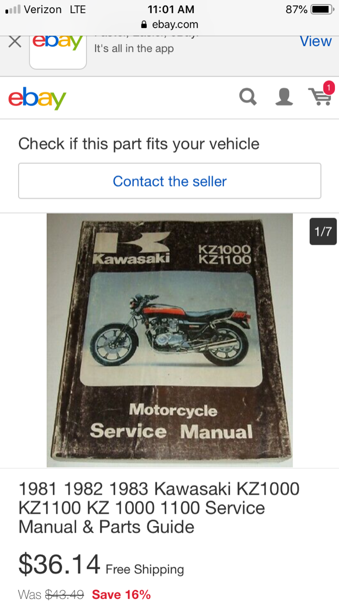

Ok , appreciate that, I think I was trusting that clymers to much now that I’m speaking with all of u. I did find a factory manual like the one I downloaded on eBay do 34 probably gonna grab that before it’s gone.

Is this the same
1986 KZ1000P
2005 Vmax
  • Scirocco
  • Scirocco's Avatar
  • Premium Member
  • Premium Member
  • Posts: 4397
  • Thanks: 2262
Re: Kz 1000 police piston rings
20 Jul 2019 09:10
#807879
yes, it´s the same as i post before.

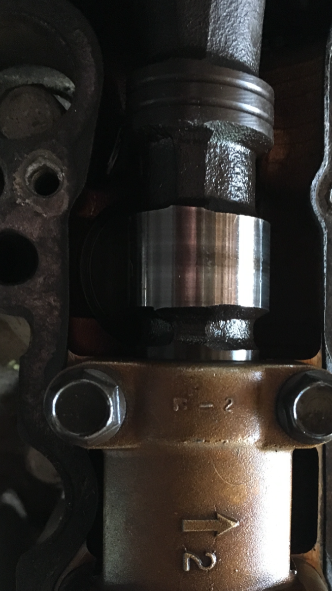

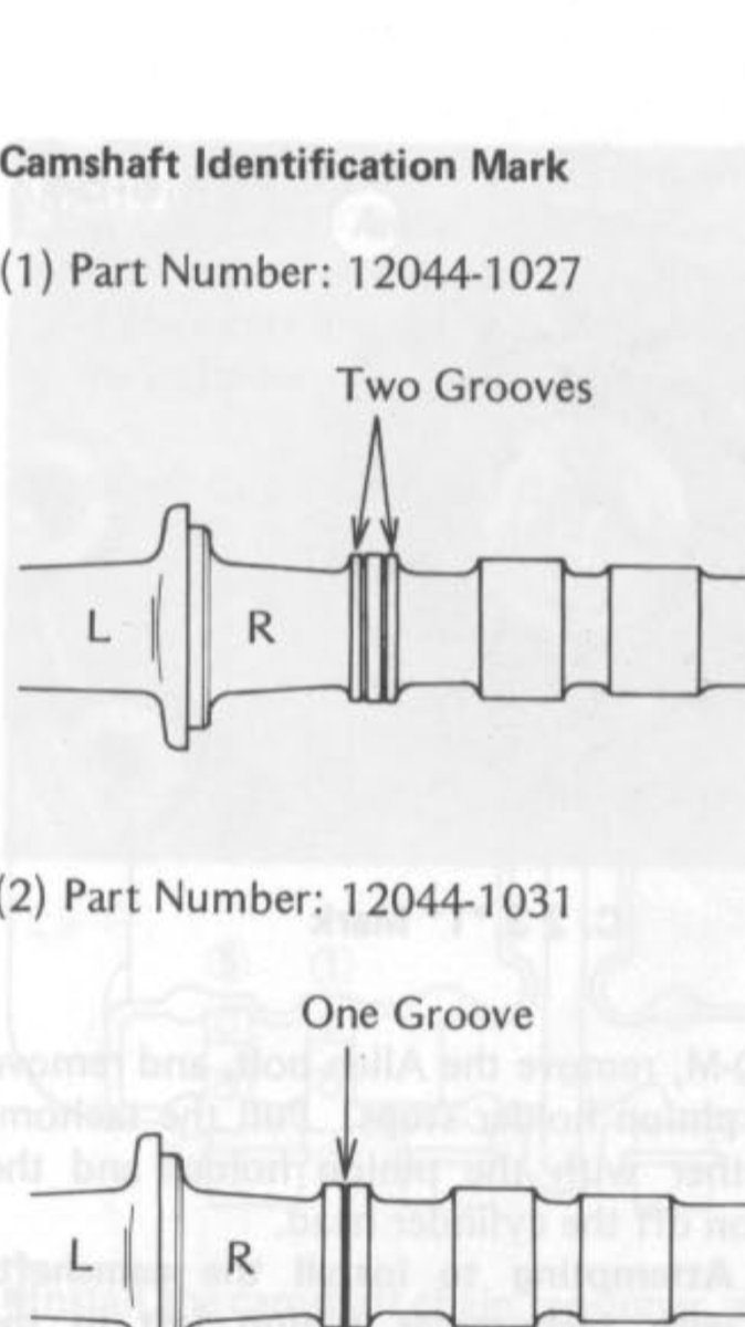

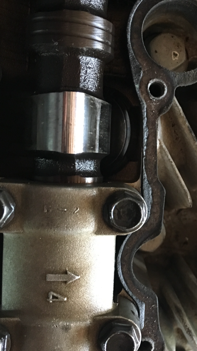

Been reading that manual I downloaded and from memory and pics I took I believe I have the (K) cams in the bike not the (J) cams. Can this make a big difference
