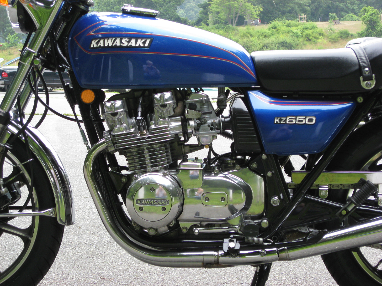

I guess to some degree it depends on the condition of the engine when you start. I cleaned my engine using metal polish. Yes, it took me several days, but when I was done I though it looked pretty good. Ed

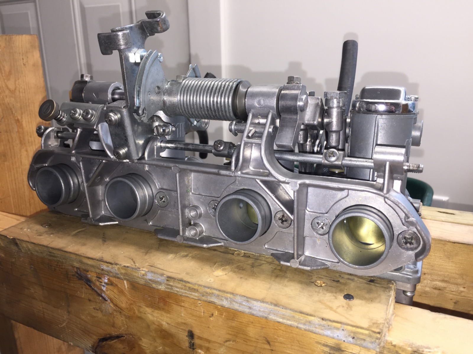

In my experience the best way to clean the engine in the frame is to use plenty of carb spray cleaner along with a lot of rags. To bring the finish back requires Mothers polish and a bunch more rags. It's very hard to get into the air vents along the front of the engine but you with patience you can do a fair job.
Vapour blasting is the best solution but you need to pull the engine and dismantle it. I have a friend who has a vapour blaster and he says he has done an engine without dismantling it, but he's an expert with a blaster.
For your carbs, the best way is to pull them apart, ultrasonic them to remove the grease and stains and then vapour blast them. Here is what they can look like, along with vapour blasted engine parts.

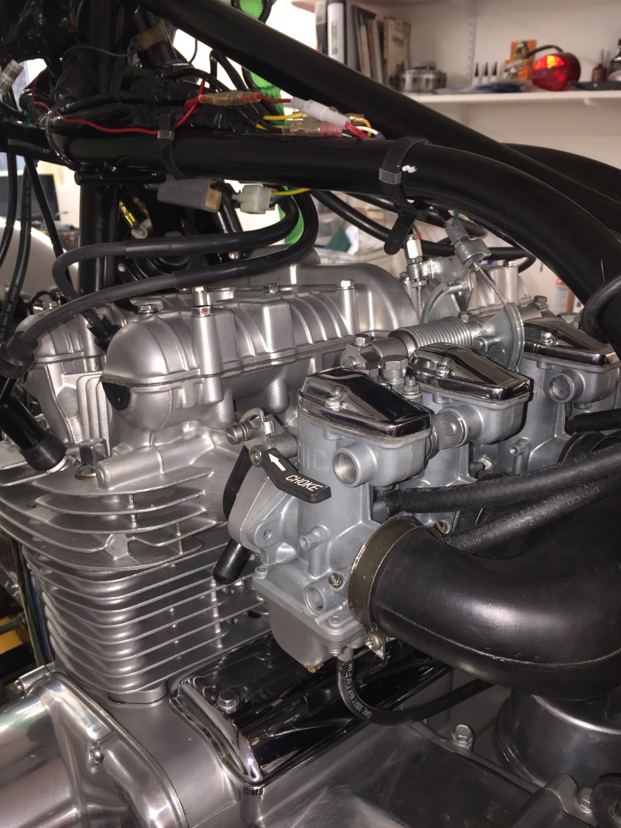

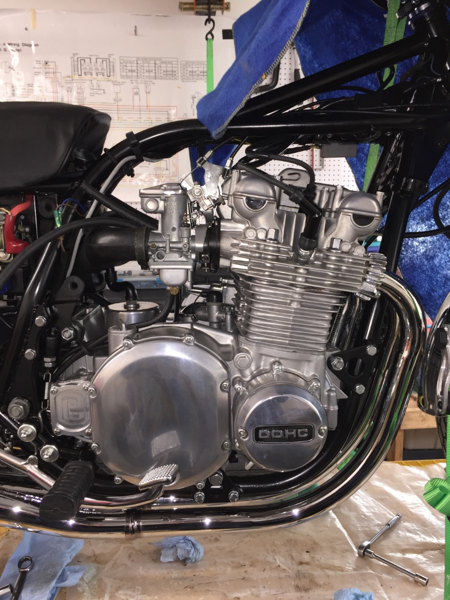

Re: Engine Cleaning
18 Jul 2019 13:46

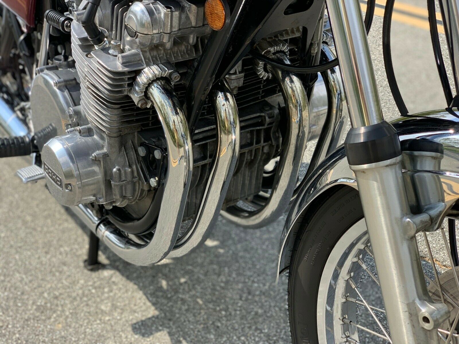

As requested here are two pictures of my engine. It isn't terribly dirty, but can definitely use some cleaning. The carbs have dulled down after all these years and I would like to spruce them up too. It was mentioned to use an ultrasonic cleaner on those, but what is the best cleaning solution for this? I guess I could go old school and use some Gunk engine cleaner on the motor and clean what I can with a high pressure power washer. I am somewhat confused on the Simple Green comments though.

18 Jul 2019 13:59
Your engine is far cleaner than mine was when I started cleaning it. I definitely would not use a liquid spray or other such cleaner on it. I would just use a bit of metal polish to bring up the shine. Ed
