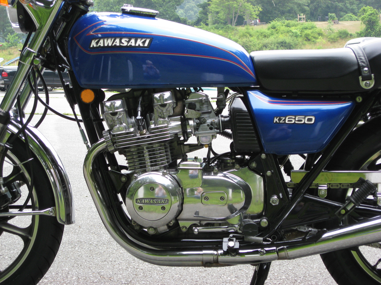

How much work to polish up this Kz650? As an auctioneer at a car auction I used to frequent used to say.. "knee deep in rubber, it only needs a little armorall on the seat" LOL
