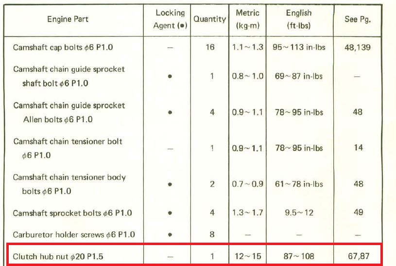

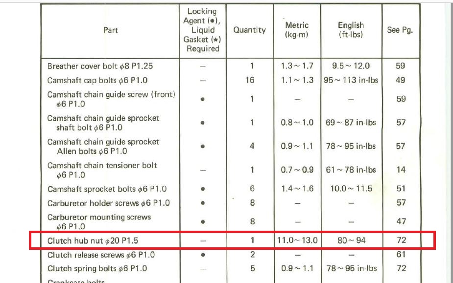

Neither the KZ1000 manual (1st image below) or the KZ650 manual (2nd image below) specify using a locking agent, but they both give a fairly hefty torque spec. I imagine that some folks do not torque the nut tight enough and it loosens up. Ed

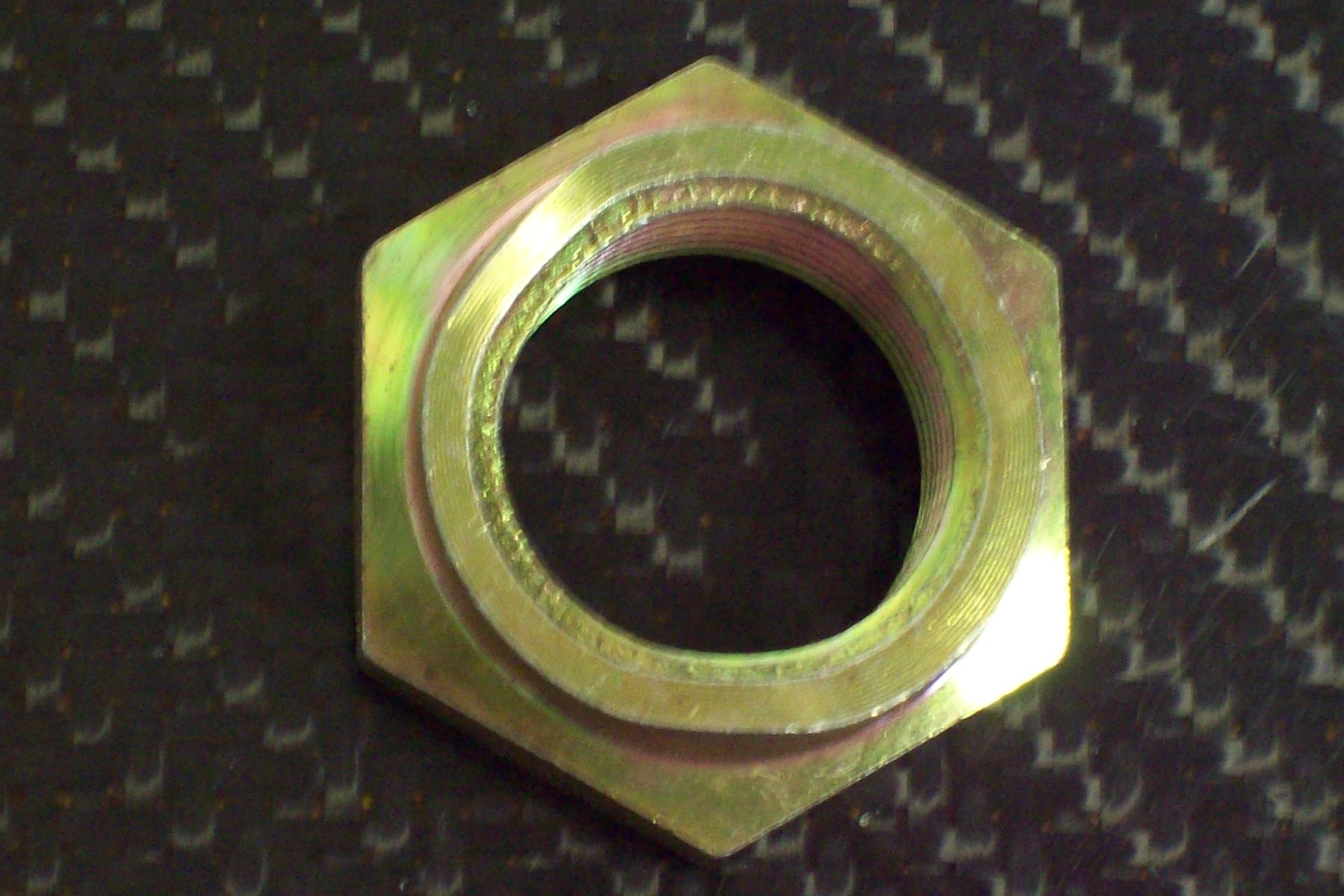

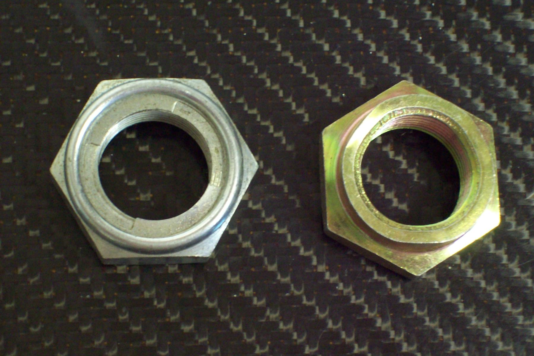

I checked my parts collection of Kz900/1000 clutch parts, and guess what I found out!!!!!
Kawasaki must have had a problem with the clutch nuts coming loose on the Kz900/1000 motors, and might have been under warranty too!!! Kawasaki changed the part number for the original nut style of 92019-015 to 92015-1555 which is a totally different style of locking nut!!!! Kawasaki would not have changed the style of nut unless there was some type of problem they tried to fix by changing to the new style nut. The silver nut on the left is the old style clutch nut. The gold nut on the right is the new style nut that Kawasaki now uses on all of the early Kz900/1000's. I don't know the name of the new style locking nut, but it does have more grip to lock onto the input shaft!!! I don't care what the shop manual reads, I would still use some Loctite on both style of locking nuts just to be safe. If the shop manual told you to rub some feces onto your clutch nut, would you do it????? I like to think for myself personally!!! I have always used a shop manual as a guide not something set in stone!!!
Old and new style of clutch nuts.
Close up look at the new style of clutch nut.
