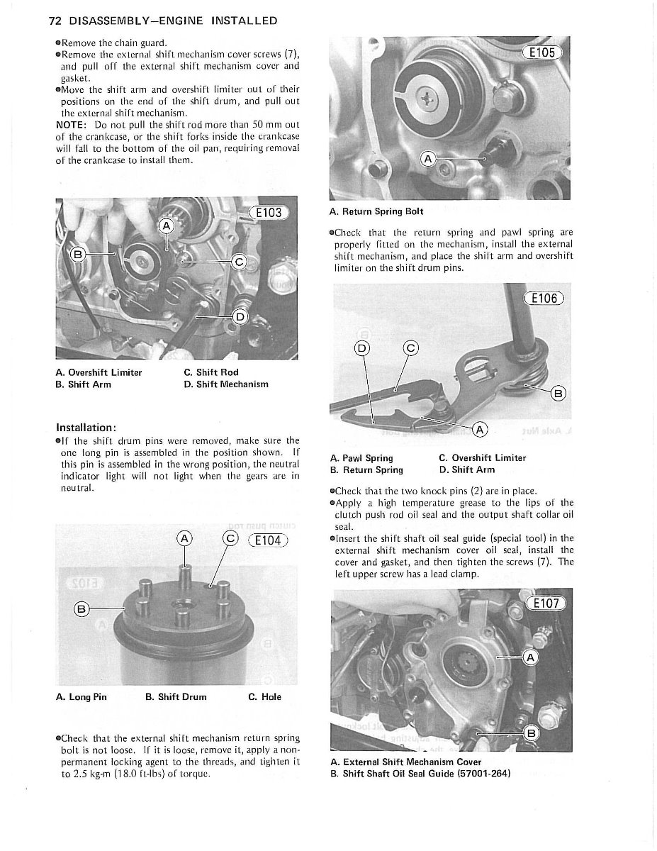

Sounds like a bend shift fork or weak shift mechanism.No kind of seafoam will cure you shift up/down Problem.
Remove the clutch release cover and take a look behind your front sproket cover.

I'm not sure if you are aware, but most Kz's have what is called a neutral finder, which makes it difficult/impossible to shift into second while the bike is not moving. Once moving, it should normally shift into second. This mechanism relies on some moving parts which may get gummed up. Maybe an oil change and some running around in first gear will get it working.
If not, then look into what Scirocco is saying about the shifter mechanism.
Also a gummed clutch or rusty clutch might cause the difficult shifiting, though it doesn't usually cause the second gear lockout problem.

A broken shift return spring will cause that.

The transmissions on the Kz550 family are very reliable. It's almost unheard of for them to fail in any way unless someone does something to "help" it. It's more likely a shifter issue or clutch issue. I see the clutch adjuster cover missing... so that looks suspicious .
