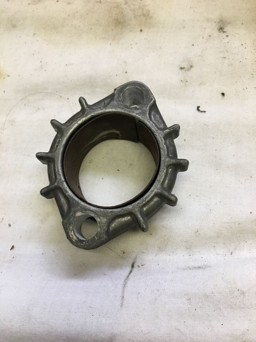

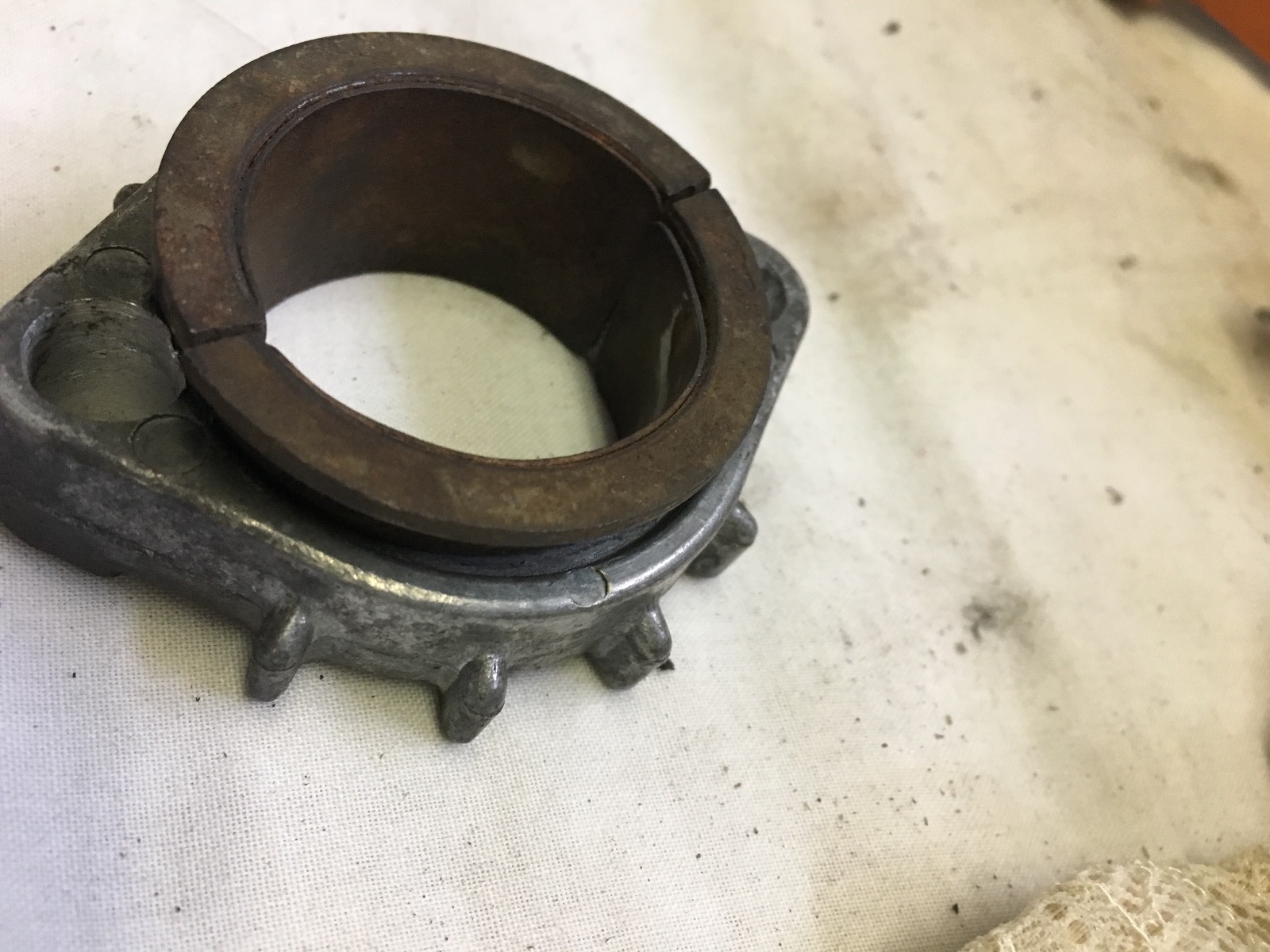

Haha... I feel like an idiot.
I thought the split collar recessed inside the clamp. I’ll try again after coffee.
Though it looks like the collars and clamps may be incompatible.

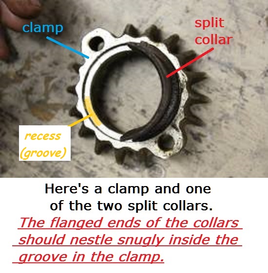

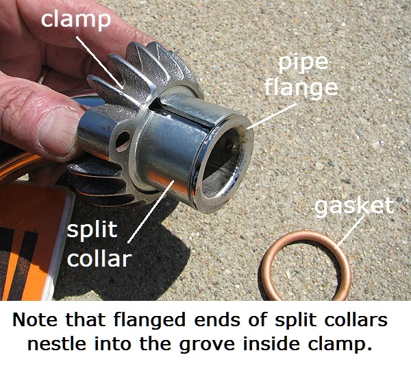

They do and the ones shown don't look like they'll fit in the grooves. You could grind them so the lips will fit as long as there's still a little space between them. Another thing to look for is where they mate up with the flanges.
