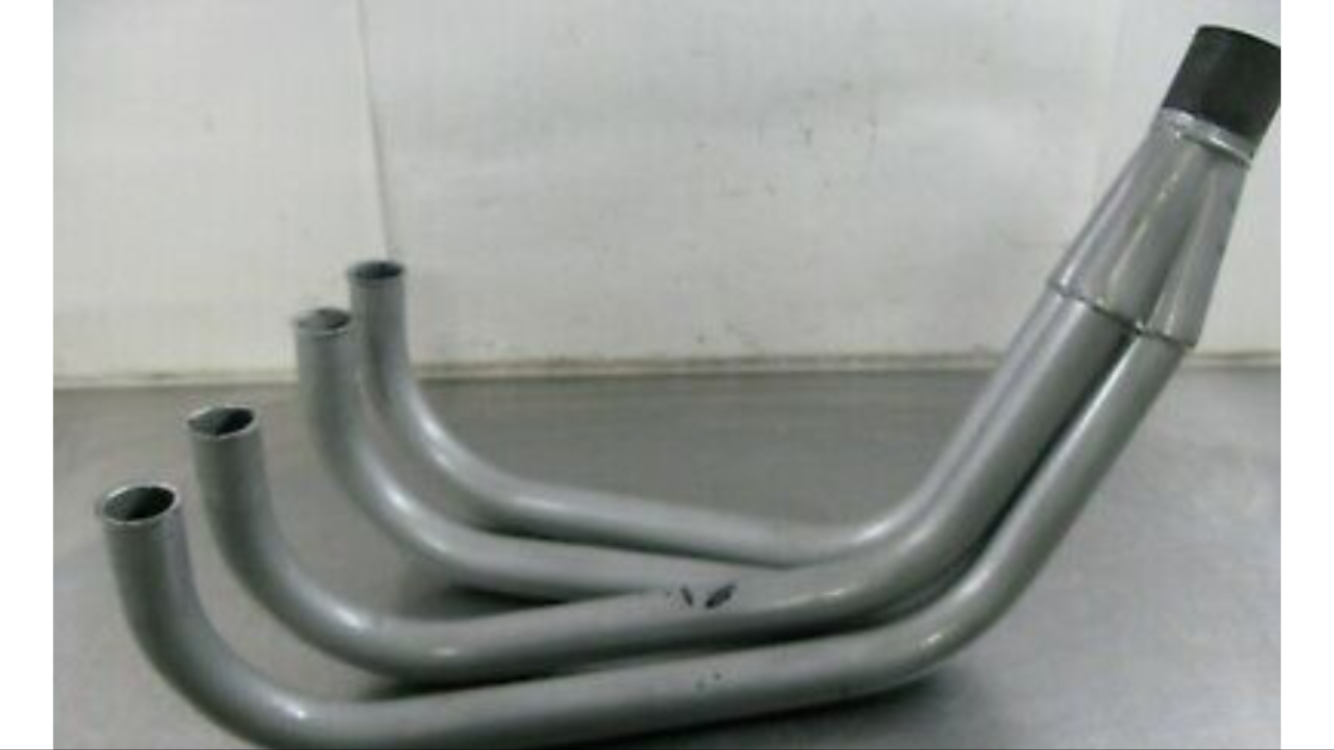

I’ve been trying to piece together a project 1984 GPZ750.
Having a hell of a time with the exhaust.
I bought what I think is a V&H header and centre pipe, I believe from a older KZ.
It utilizes the collar and half-round pieces, but it doesn’t seem these work with my engine.
I’m ready to buy a new exhaust, I’d be half way there with the $ I have into this other stuff.
I don’t want to throw away more money before getting more info.
Thanks for reading and any suggestions.

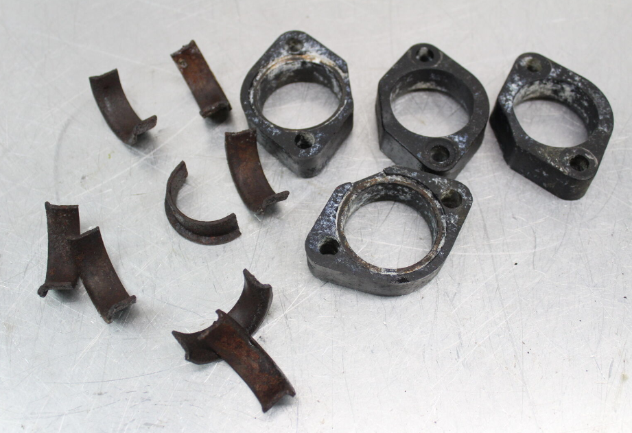

I have the centre pipe, but am having a hell of a time figuring how to couple the header to the engine. I ordered some collars for an older 750 but they don’t work.

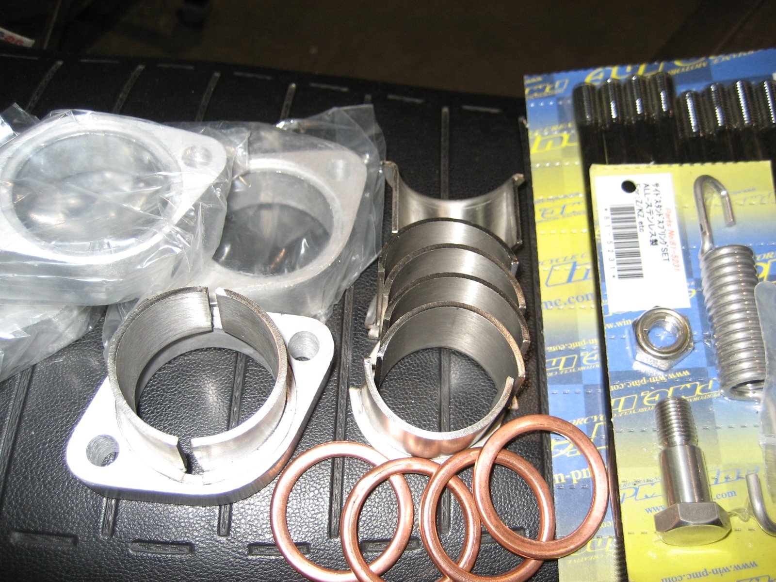

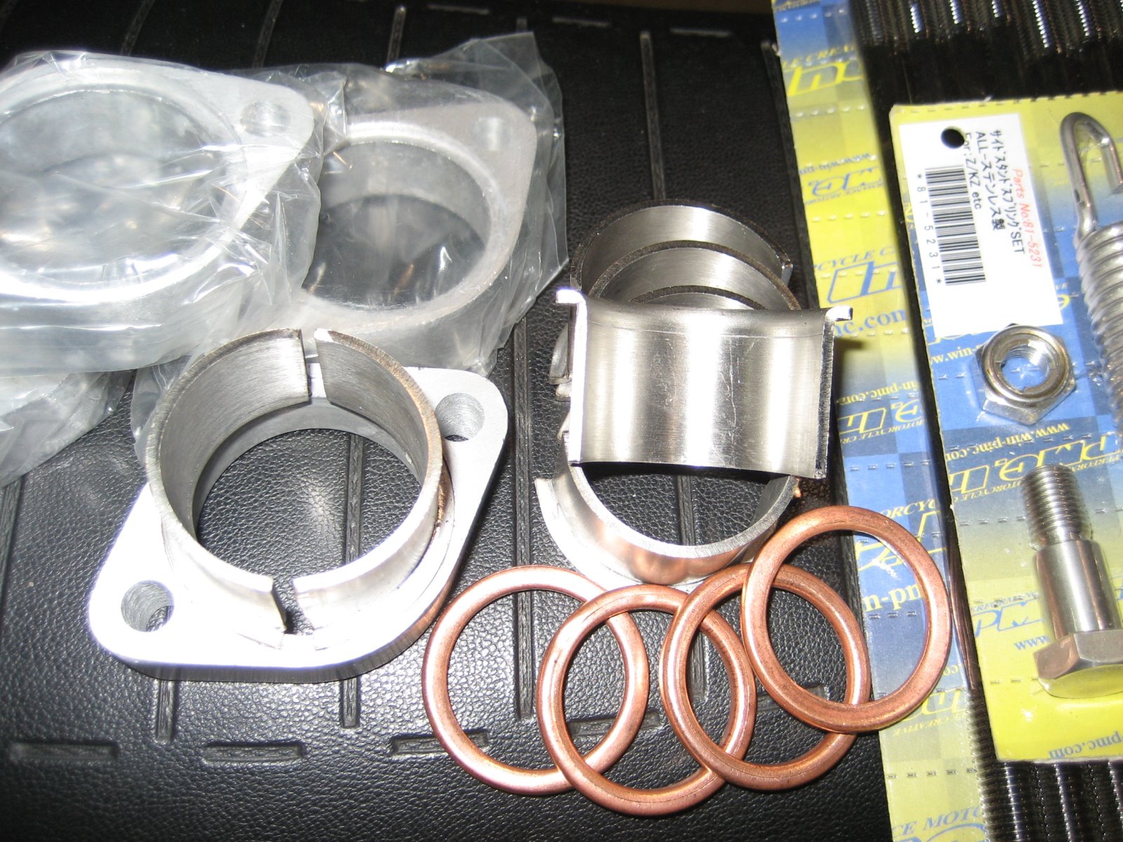

Maybe you need longer half split collas, my collas were made from stainless steel
[ attachment=124730]IMG_2487.JPG[/attachment]
Yours look like late shorter GPZ half split collas like Nessim

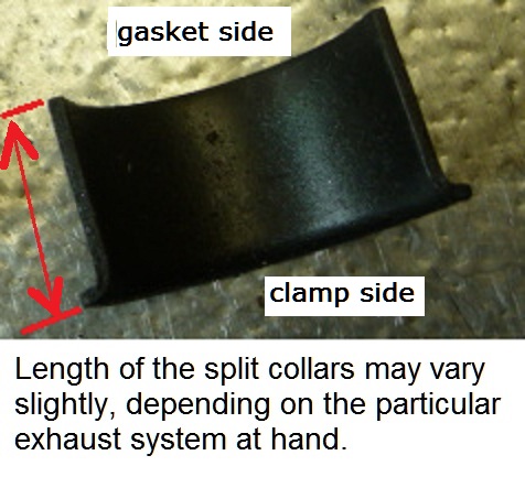

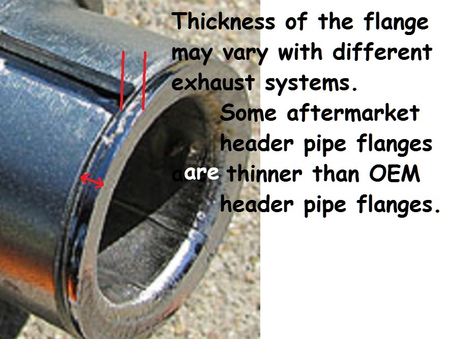

Am presupposing that the pipe flanges align with the exhaust ports, but that the pipes won't tighten into position because the split collars at hand are either too wide or too narrow.
Is there some other fitment issue besides width of the split collars?
Correct split collar width will properly compress the gasket just as the clamp meets the head when tightening the nuts onto the studs.
