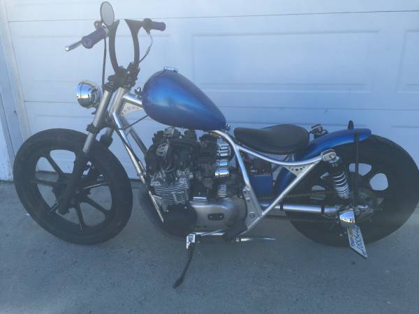

Ok...symantics....not a gear indicator, but a neutral light. There was no instrumentation whatsoever when I got it. The clutch cable & the brake cables were hanging loose, attached to nothing (levers were missing), the shifter was an arm. Hey, it was free so....

Re: After market gear indicator .
29 May 2019 06:03
That's what I'm trying to figure out how to do. There wasn't a wiring harness, so I have no idea where it would connect up.

The neutral switch is pretty simple. See reply by loudhvx above.
>> 12V power wire to neutral light >> another wire from neutral light to neutral switch >> that's it.
>> the neutral switch completes the circuit to ground to turn on the light. pretty simple.
Usually, the stock wire harness has kind of a flag terminal for the neutral switch (see pic). not sure how easily one of those terminals with cover can be sourced that fits the neutral switch. I would use the same color wire as in the wiring diagram.
KZ650 wire harness >> note flag terminal. The 440 neutral switch terminal is probably the same.
For the harness below, there would be another wire from the male bullet terminal (green wire) to the neutral light.

Your explanation is great, however I do not have a neutral light and I have no clue if I have a neutral switch. When I got it, it had no instrumentation, no wiring. Currently I have a few wires hooked up. Turn the key on, head light (no high beam); brake light, turn signals. The turn signals are toggle switches from Radio Shack. I have looked in the service manual, but I'm not finding what I need.

The neutral switch on your motorcycle is probably still there. On the 650 it's near the Fr drive sprocket & usually covered in grunge from the drive chain. Does your speedometer have any unused warning lights or indicator lights? Some aftermarket speedos have a slew of them built in. If yours doesn't have any, then I would get a different speedo that does. I saw several at dimecitycycles.
Or you could install a motorcycle neutral light. listed on EB & dimecitycycles.
EB item # 392119319098 .... I don't know if this one is waterproof.
