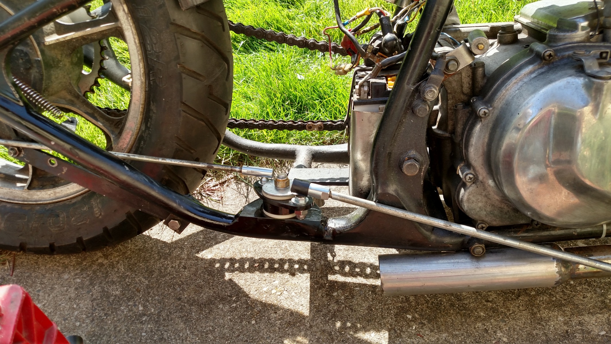

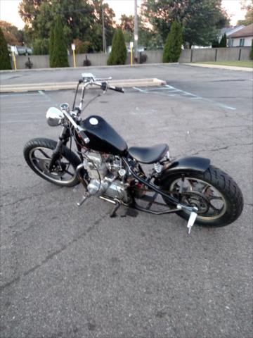

Yes, the neutral indicator. It was already gone when I got the bike - lots of things were gone......lol I will check out the link you sent . Here are a few. The second is my brake setup-rods & bell crank. Never replace a brake cable again!
The stock bike never had a brake cable, so where is the improvement???
A push/pull suicide rear brake mechanism!?!? No way,to many parts to fail.
A rear brake cable would be a better life insurance.

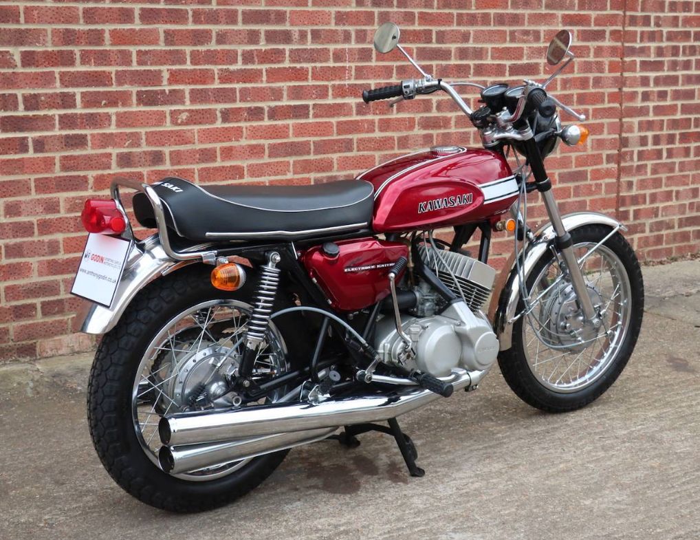

13 May 2019 21:43 - 13 May 2019 21:57Wow, I'm kinda impressed. That bike looks ride-able, unlike the POS that I posted a pic of. Not over powered for sure.
Those links I posted have a bunch of indicator lights that can be wired into the stock neutral indicator light switch. Like my friend loudhvx stated, the neutral switch grounds the circuit, so you would hook the other side of a indicator light to any switched B+ source. (earths the circuit for yall ferigners.
I did see a few cheap gear indicators, but you need a electronic RPM and Speed signal, and your bike doesn't have either. They could be added, but not worth the hassle.
Scirocco is correct, a cable is more dependable than brake linkage. Fast bikes (and cars) need good brakes, although the front does ~70% of the braking. The Kz 440 is more of a starter bike as is the honda rebel. Not a real big powerhouse, so it's not going to get you into too much trouble if the rear brake linkage fails.
My bike on the other hand is like a caged animal. (or is that ME?) Things can get downright scary at times, even WITH awesome brakes..
Attachment not found

This one did have a stock brake cable. As far as push/pull, it's just push. There is a spring to return it. Parts to fail? 2 rods, a bell crank and a spring. It works great.
It's a lot of fun, and no there is not a lot of power, but it is a good city hopper. (I'd say bar-hopper, but I don't drink & ride).
