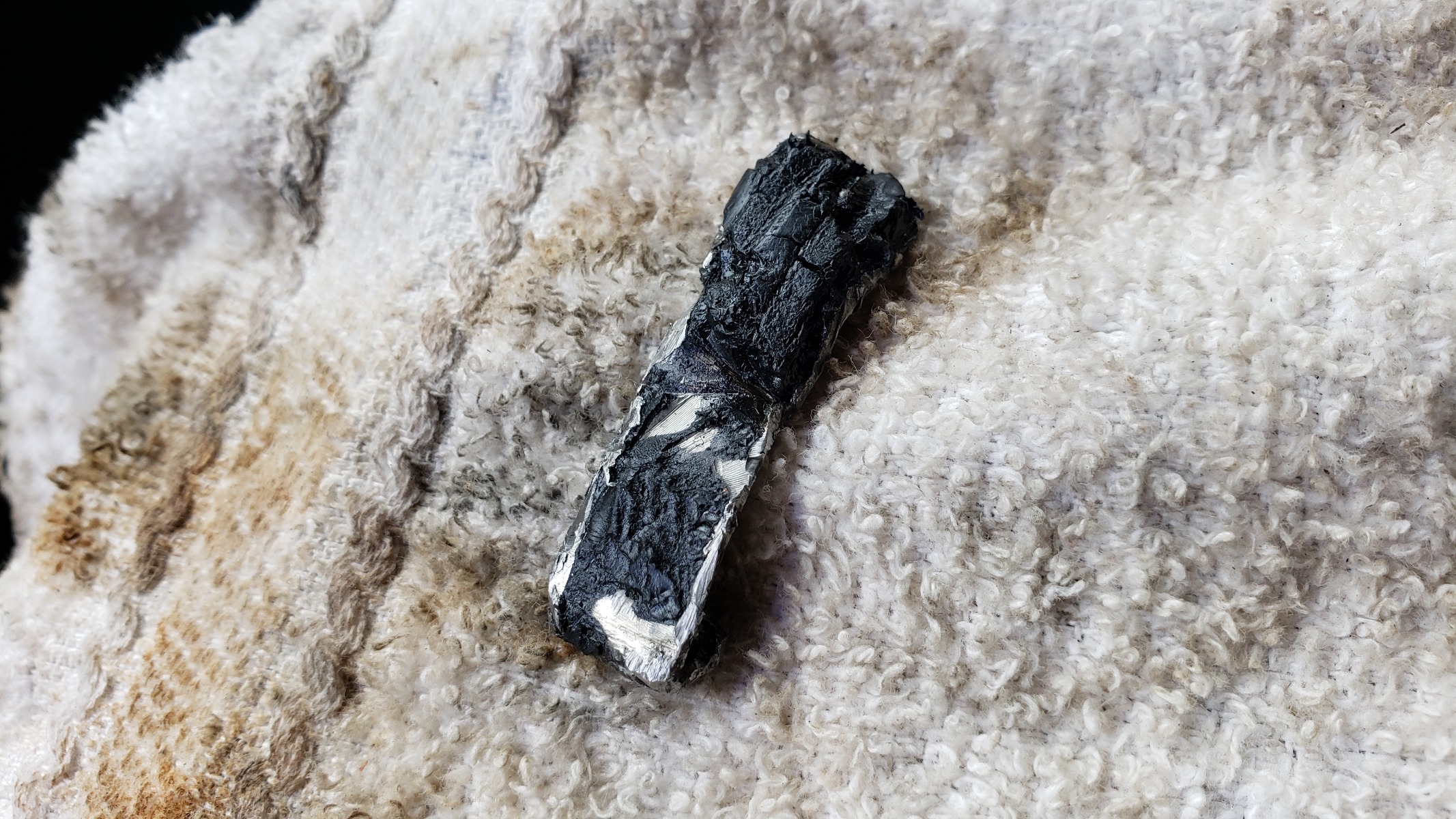

Hi guys I'm Vince and I could use your help on replacing cam chain guides ... I cant find any vids or post on the procedure... do i remove head and block ?
I've attached a pic of what I'm believe to be part of a guide... engine runs great no noise but I dropped the bottom pan anyway to clean sludge and found that piece in the pic

More than likely yes. But I don't see the pic of the part you found?

The part you found in the pan may be an old front guide that has been there since the PO fitted a replacement which may expain the lack of unwanted noise which is usually a rattle as the chain slaps the cylinder ( also acompanied by alloy particles in the oil ) .
It's worth pulling the cams so you can see if there is a guide still in place before pulling the head for no reason.

I cant imagine someone pulling the cams , head and barrels and not dropping the pan to remove the leftovers lol . But I suppose there's someone out there that dumb lol

03 May 2019 09:25I've rebuilt engines where people have done some pretty stupid shit so in my experience there are lots of those idiots out there and I always seem to get their engines.Vincent J wrote: I cant imagine someone pulling the cams , head and barrels and not dropping the pan to remove the leftovers lol . But I suppose there's someone out there that dumb lol

Vincent J that photo reminds me of a local friend and his 74 Z900! He rode his around for YEARS until one day he was having 1st gear hook-up issues, would feel as though it was jumping in and out of first. Then he thought it was the clutch slipping. I ended-up dropping the oil pan for him to have a look-see. Exactly like the item you show in photo, except his piece had finally jumped-up into the gear cluster and destroyed the matching first gear teeth, well I few of them at least. Like mentioned someone in the past had torn-down the upper end and replaced the small chain guide but never bothered to find the broken bits from the old one. I Always replace these when redoing an upper end! Even though they "may" look intact more often than not the rubber is getting weak. Remember this is Not a solid metal bracket coated in rubber. The section that is sandwiched between cylinder and case is All rubber up to about 1/3 the way up, when mounted. This allows for built-in flex but Non-maintenance/General fatigue/Age and You have a failure just waiting to happen
