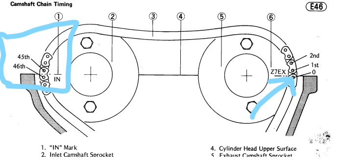

I also have another question, Since I forgot to position cylinders 1 and 4 at TDC, how do I align the cams correctly? When I align the exhaust cam with marks according the service manual, one of the valves seems more open. And when I start tightening the cam bolts, the mark slightly moves.

Did you count the pins on the cam chain mark to mark starting with the next pin up? Cam chain tensioner installed?

Yes, I counted exactly according to the book. While aligning the camshafts I removed the chain tensioner completely. After bolting the all the bolts I re installed the chain tensioner. And i also removed the locking bolt in the chain tensioner while it was removed from the engine
I am able to align the Z7EX mark with the cylinder head. However I can't say the same for IN mark.
Should I first set up the exhaust camshaft, bolt down the bolts and then work on the inlet side? I have a feeling I am missing something?
-Yuriy
-Yuriy

The cams look to be off one tooth. Try rotating the crank two turns and stop at 1-4 T and then look at the cams again. Install the cam chain tensioner spring/wedge before turning the engine over of course.

Nessim,
I see the problem now, When I'll get home I'll work on the motor and I'll let you guys know of any more questions I have. Don't worry I sure will have more questions.
A big Thanks!!
