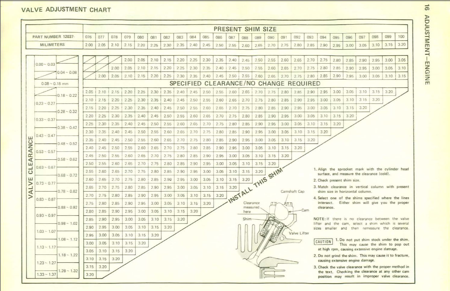

All valves buckets move freely and all clearances are up to spec.

@baldy110 I really tried not to force anything but at this point it could be a sad reality. Next step to check if I did would be what? All valve clearances show correct clearance.
