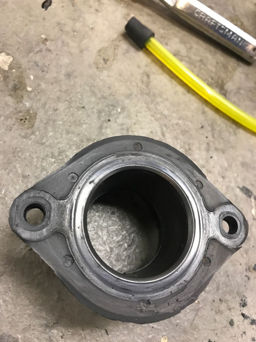

Putting my 750 back together for the season and have tracked down a leak between the carb holders and cylinder head while tuning. I know it's best to replace but mine are unobtainium part number 16065-1046. Took me a year to find NOS intake ducts but no luck on these whatsoever. Any suggestions on what I can use to seal these up to the cylinder head? I removed them without an issue when I redid the head and they are in good shape but hardened on the head side therefore causing them to leak when installed and torqued dry. I searched but got varying answers on it.

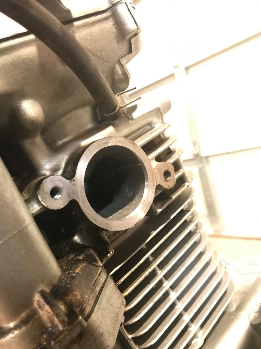

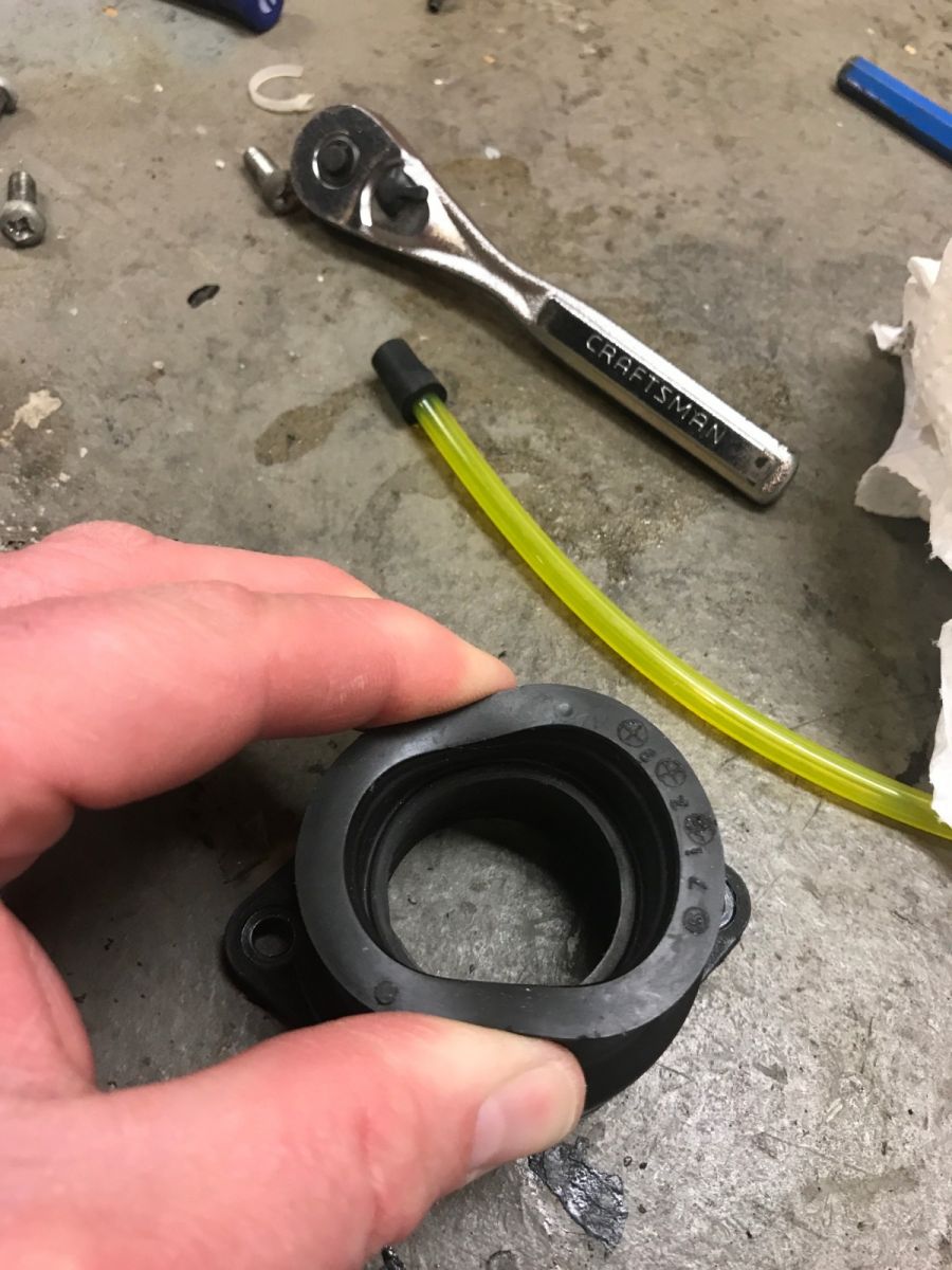

Pics below, as you can see the carb end is in good shape and pliable. Back side is a little flat and hard, hoping I can get by with a little bead of something and put these back to use.

z1kzonly is right, Blue Hylomar is the best. Your rubber boots have enough rubber thickness for a resurface.
You can renew/flatten the rubber boot surface with a light wet sanding on a glass plate. Use 400 - 600 grit.

Scirocco wrote: Your rubber boots have enough rubber thickness for a resurface.
I was curious about sanding them a bit but was a little concerned with the scarcity of them.
