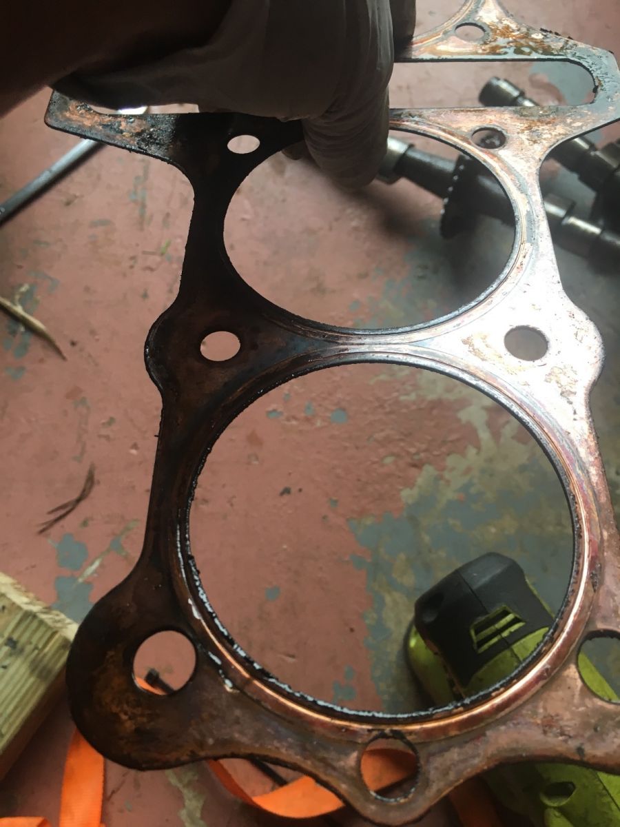

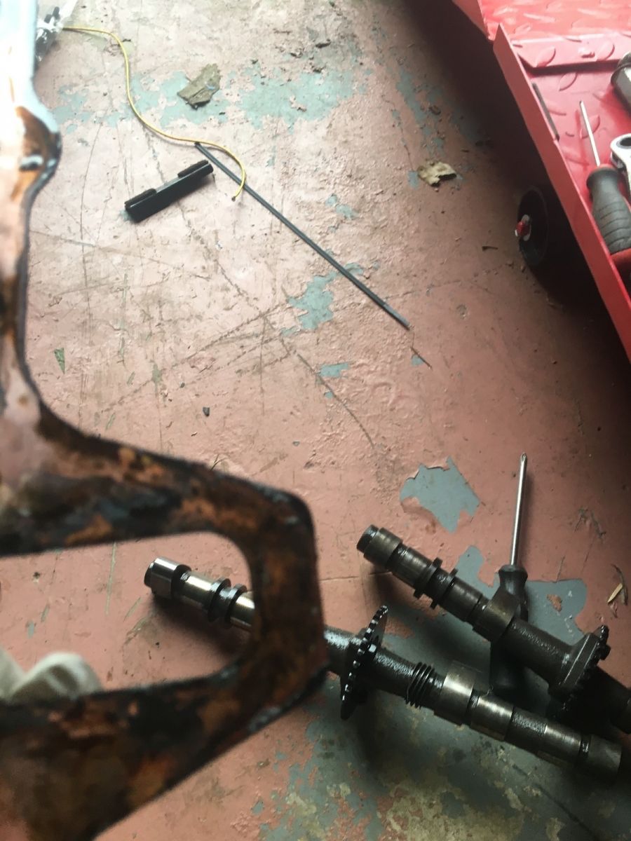

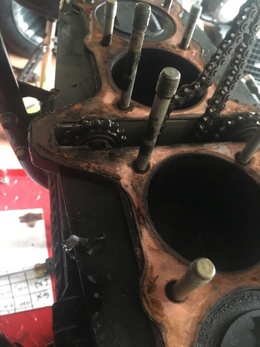

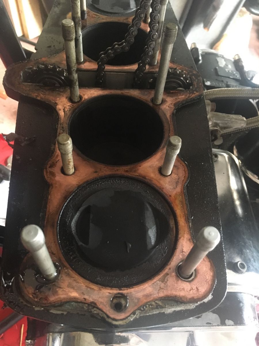

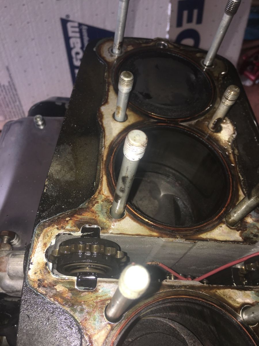

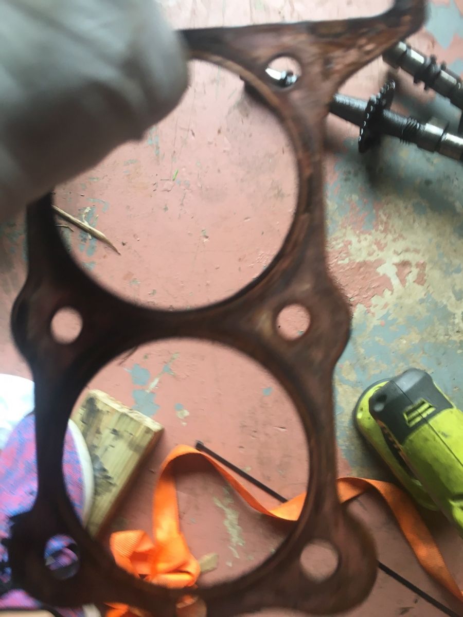

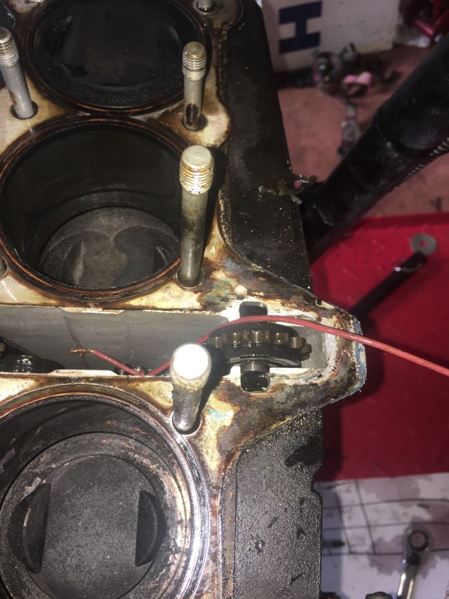

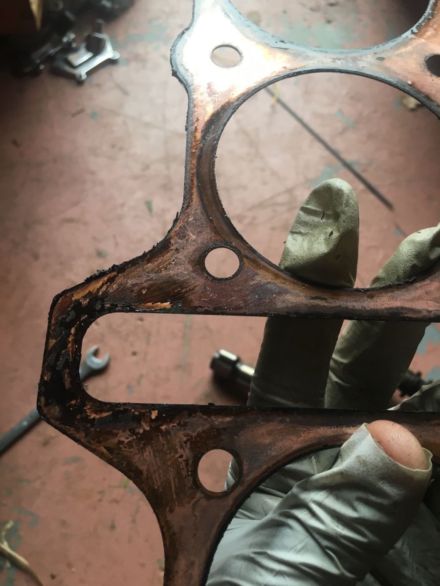

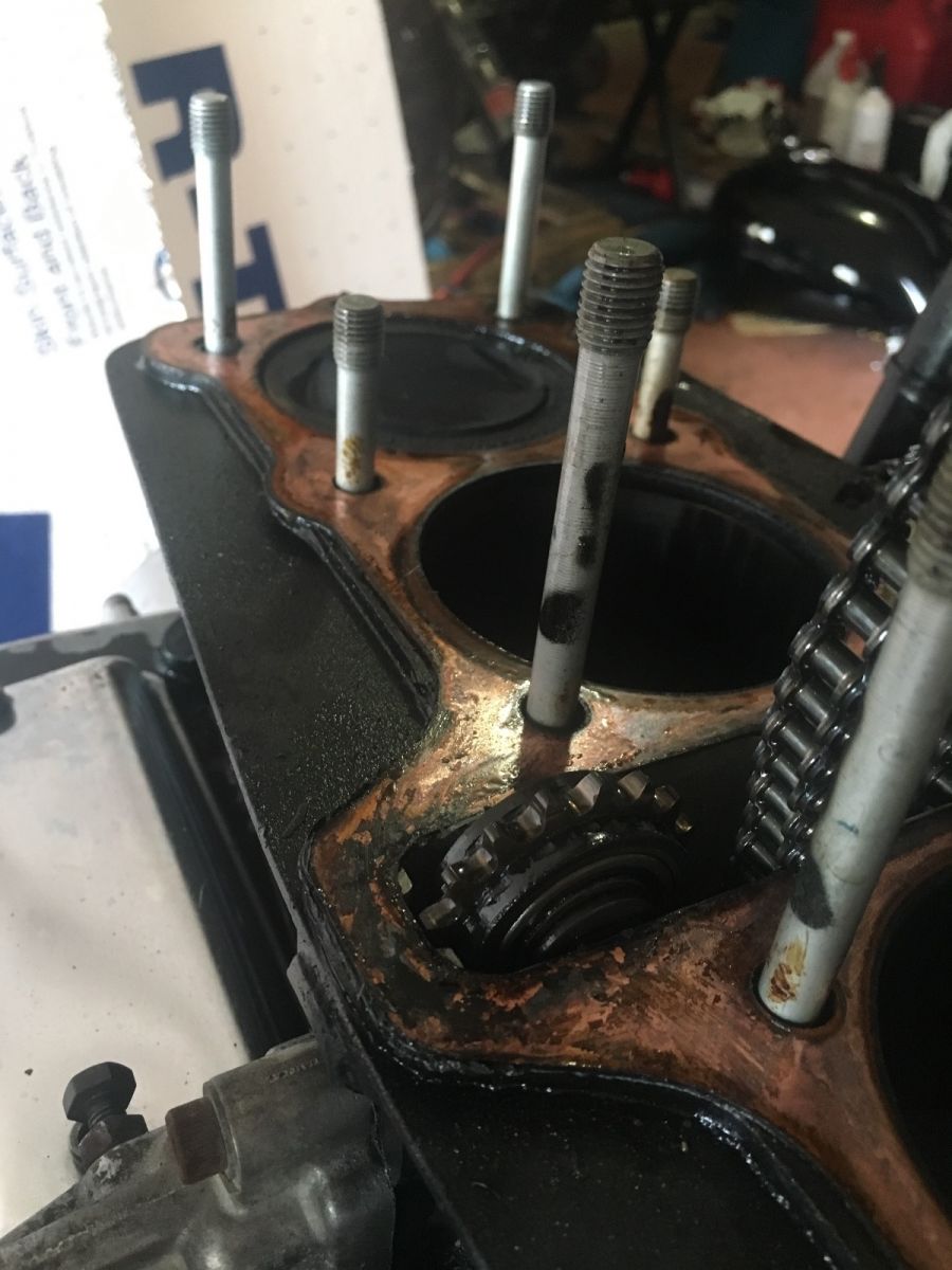

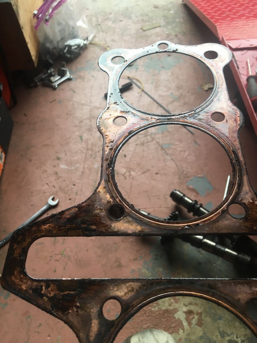

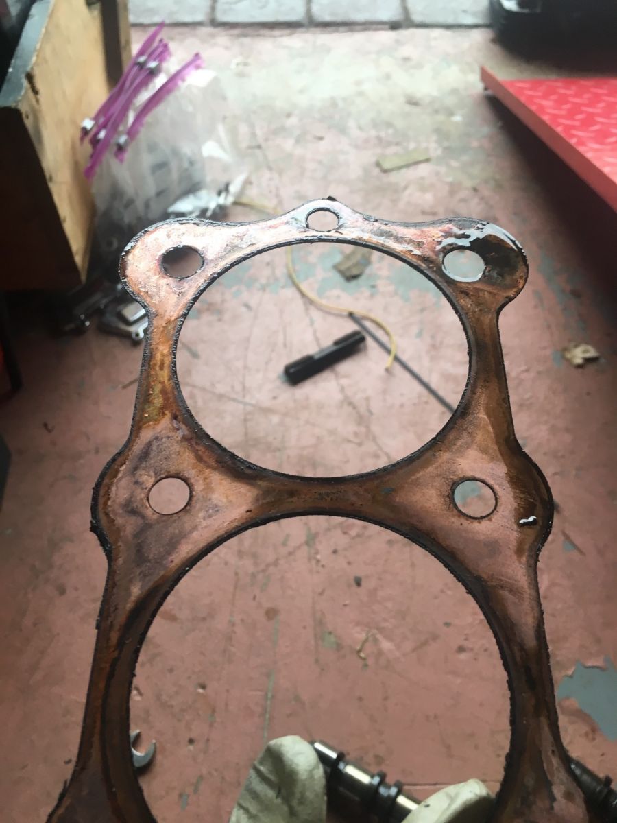

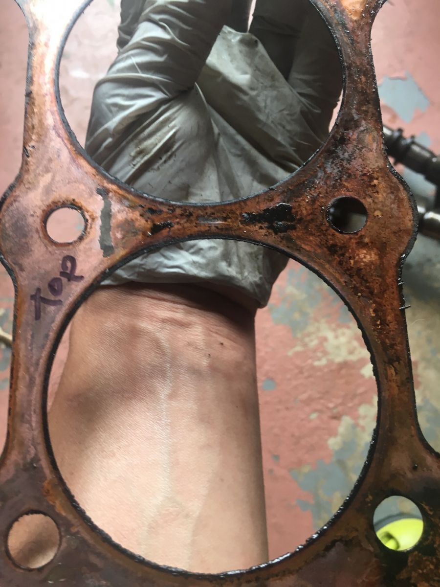

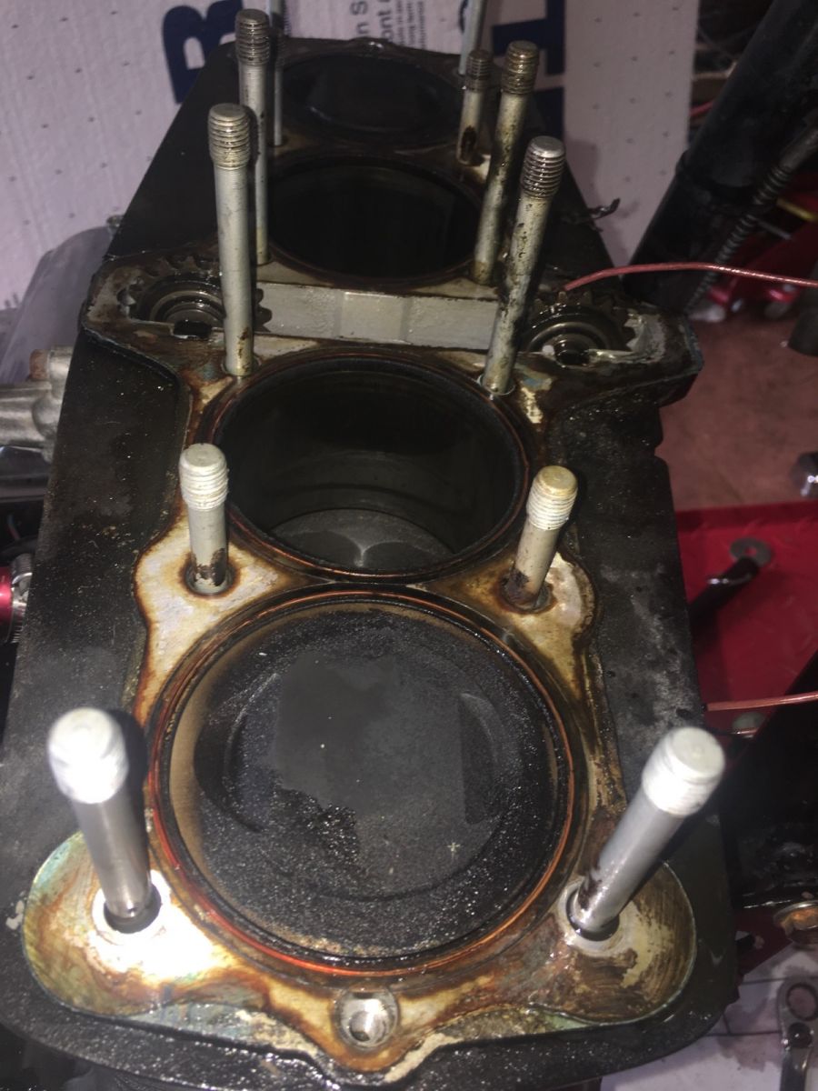

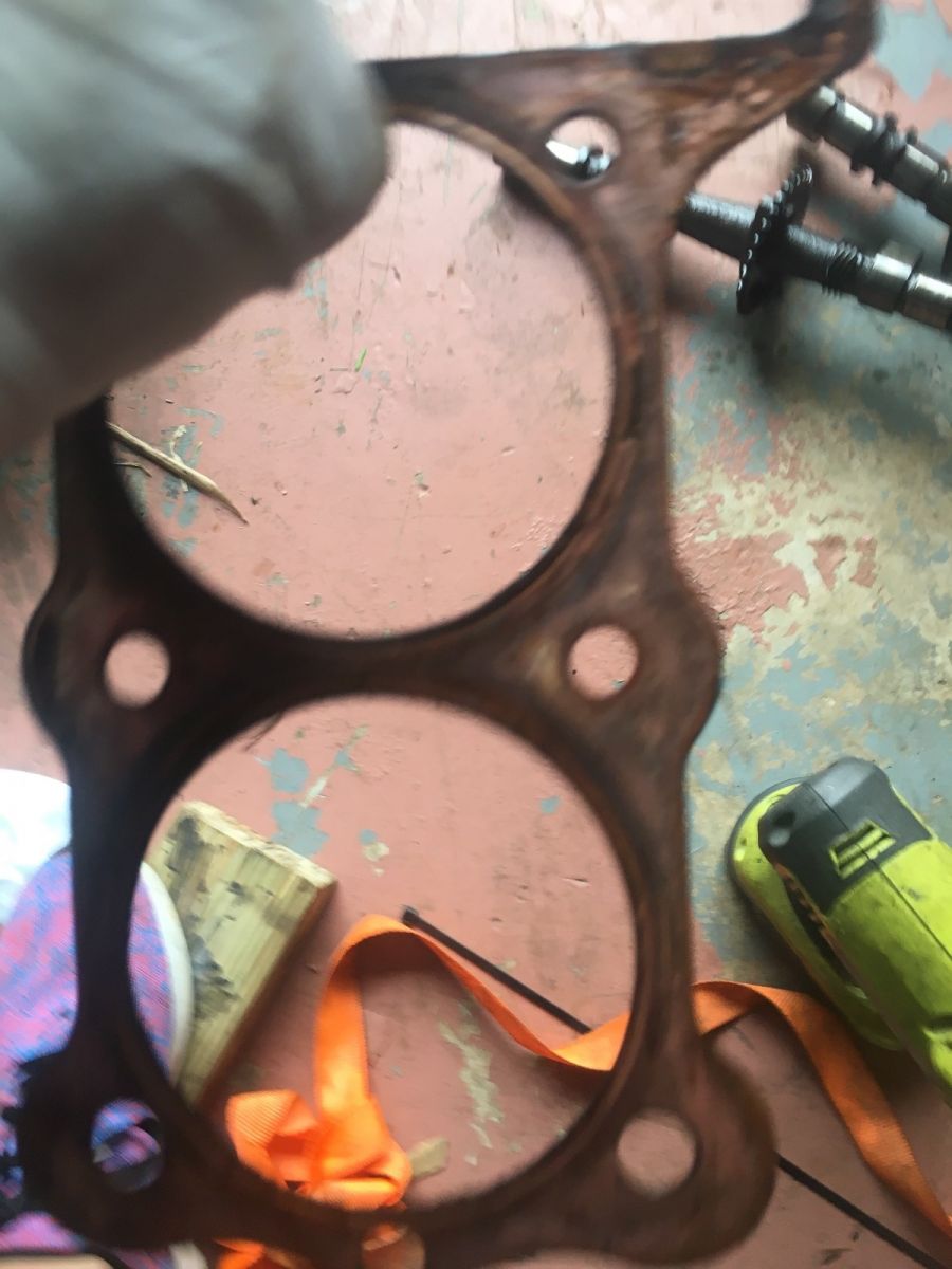

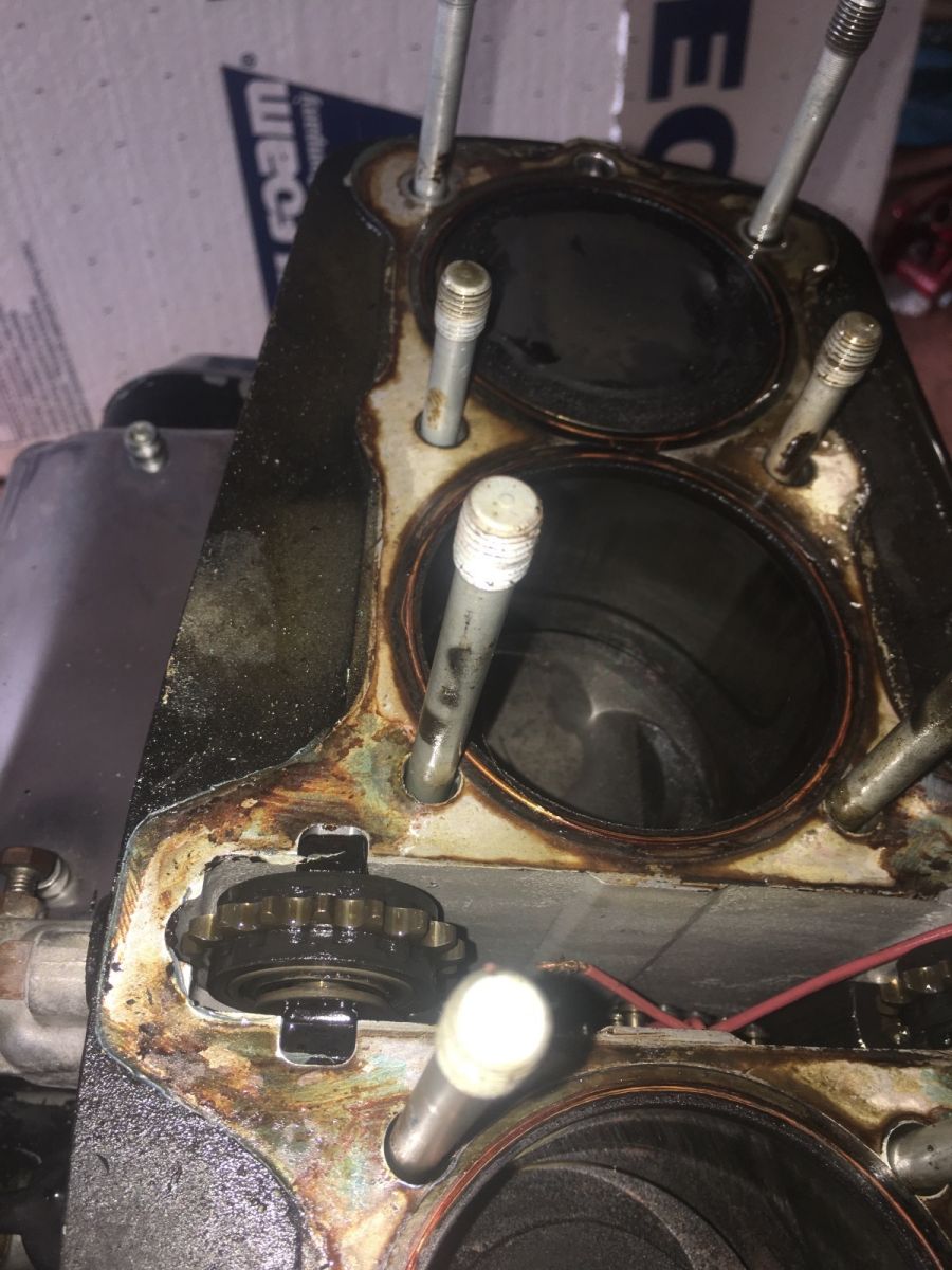

Hello
I just opened the engine and pull the head out. came out fairly easy once I removed all the cam and the head nut used a piece of wood and taped sideways the head and pulled out nicely. button between the cylinders and head was very messy.
it has a copper head gasket seem like the wiseco style, no Ring in the cam chain oil pasage and I don't know if it is suppose to be like that.
The Cylinder bore is apron 82 mm with translate if I am not wrong to 1395. Low compression piston I guess 10.5 to one if I am not wrong. the cylinders show no sea nand the pistons are tight. I was not expecting anything different.
I am going to be taking measurement and notes in regarding of the thickness of the gasket and diameter of the installed gaskets as well.
I also already measured the gap in valves so I can now measure lobe the camshafts and the printing not them to see if it can be figured out the right shim clearance.
I have not pilled the cylinders out yet since I have to remove the glue I did put bellow the cylinder jugs where it cracked when they did the case boring.
I am uploading the pics while I keep working so if you do suggestions I can follow while I am working on this.
Thanks
Thanks
I grew up riding and fixing all sort of small bike until I inherited A 1977 GS 750 when I was 16, that changed my life completely I love metric bike and I own a few fully working and have some projects.

Number 1 I fixed your pictures so we can see them. PLEASE hit the insert button before hitting submit so your pictures can be seen properly
Next That copper head gasket can be reused. Dont bend it up ,, keep it flat as possible. Clean it with scotch brite and then anneal it in a oven and quench it in water. . Then reclean it
and reuse it. Next clean all surfaces. During reassemble the o ring at the cam tunnel shoould be filled with Yamabond and allowed to set up before putting head and gasket back on . Use yamabond at all 4 outside cylinder studs to seal oil galleries . Be careful not to use to much and clog the oil flow. .
If I were you I would e mail and look up Joe Hooper at Pitstop performance in Florida. He has a complete set of needed steps published that are a step by step
guide to proper motor services. My words above are just a partial list of needed things to do to seal up that big motor.

Be sure the head and barrels are flat. Looks like they're not.

Took another look at your pictures. Funny I didnt look closer before.
With those huge sleeves you cant run a center o ring as the over bore removes the groove at the cam chain tunnel .
Not sure if groove was welded up or contains RTV. Also the motor has stock studs in it . I would use APE heavy duty studs and nuts
Poor choice to go to 1400 cc in street motor in stock block
Not for the weak at heart, More to follow.................
