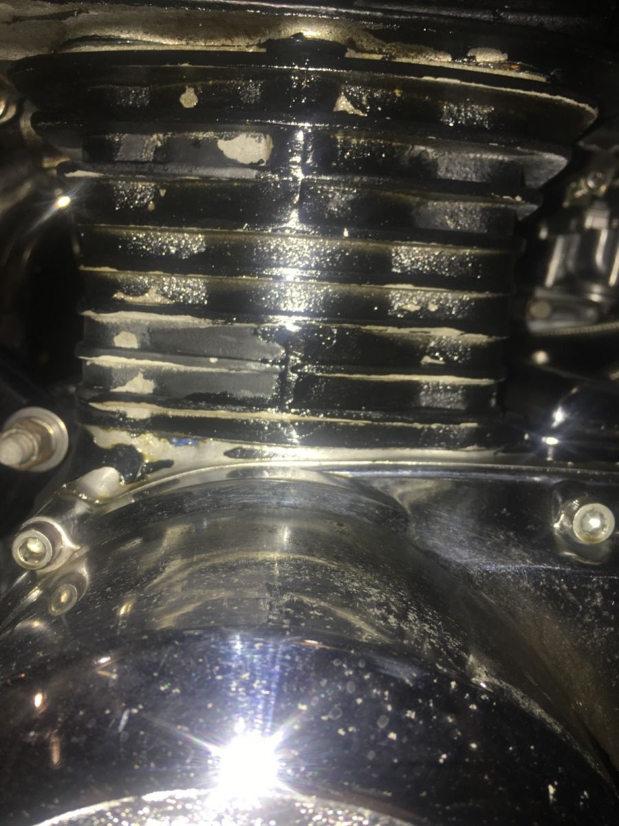

my 79 kz ltd 1400 block for a while I noticed a little oil brilliance after using on the cylinder on the right side nothing mayor but I specially notice after cleaning the whole engine with degreaser and going for a ride I an pretty sure don't come from the valve cover and now the left side is leaking and I am pretty sure is the head gasket any suggestions?
should I try to re torque the head?
worst I guess will have to open the engine and measure the bores and thickness of the gasket in order to replace it.

Check to see if leaks are coming out from the 4 outside corner head nuts . If so may want new copper washers before re torque

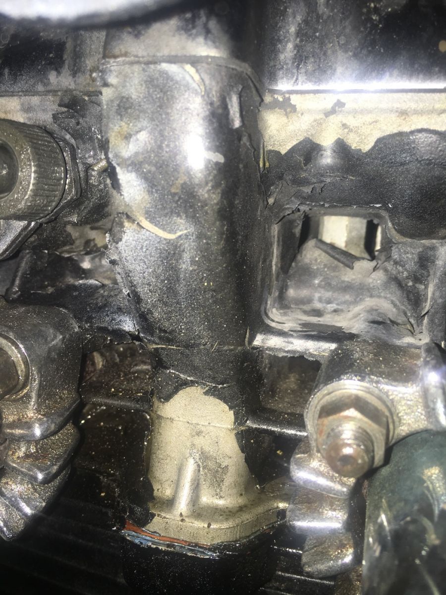

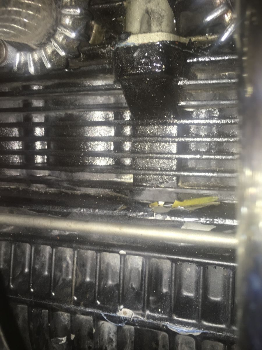

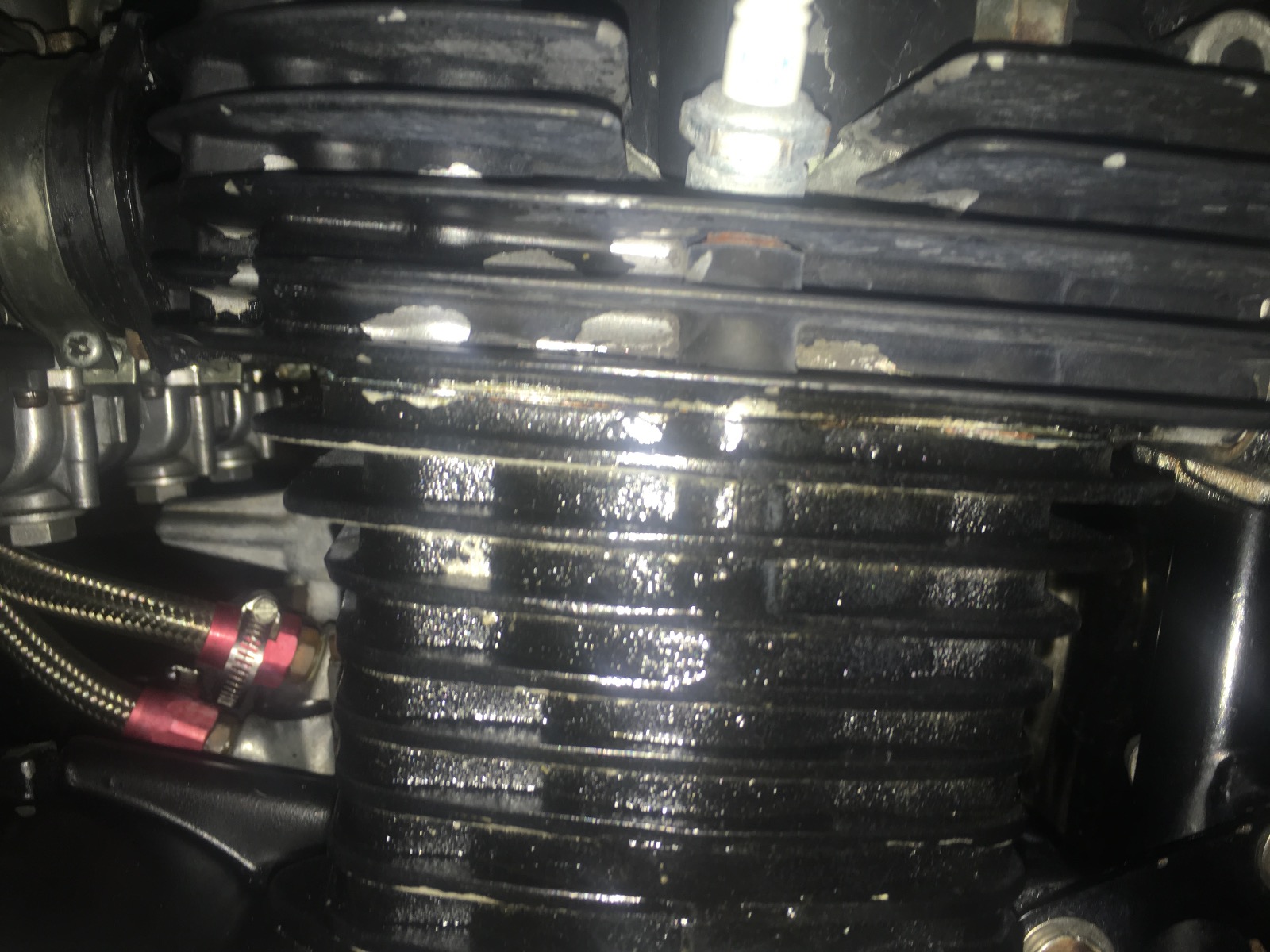

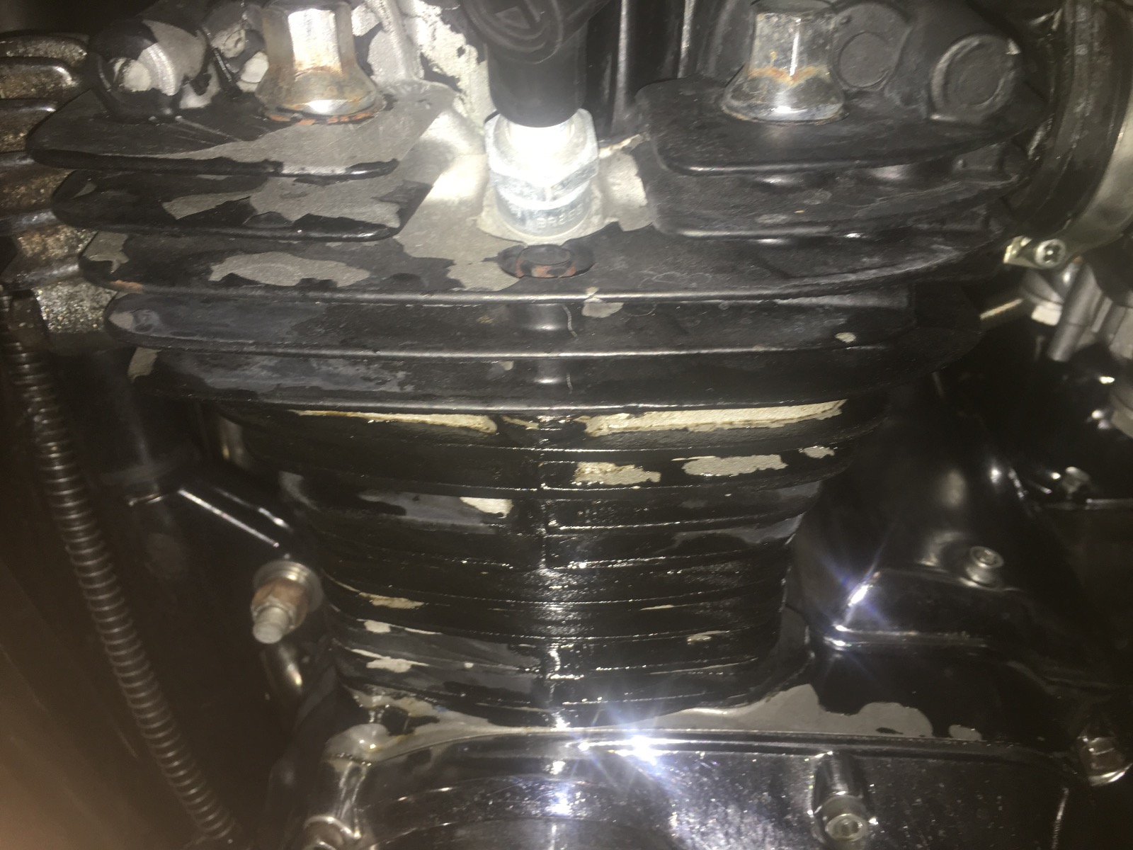

Seems like coming from the middle. not really from the side studs the head gasket installed looks like copper one.
I have to open the valve cover to do a valve adjustment and its seems under bucket so I will have to remove the cams and and I am planing to fit a manual tensioner.
So if new head gasket or the Ring have to be replaced would be the time to do it unless any suggestion from you guys help me to stop it.

Looks like copper RTV. Copper head gaskets are notorious for weeping. That looks like a fibre one. Might try to retorque but if you can it would be better to take off the head and redo the gaskets.

In between the cylinders there is no oil passage, hence no oil pressure to leak. (Except the cam chain galley) It is likely coming from the left and right outermost studs and more than likely blowing / seeping over to in between the slugs.
