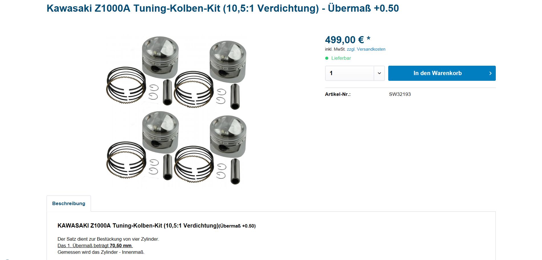

Ok thank you guys, then i will do an upgrade with this high compression piston kit with 70,50 mm bore size.

As one who has probably done more of these than anyone else, I can say the 1105 will fit and we do it for people who absolutely insist. However it is my opinion that a 1075 motor will make more power because the liners will stay round and provide ring seal. We still do a large number of 1075s. I believe the 70.5 mm kit the other poster is going to use would not be worth it when he could get an extra 50cc for the same money.
