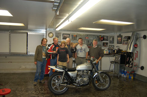

Colin Firth AKA reborn650 in Sudbury Ontario did a 650 to 750 to 810 back in late 2006 early 2007 Search here for the many threads he posted within that time frame. No single project thread
Here's one where he describes using 750 sleeves (which he later rebored to 810) in a 650 block.
www.kzrider.com/forum/2-engine/132331-75...ers-650-cases#132396
Beautiful bike which I got to see one Summer evening in Colin's workshop together with a small group of of local KZ enthusiasts and KZR members
