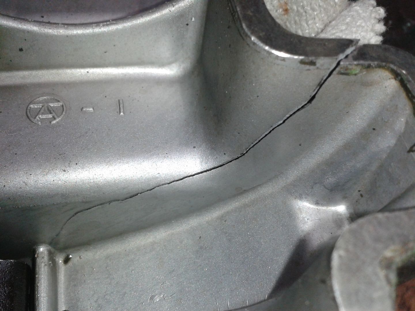

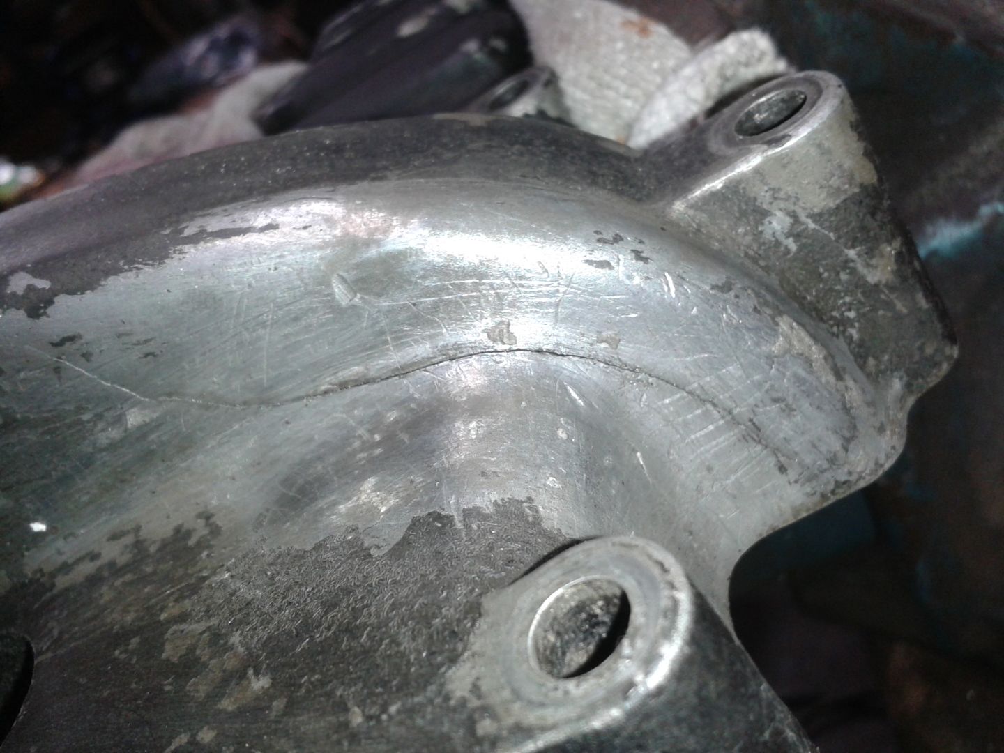

Re: Kz750-Gpz750 top end interchangeable?
16 Feb 2019 13:59
#798783
I am total with Nessism statement.
I have seen a lot of cracked valve covers and broken cam chains after a cam install or valve clearance adjustment.
An automatic cam chain adjuster can be a PITA.
