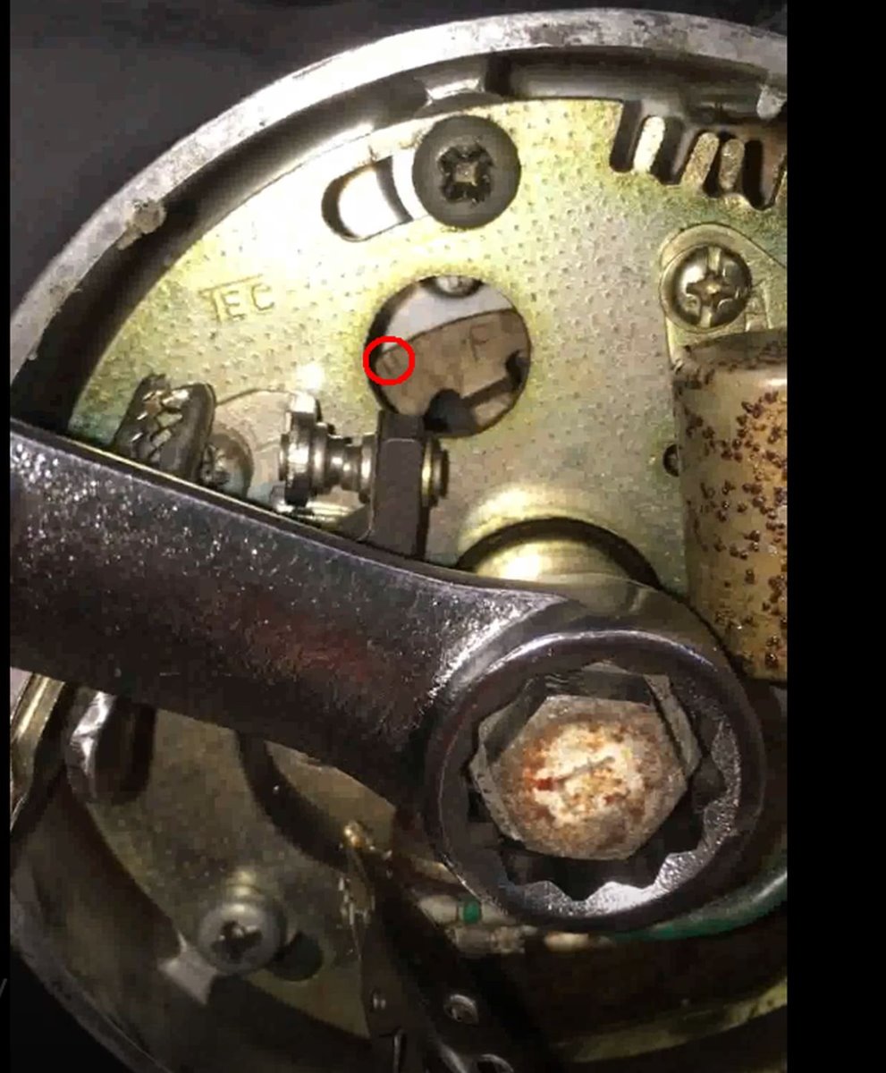

10 Feb 2019 14:03 - 10 Feb 2019 14:13
#798447
Sorry for the late reply, it's been snowing...
Attached is a video of a continuity test.
The beeping stops when the points are no longer touching. In the video this happens when what I think is well before the 'F' timing mark.
EDIT:
Ok for some reason the forum won't let me upload the video even though I tried twice with supported file attachments (mov and wmv)
so I guess a picture will do.
The picture is the point where the beeping stops and the points begin to open.
1980 KZ 440 LTD Model A

Re: Ignition Timing won't synch with contact breaker plate
10 Feb 2019 14:41 - 10 Feb 2019 14:55
#798450
Not the "F" letter is the firing mark, the (red) score on the advancer body is "F" mark @ idle.
and the full advance Timing mark @ 3400 rpm
BTW, Video files max. 10mb.
Last edit: 10 Feb 2019 14:55 by Scirocco.

#798464
Points look worn out.
10 Feb 2019 20:38
#798466
SWest wrote: Points look worn out.
True. They appear to be either worn out, damaged, and/or installed incorrectly. The contact points are not lined up properly, so even if they were to operate something is still wrong. Ed
