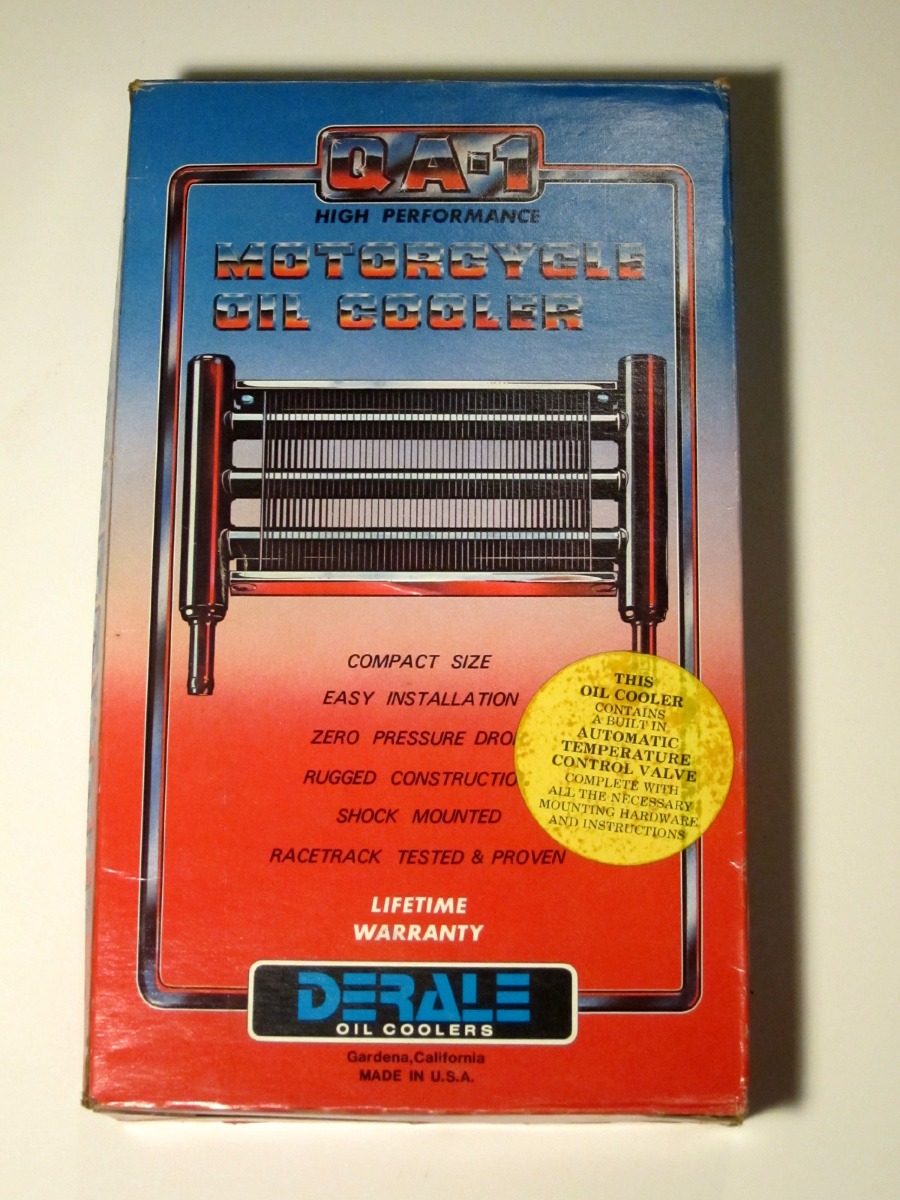

02 Feb 2019 07:59Dime wrote: I am not familiar with oil coolers at all. The zn1100 has a Lockhart oil cooler on it. From what I have read there is supposed to be a thermostat in these which dictates when the oil will actually run through the cooler. How would I confirm this is working correctly?
Derale made a line of coolers with a built in thermostat. I have a picture of the box for the kit that I had, but I don't have a picture of the insert that showed a diagram of how the thermostat worked. But basically there is a metallic finger in the input side tube, and when the oil is cold the finger acts to block the upper cross tubes on the cooler, diverting oil into the single bottom cross tube. When it warms up, the finger (bimetallic strip) bends back allowing oil to flow through all cross tubes.
I don't know if Lockhart made a cooler with the same setup. Maybe try looking down into the inlet port to see if there is anything that would divert the oil flow.
