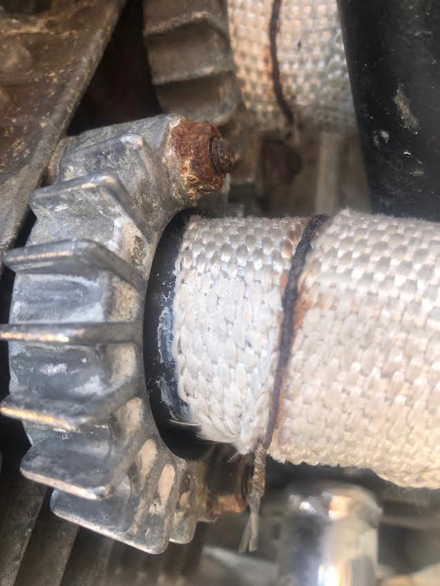

Thanks bill but the studs look really rusty, perhaps even rusted TO the nut:

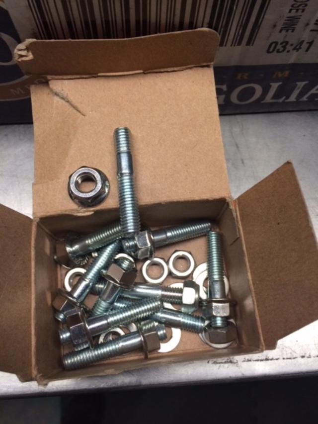

Thanks. Its sorted. Ive ordered them a few hours ago. Job done.
BTW Amazon was the first place I looked. The studs are not so common as you may think.

And those 6mm studs look scary! I would sacrifice those aluminum collars! Cut them off with a cut off wheel! get the exhaust off first, without touching the studs. Then you could work on pulling them out with heat and penetrant. And a good stud puller or good vise grips. Patience with those studs.

Im going to use the penetrant, heat, cool, penetrant, heat cool technique. Im not chopping off a thing with a saw. Time and patience. Its winter. I have plenty of time to work the bolts and studs out.

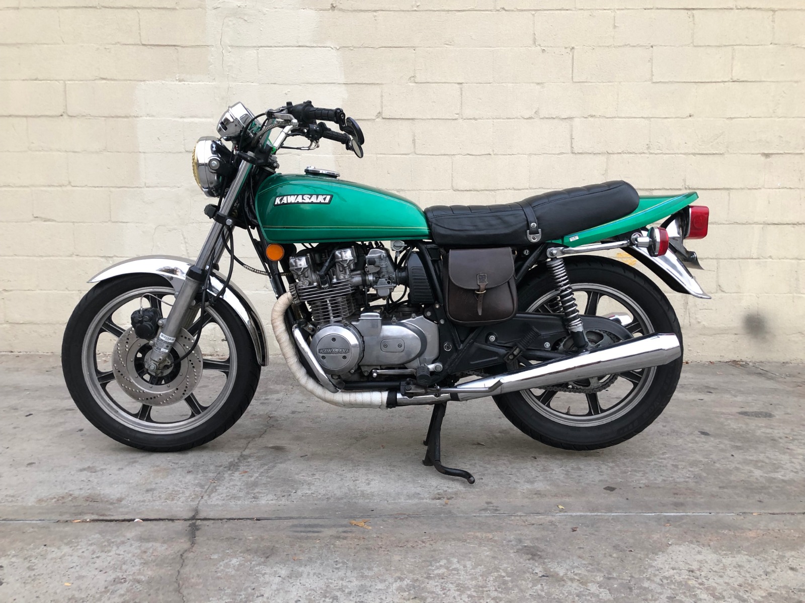

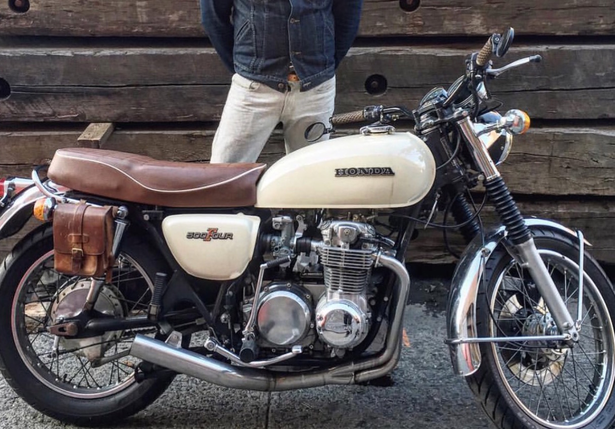

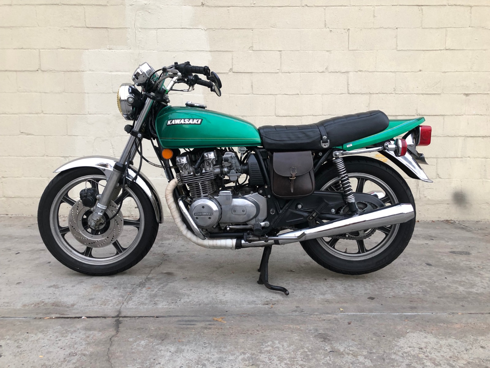

Last week I pulled the trigger on buying a 4 into 1 Delkevic system. I live in NYC and LOVE to have loud exhausts on my bikes for a number of reasons, among them safety AND being obnoxious.
Im having second thoughts. The original stock LOOKS great but sounds rather weak in my opinion. I COULD send the Delkevic back when it arrives. Opinions? Here is my bike, my Honda Cn 500F with Lossa Engineering 4-1 (ppl told me to keep it stock, but I think the 4 - 1 looks great) and guy off on instagram with Delkevic on his 650. Sounds awesome.
So, Stock or Aftermarket?
