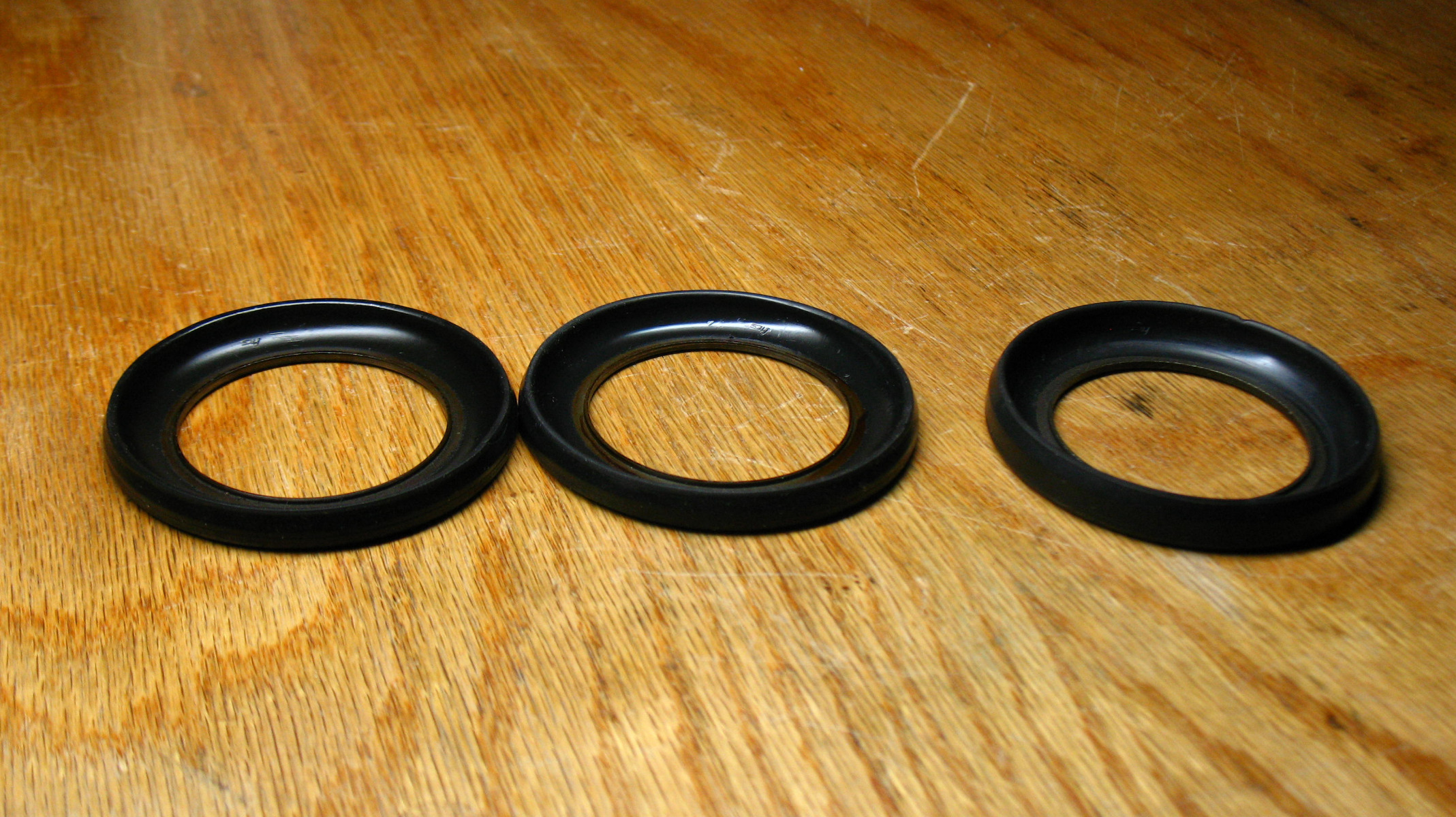

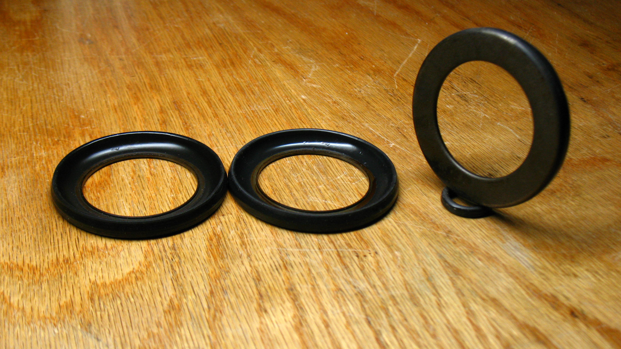

Apparently the space ranges between 6.3mm * to 8.3mm.***. My KZ1100-A2 engine probably has a mid-range 7.3mm ** damper installed.
In the image below, the two dampers on the left measure 6.4mm, and the one on the right is 8.4mm. These dampers may be similar on engines other than a J-model.

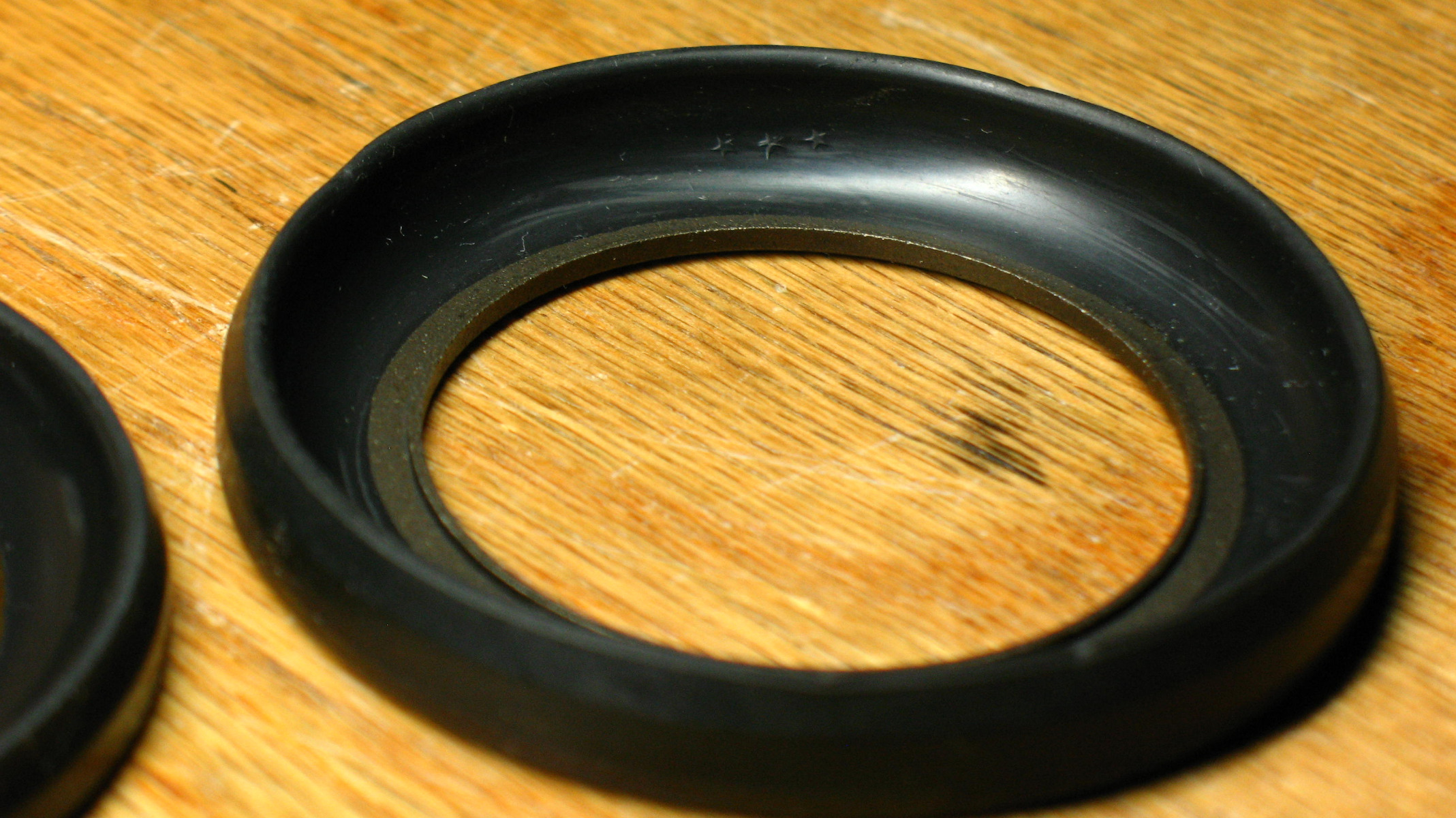

Note the Kawasaki *** identification detail molded into the rubber
The back flat side is metal. IMO to reduce thickness, I would sand off material from the rubber edge which faces and rubs against the engine
