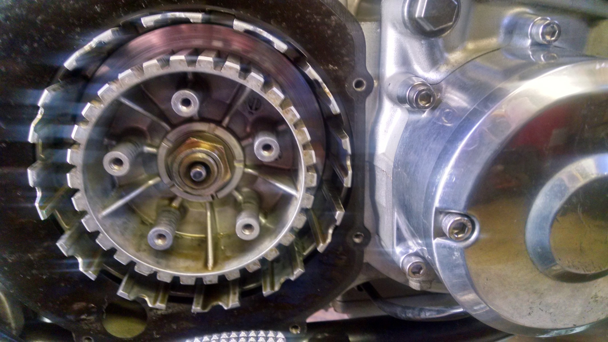

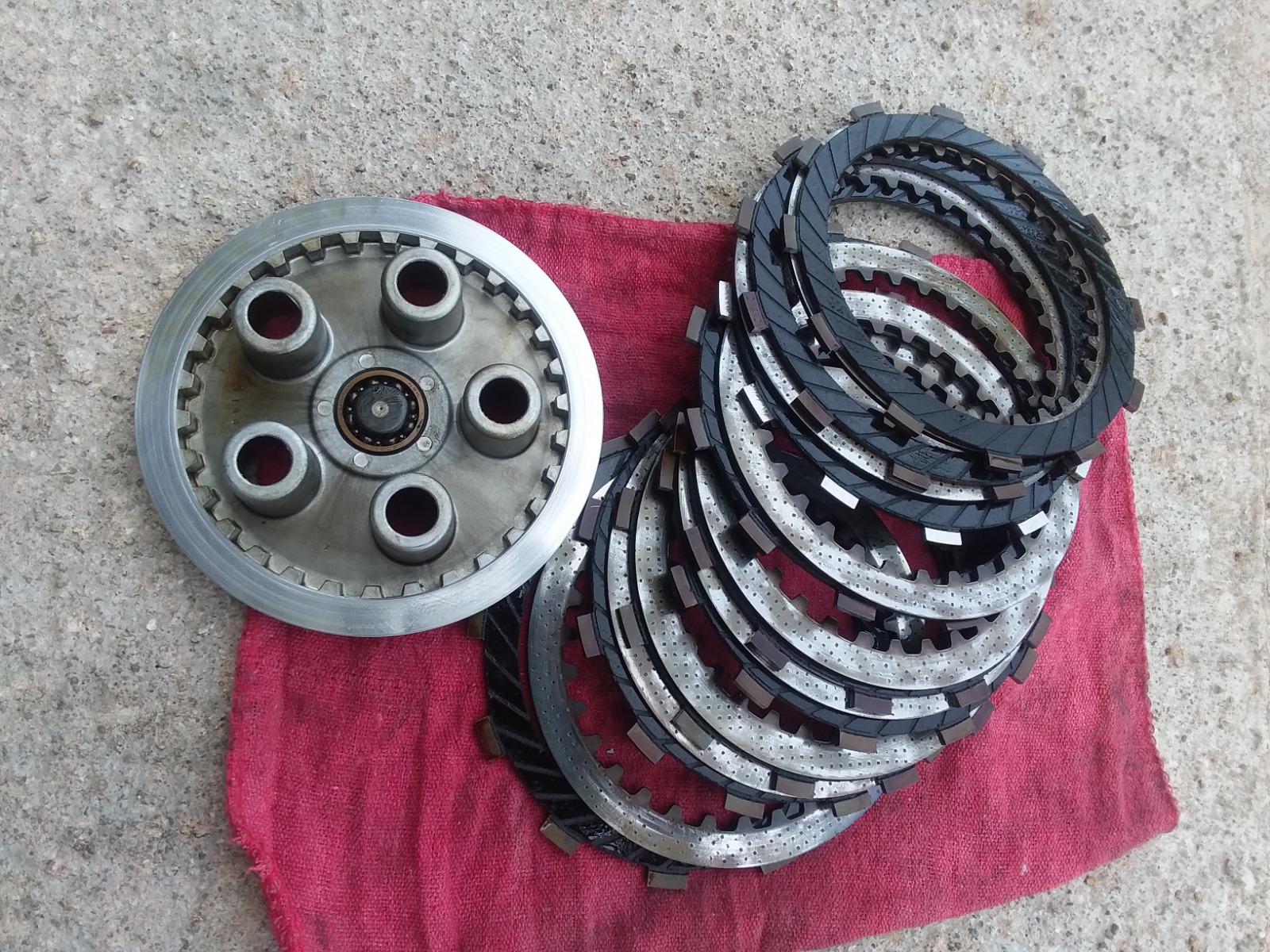

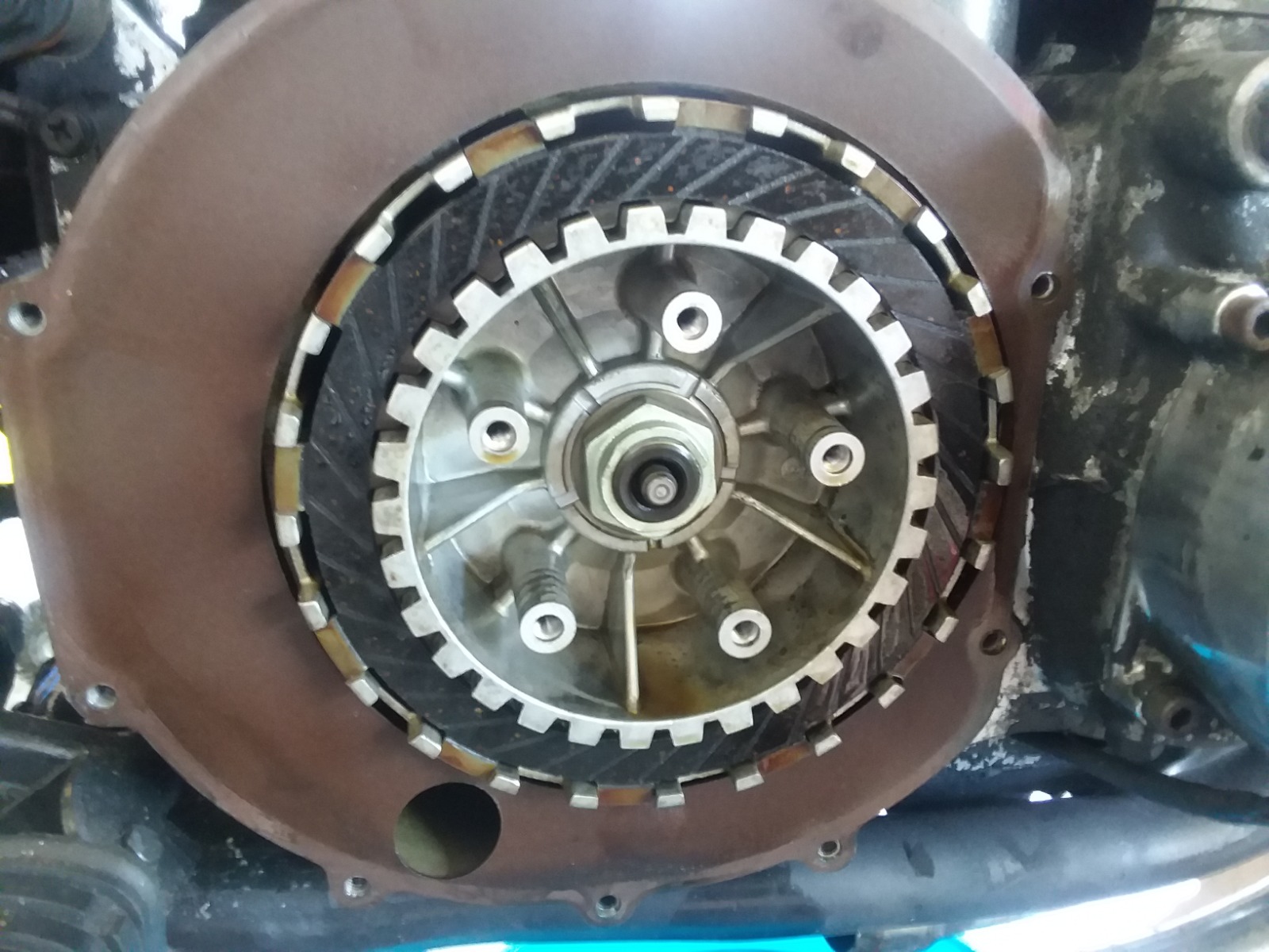

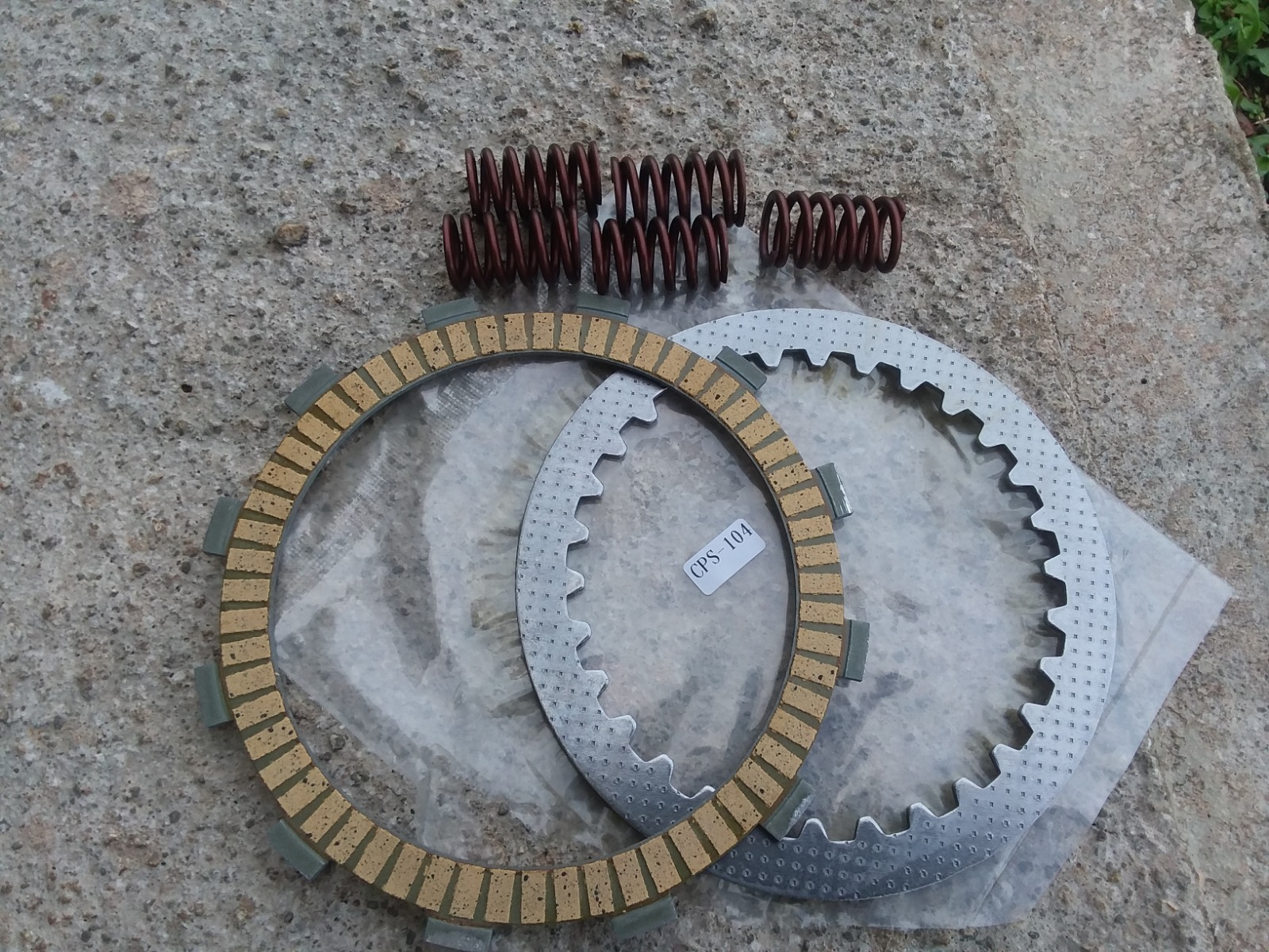

I got the old clutch adjusted and it did well.
But in the meantime I picked up a $40 clutch kit and decided to try it out. It looks like cork material. I had to re adjust for the extra bite and It seems to hook very well, but I don't know about longevity.
For now it pulls hard and will spin the rear tire with ease.

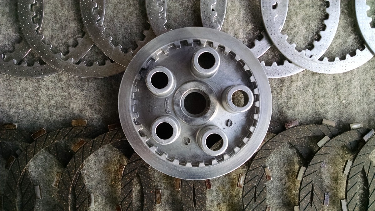

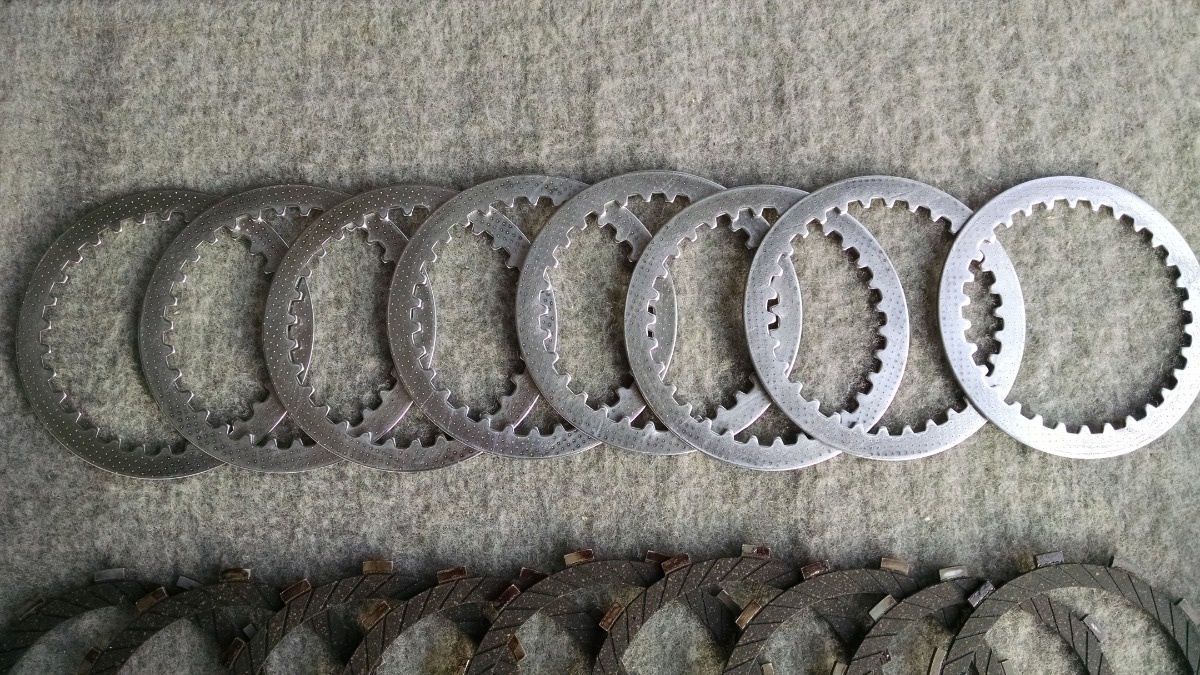

That certainly sounds like a bargain. I just ordered 9 frictions and 8 steels from Partzilla yesterday. Oem parts. With another clutch cable frame clip it totaled ~$157.00 including 12 bucks freight. (combined the freight using the cart function)
www.partzilla.com/product/kawasaki/13088..._EAAYASAAEgKKFvD_BwE

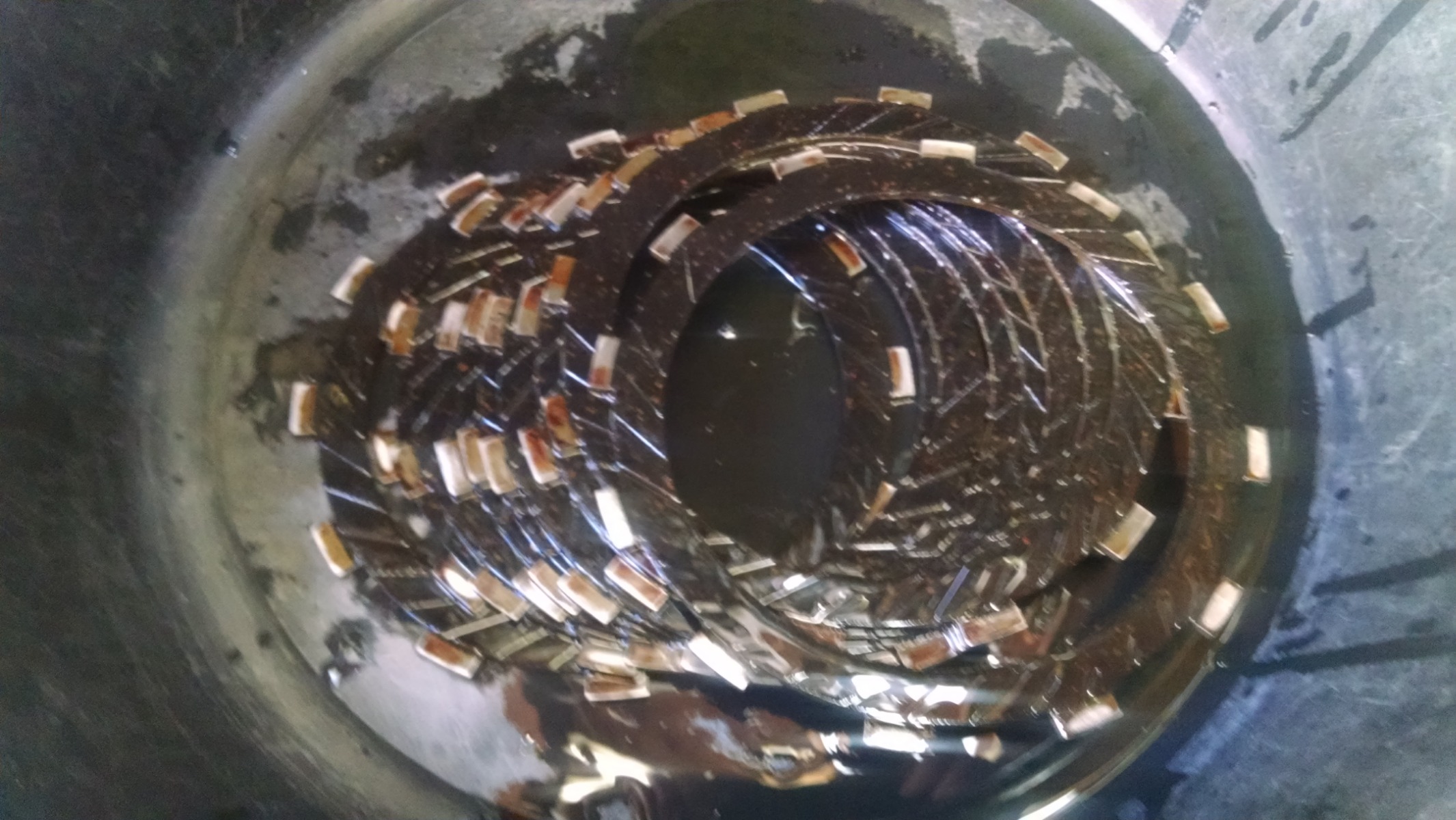

I just hope I didn't waste a bunch of money buying the OEM parts for a clutch that can't hold up to my HP. I still think my 38 year old plates are so impregnated and heat glazed from the years of abuse, that new oem plates will handle the torque.
Yours do look pretty glazed, and I'm sure Ponce just dumped any old oil in it too.

The OEM Kawasaki clutch plates will hold up just fine. They are actually better than any aftermaret clutch kit. I used the OEM ones on my well over 100HP KZ1000R clone. Did a bunch of wheelies, burnouts and drag races with it.

I recently renovated my clutch by changing out the springs, lubing the actuator and just checking the plates - the plates were all within spec.
The plates wear out with use, but the springs will also wear out with age, and most of our bikes are pretty old now. Changing the springs alone will often do the trick.

I replaced the springs about a year ago. I have also soaked the plates in citrus degreaser, (twice) scrubbed them with scotch brite and a brass wire brush trying to deglaze them and remove any moly additives / glaze and they still let go when I pour on the coals. My bike runs extremely strong, better than most, for sure. It needs a clutch that is 100%.
I did use the aftermarket Z1E springs. I don't have a spring scale to check them, but I assume they are still good. ,

Also in agreement with others who are recommending the stock clutch components. FWIW, back in the day, the hot ticket for the KZ dragbikes were the factory stock fiber plates with the hard chromed MTC steels. I used them with no issues @ 275 HP and the Funnybike guys (425 - 450 HP) used the same combo. I know that you're dealing with a J-model motor, but the concept remains the same, I believe. Excessive slippage (= heat) will do in any combination, regardless of power output.
