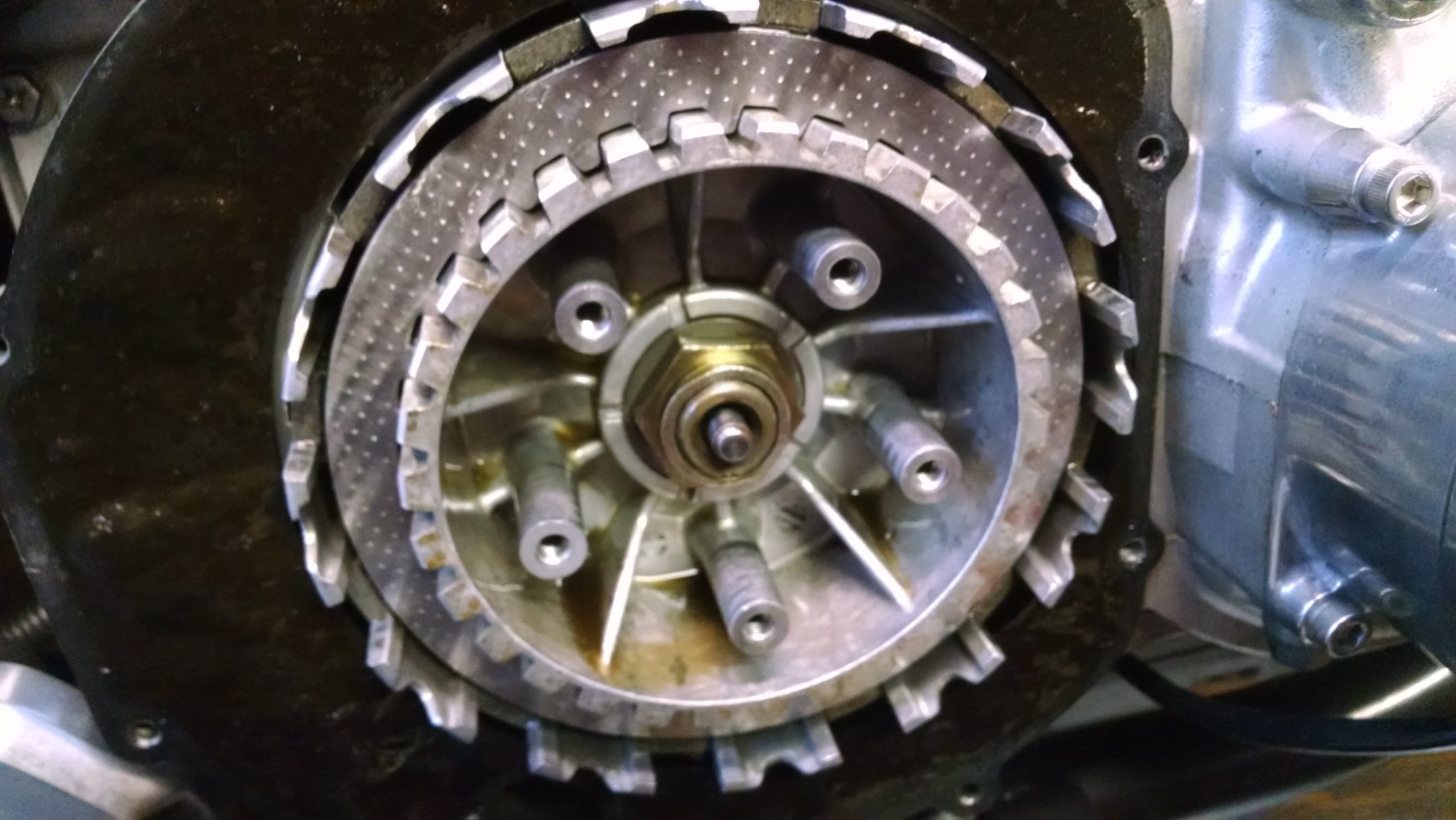

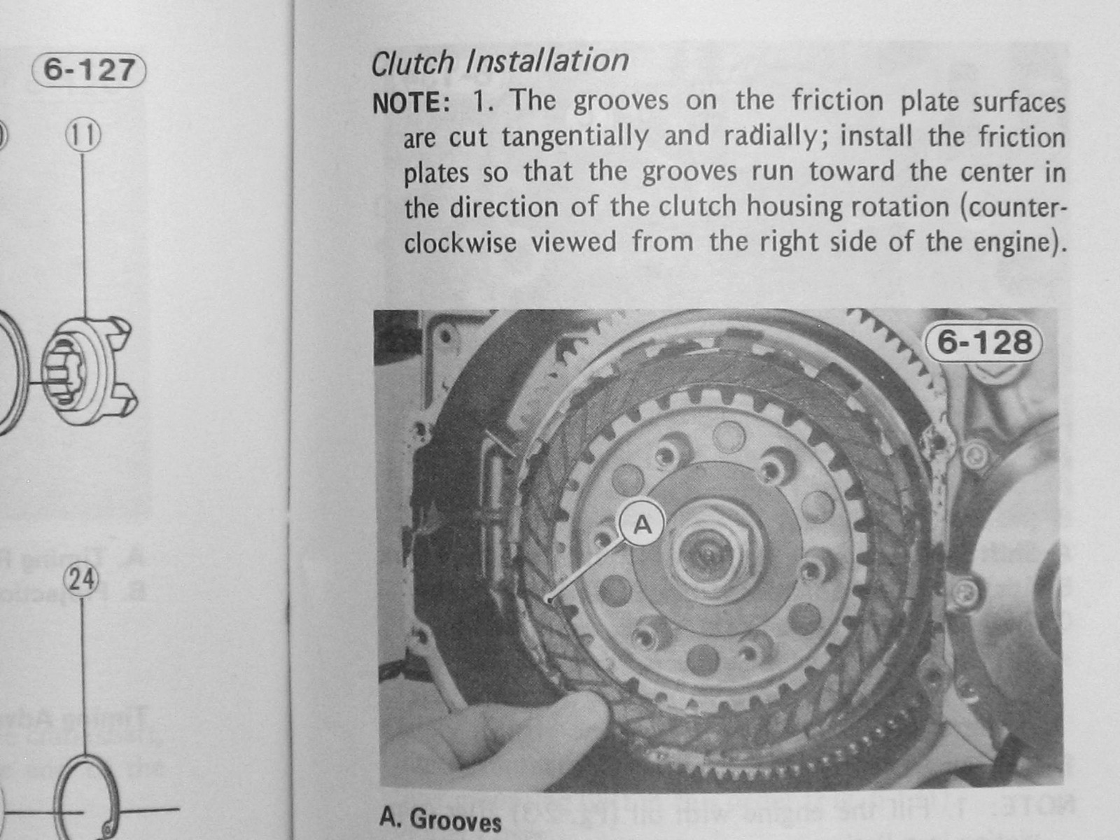

Image below from the KZ1100 Shaft FSM describes correct orientation when installing OEM Kawasaki friction plates.
:whistle:

11 Jan 2019 11:22 - 11 Jan 2019 23:48Thanks for posting this Dave. I did not realize or notice that the plates had a orientation to follow, but it does make sense. I don't know how much difference it can make as far as clutch slippage, but it does have to make at least a little bit of difference. I plan on looking how they are orientated when I take it apart. In all of the threads I have read on rejuvenating the clutch (soaking plates in degreaser , spring pressure, etc.) , you are the first I have noticed to point this little tidbit out. Of course it helps If >I< do more research myself before jumping in with both feet and wondering why stuff doesn't work right. At least I WILL take solid advice that people point me towards.

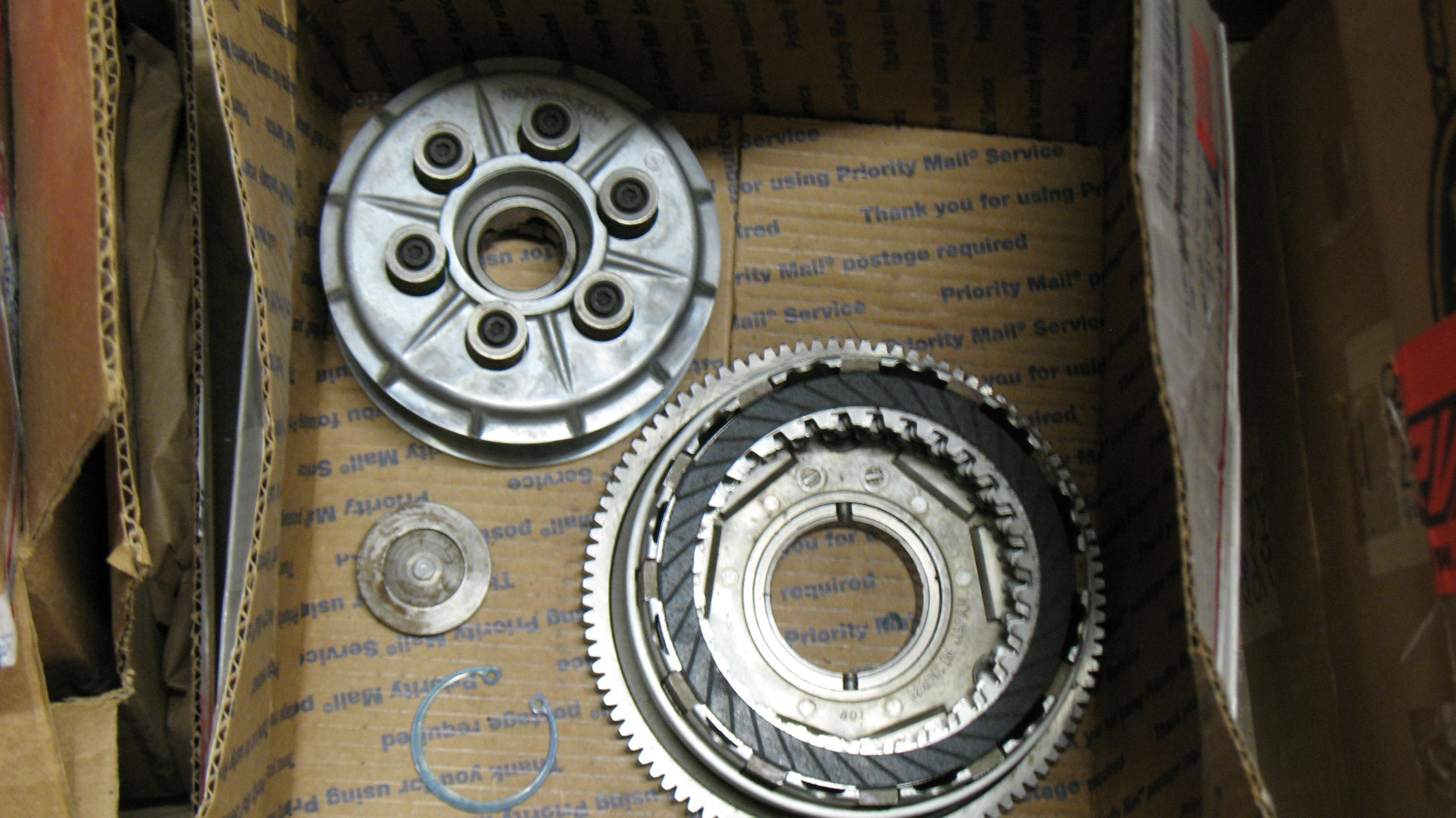

BUT, Hey! You have 6 clutch springs! I'm Jelly! LOL More, yet slightly weaker springs to go easy on the left hand.

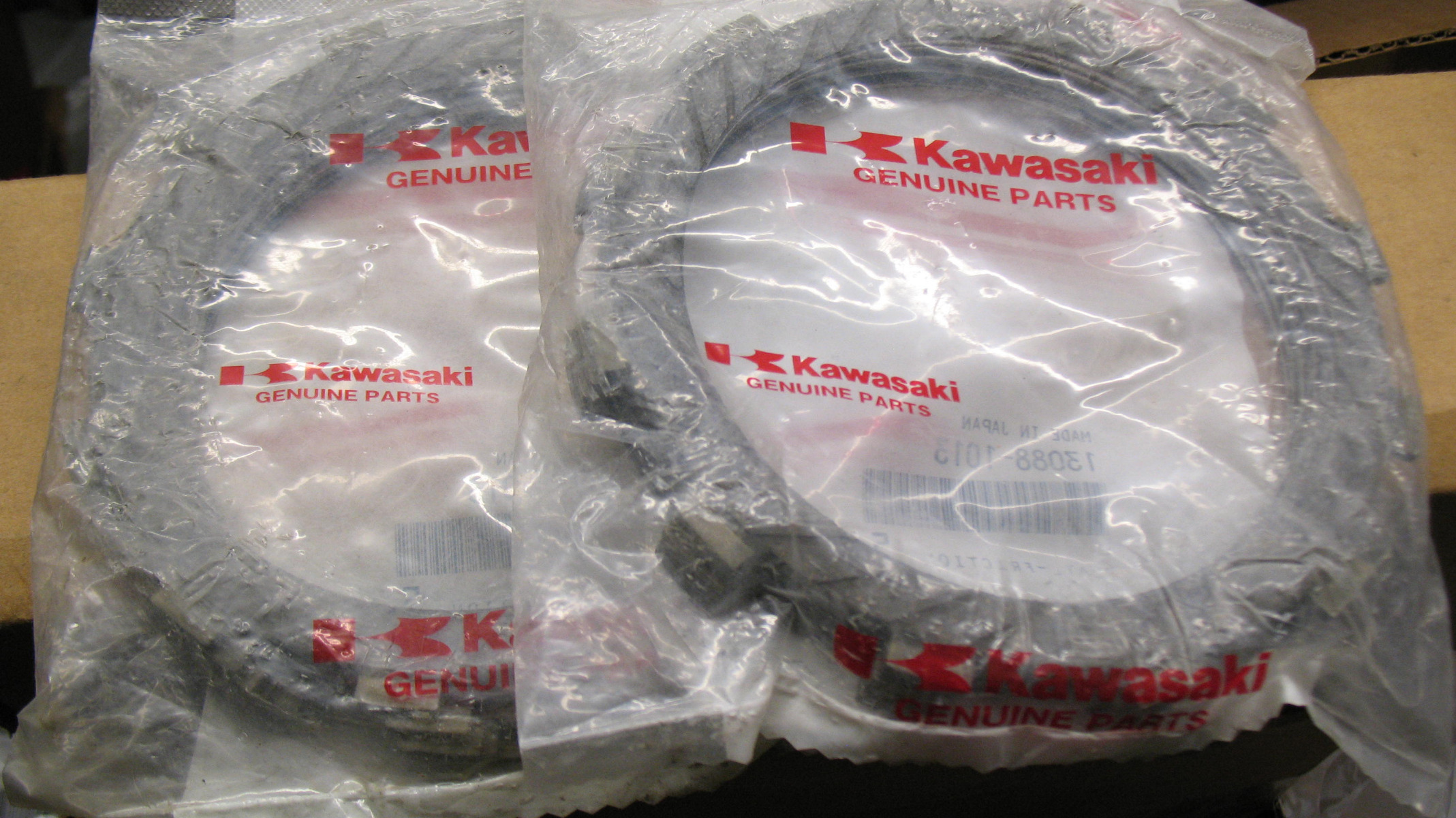

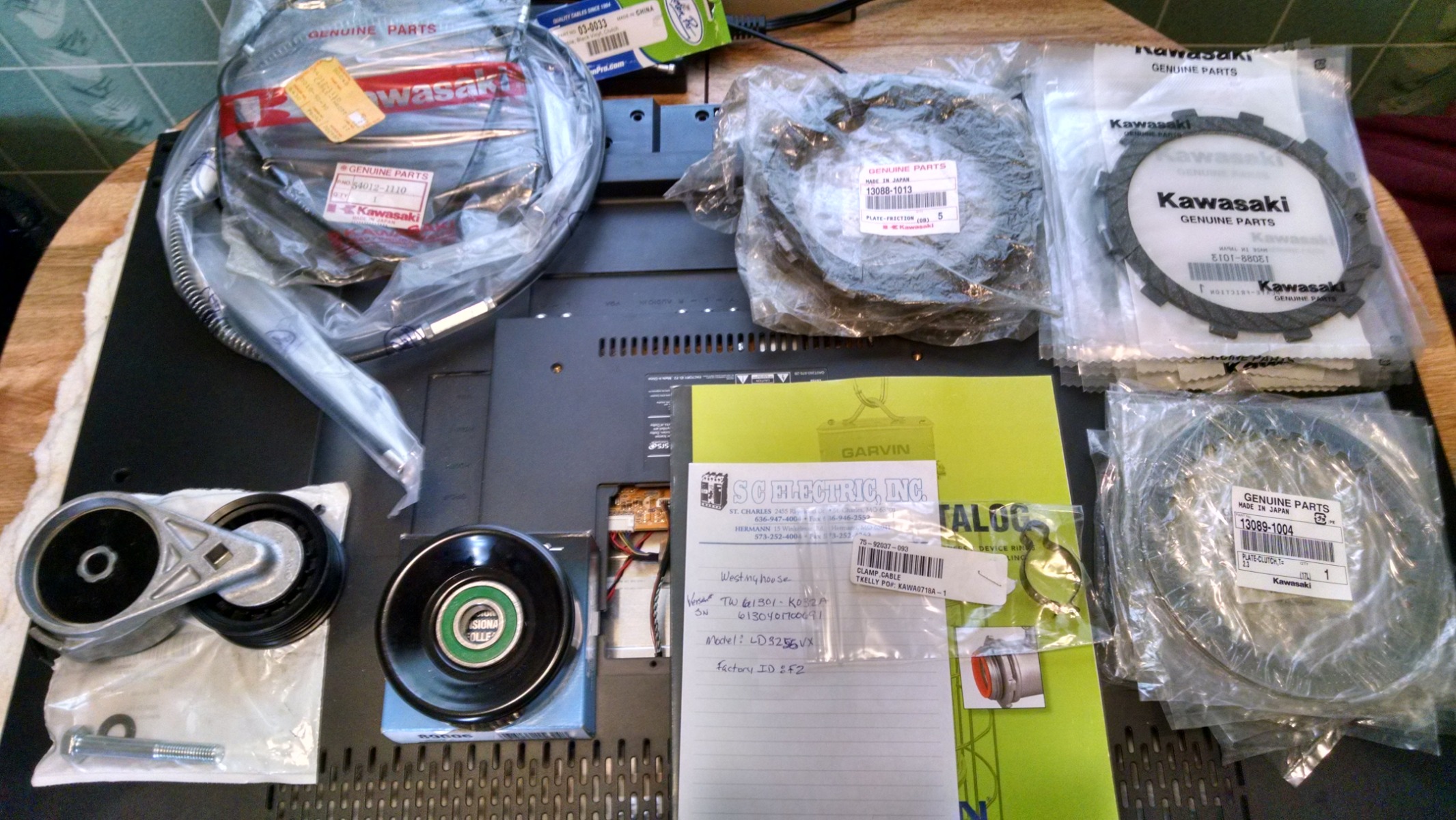

I wonder if I can adapt that setup onto my 81 J motor?My OEM frictions and steels that I ordered from Partzilla last Sunday came yesterday. I was just opening the package and checking out what NON-counterfeit OEM clutch parts come from the dealer packaging looks like. All individually packaged and clearly marked as genuine Kawasaki parts. Unlike the eBay disclaimer that the original packaging may not be there.
I took a few pics for your viewing pleasure.

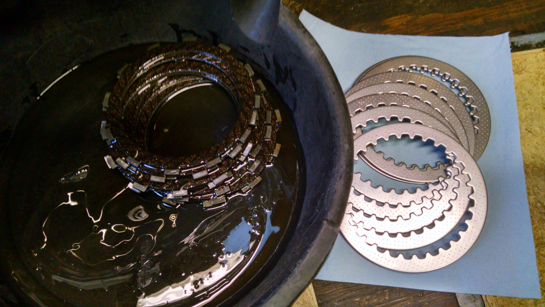

9 Frictions:
Back side:
8 Steel plates:

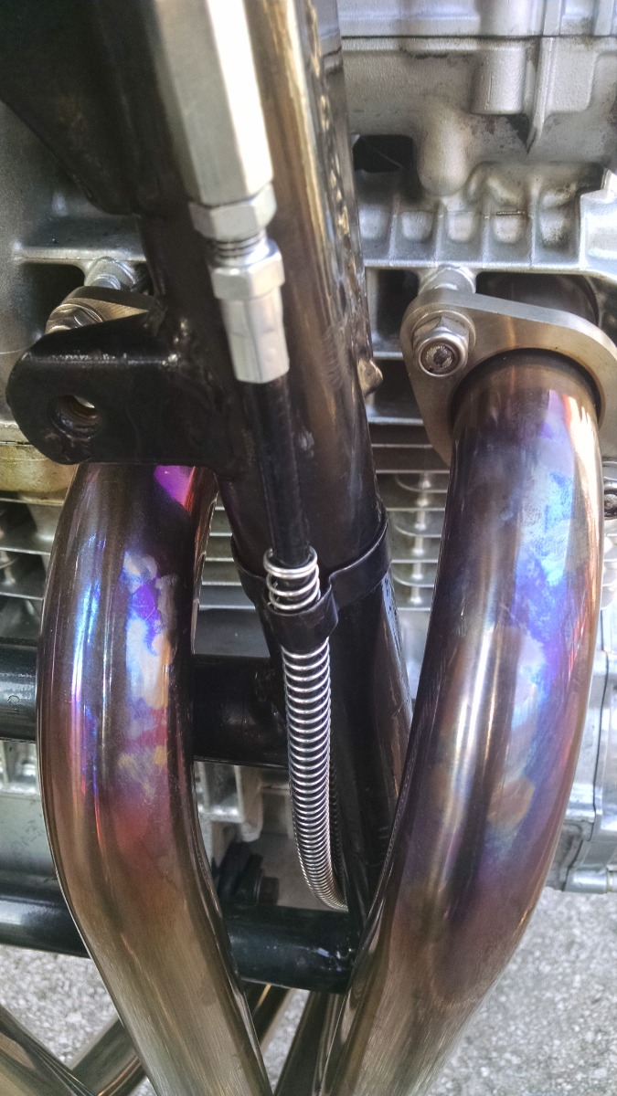

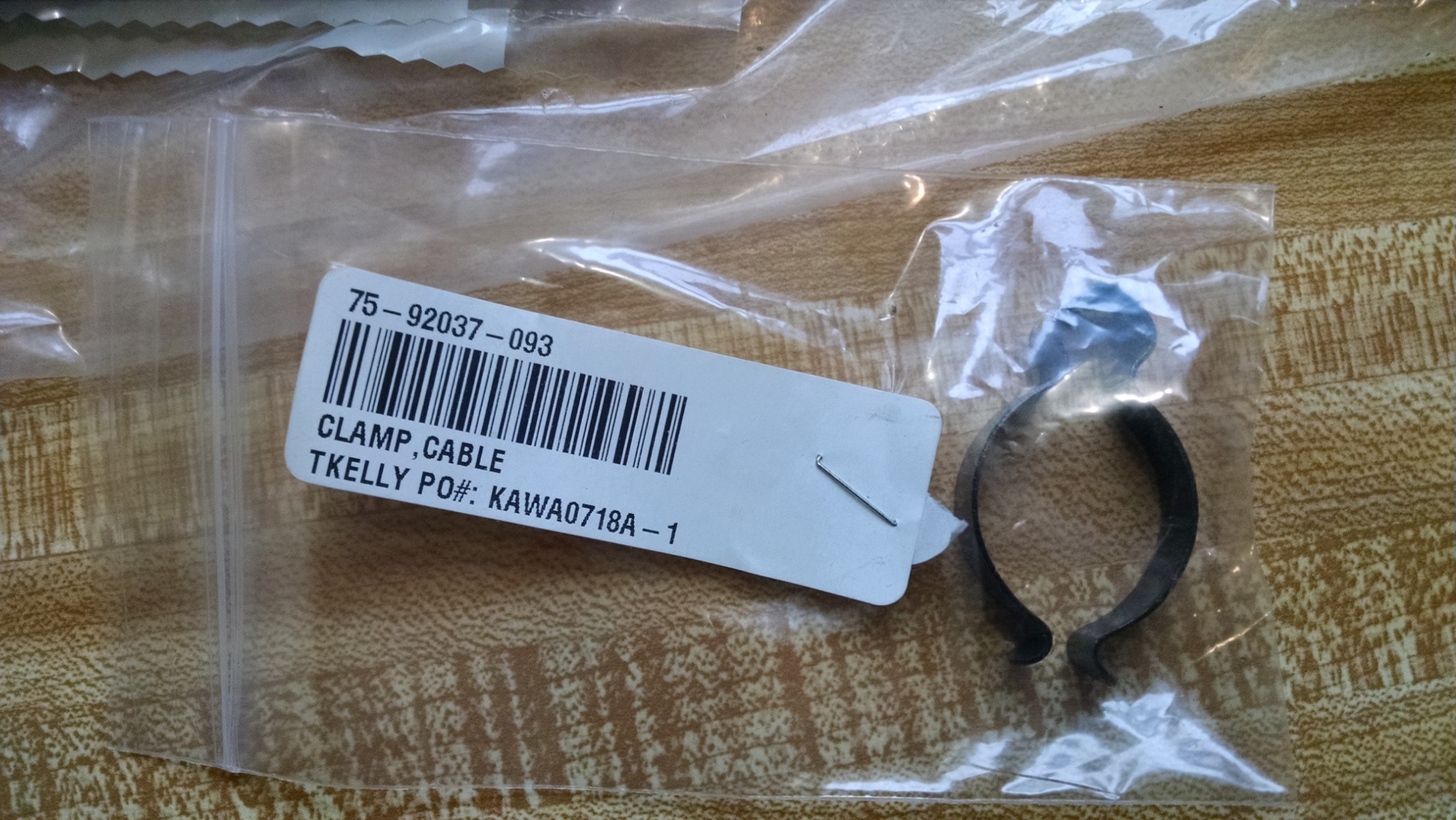

And since I put on my SS Delkevic exhaust, my clutch cable seems to be getting scorched from the header pipe, since it runs hotter that the original double walled exhaust. I wanted an extra cable clip in hopes of keeping the clutch cable away from the header.

BUT, Hey! You have 6 clutch springs! I'm Jelly! LOL More, yet slightly weaker springs to go easy on the left hand.I wonder if I can adapt that setup onto my 81 J motor?
Maybe? Based on the following part diagrams the components appear to be quite different:
KZ1000J1: images.cmsnl.com/img/partslists/kawasaki...ar089862026_049d.gif
KZ1100A: images.cmsnl.com/img/partslists/kawasaki...ar093162104_8ff5.gif

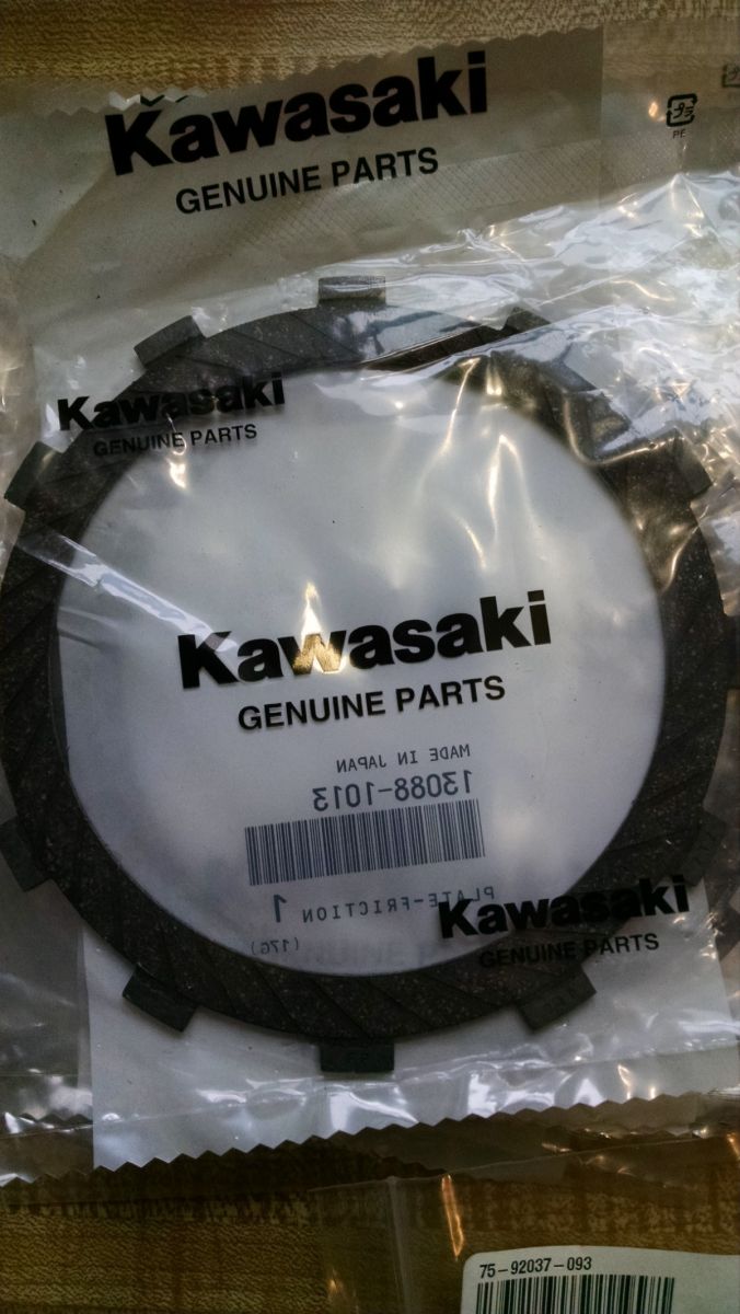

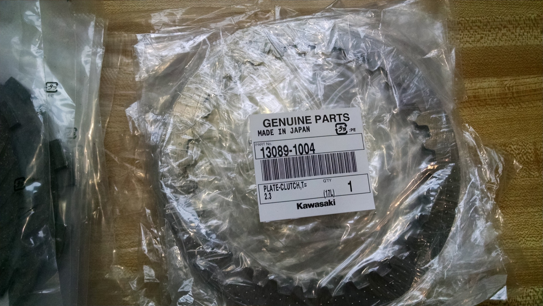

A backup clutch set
Picked up two 13088-1013 5-packs off ebay. $23.98 to my door...couldn't resist.

Am I reading this right? You got 10 OEM clutch frictions for $23.95 with free shipping? That is $2.39 each, delivered.
I paid ~$157.00 for the parts I pictured. You get ALL of the eBay deals Dave! LOL
I had already looked on eBay before I placed my order and did not even come close to a deal like that. All I was finding was what appeared to be counterfeit parts for about the same price that Partzilla was offering. Of course, I will pay a little more (usually freight charges) to make sure I am not buying either very old, or questionable parts.

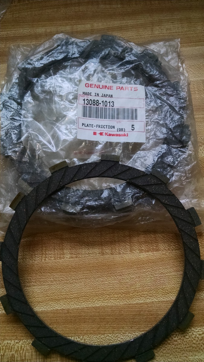

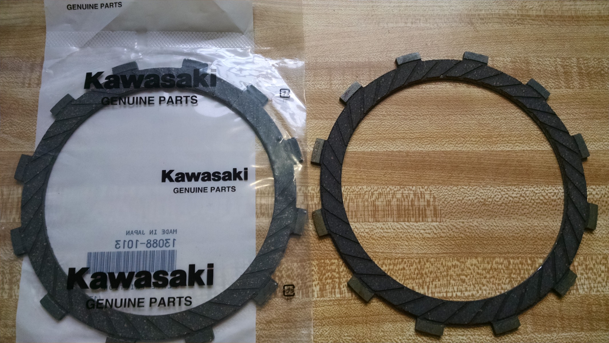

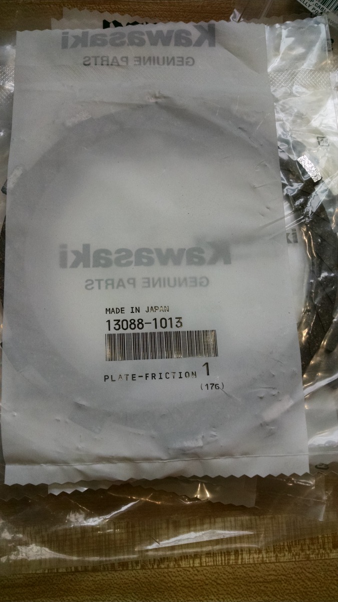

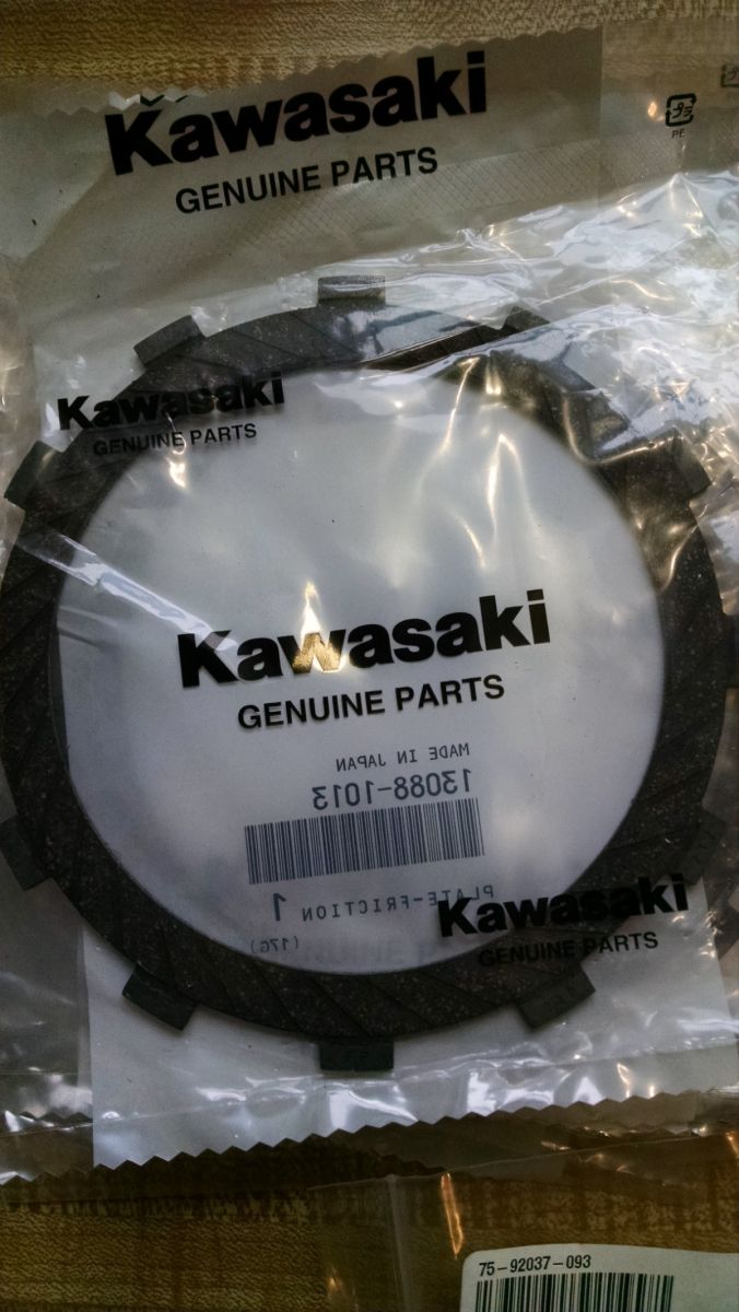

The (2) 5 paks I ordered Sunday came Wednesday, Sooo,
NOW, I am the proud owner of 19 OEM clutch plates. 10 NOS, and 9 obviously NOT old stock from Partzilla.
I don't know if friction material can go bad after 30-40 years, but since I paid top dollar for the Partzilla plates, I am leaning towards using the new stuff and rat-holing the NOS plates.
Any thoughts on NOS friction plates? NOS on the right:
I also ordered in a NOS throttle cable and a Motion Pro 03-0033 clutch cable. I have quite the collection of parts on top my my latest TV repair project on my kitchen table, including a new serpentine belt, idler and new tensioner assembly for my truck (too freakin cold right now to do any of it).. Doesn't everyone? lol

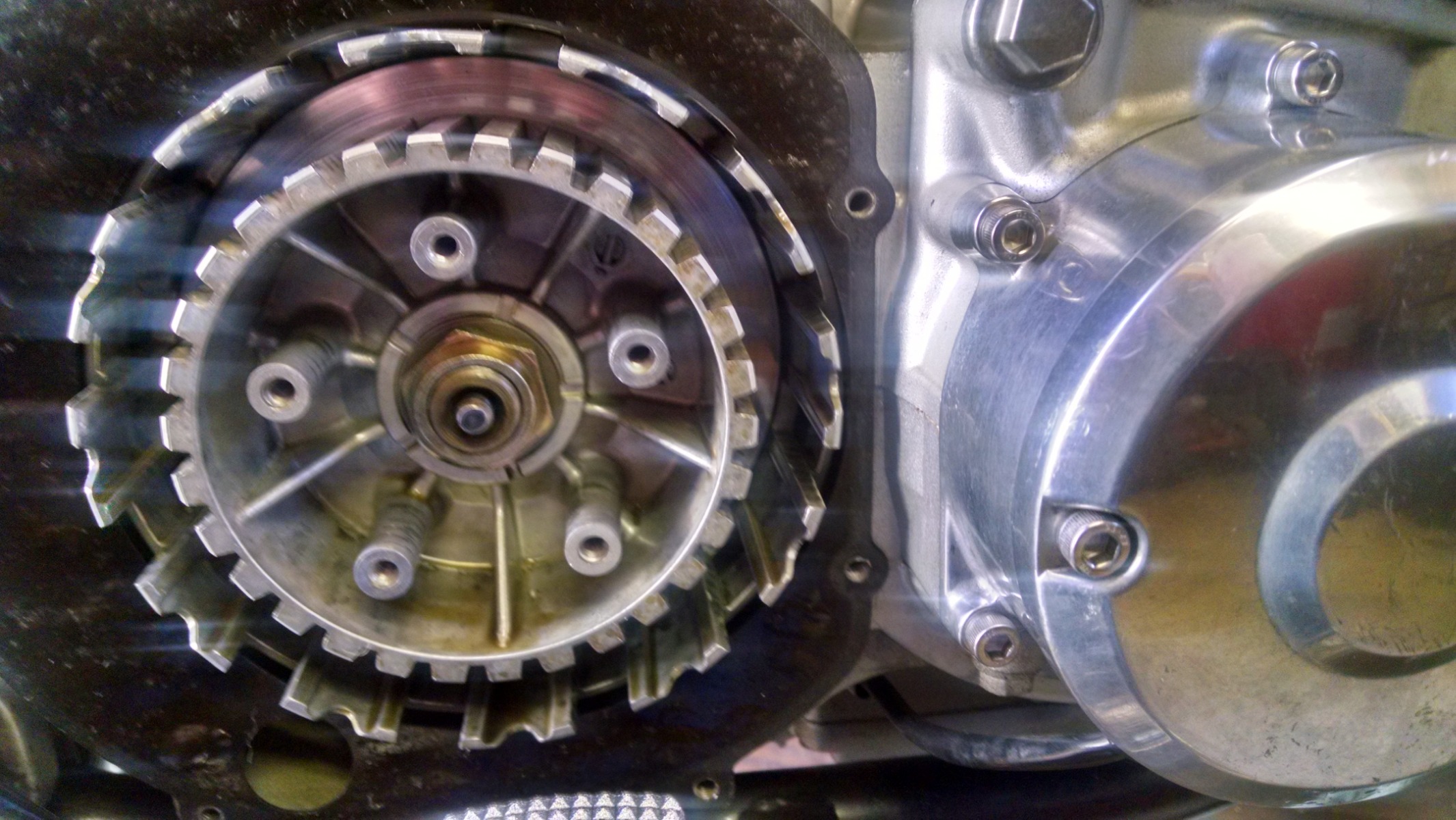

Well I managed to install all of the parts I had laying om my dead TV project except for my dead tv. No biggie, it's just a CL freebie anyway. Anyhow... I managed to install the new clutch plates last week, then install the new clutch cable and re-route it to keep it from getting cooked again by my Delkevic header. AND, as per the info daveo posted on orientation of the directional clutch plates, I had at least half of the 9 installed backwards. I took my bike out Sunday after almost record low temps last week (complete with frozen pipes). Sunday it almost hit 70* F here in the lou. I did not notice any slippage, but did not hammer it too hard, since my bike looks to need the A/F ratio fattened up a tad with the new pipes. I unwrapped all of those plastic bags, and cleaned the cosmoline off of the steels with mineral spirits, then washed them with dish soap and water.
Brand New OEM frictions and steels from Partzilla. Note that they are laid in the pan with the proper orientation and soaking in T-4 Rotella prior to installation. I installed the steels with the sharp edge facing out.
I had at least half of them installed backwards.

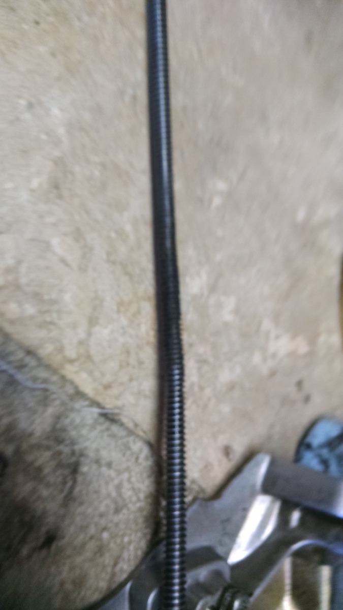

This is one cooked cable. No longer moves. lol
This new routing should keep it good for a while. My new pipes look like crap. I may remove them after I fatten it up a tad and try a few compounds with my bench polisher on the bluing.
