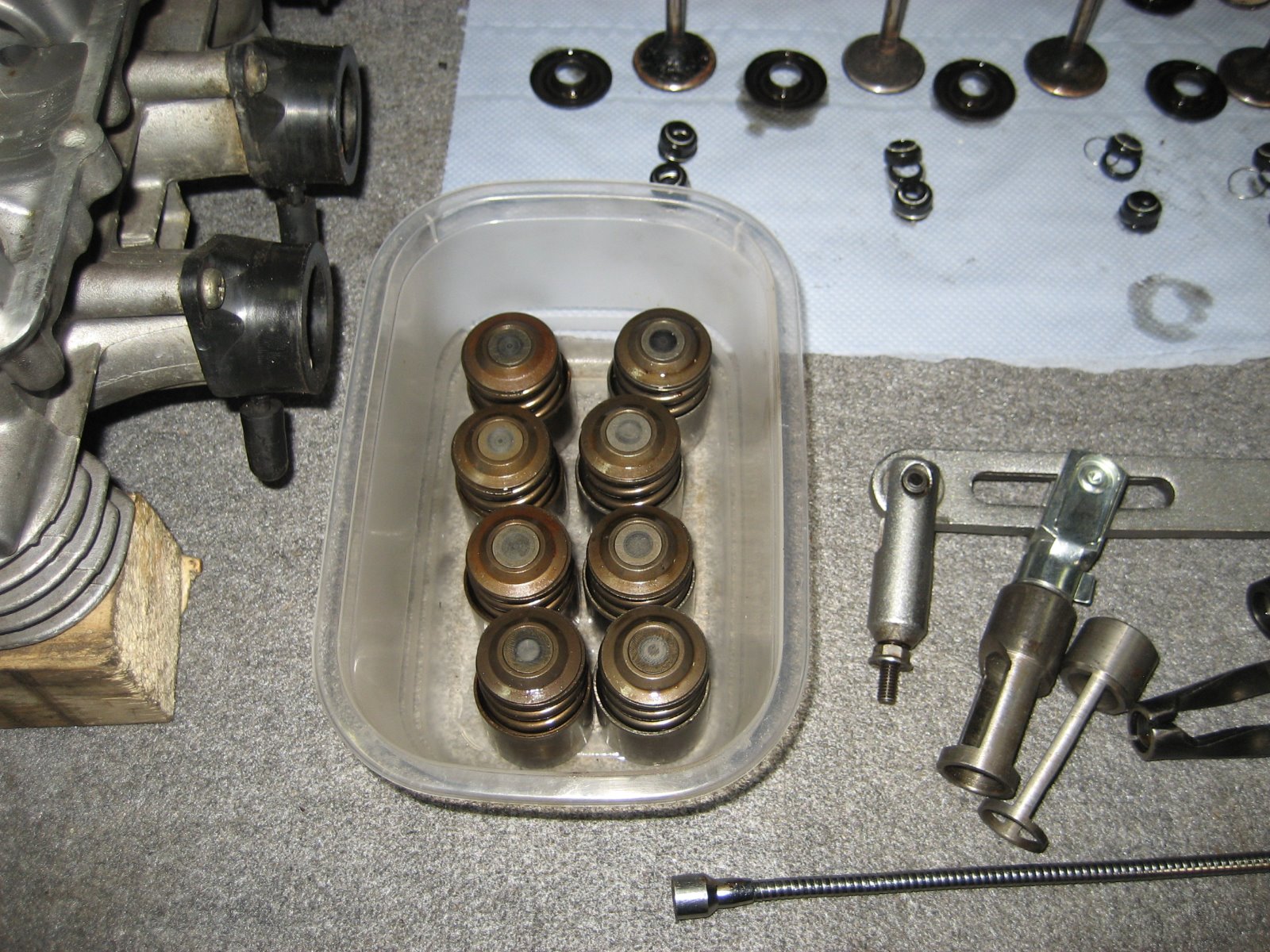

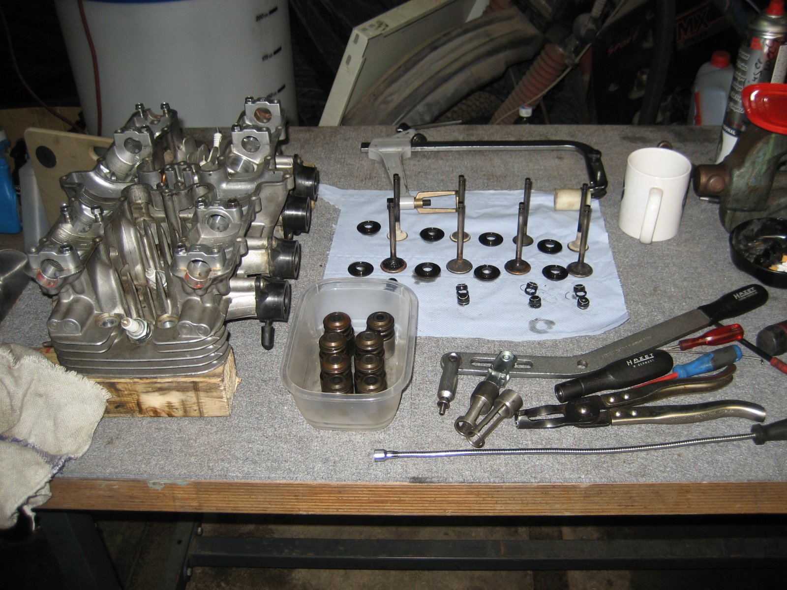

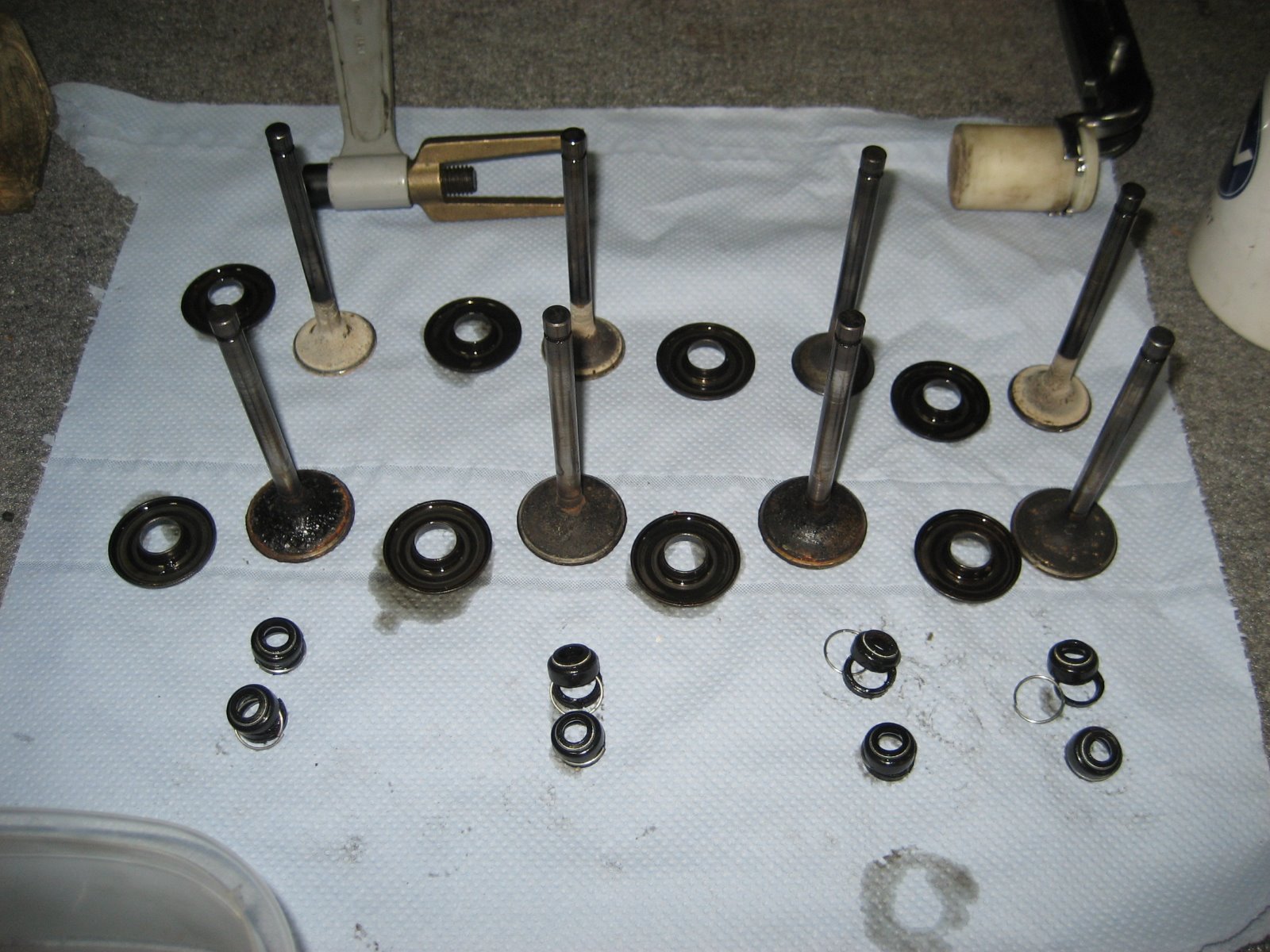

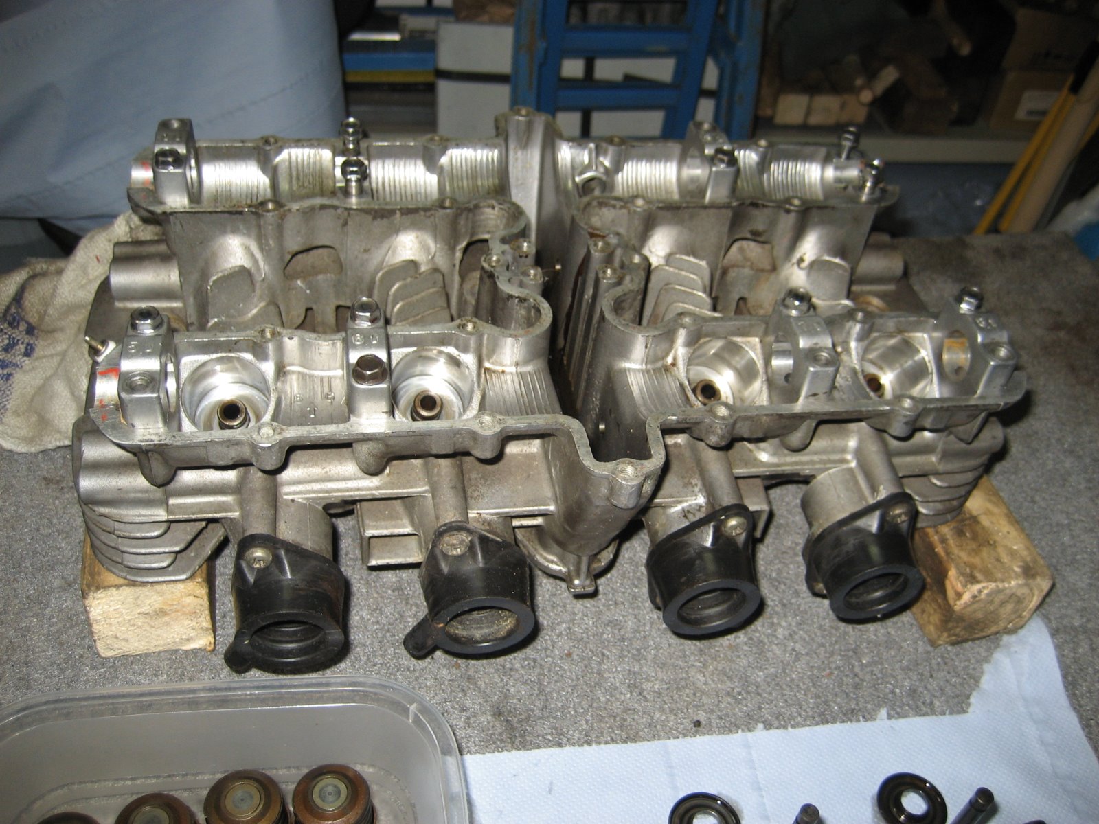

Looks more like an leaking valve stem seal, they will get hard and brittle and let bypass oil. specially #1 cylinder will fill with oil if parked the bike on the side stand.

16 Oct 2018 17:01Did you have to take the whole engine out?

No, top end comes off in the bike. Good time to inspect the cam chain rollers and guide.
