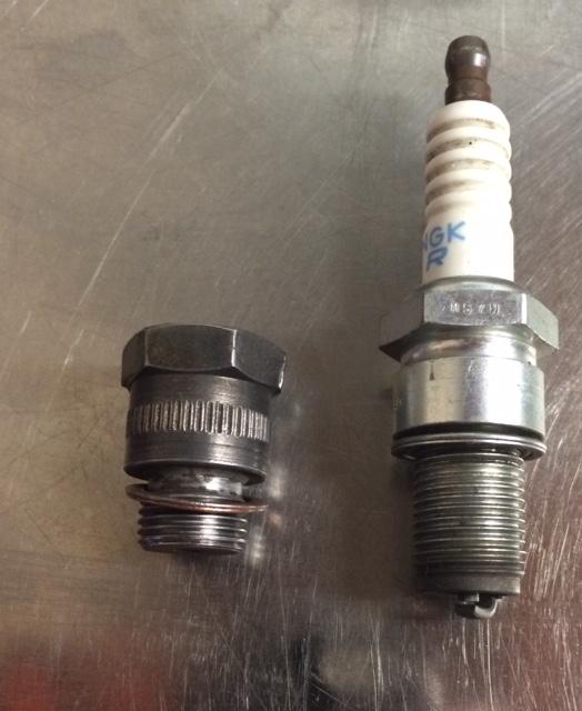

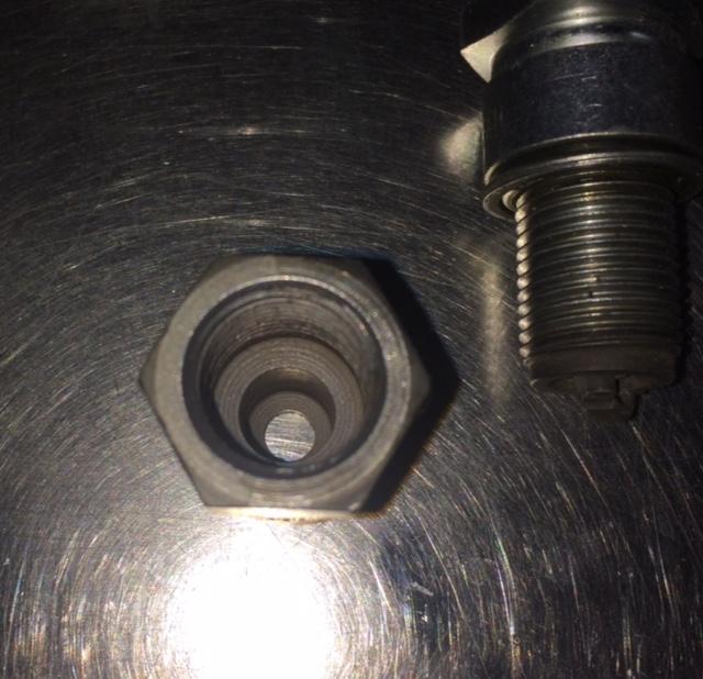

Common on these old bikes. Rattle is most likely baffling inside of pipe rusted away inside.
When these old bikes sit on kickstand for extended time. . Oil flows to that side more. Sits in the head. a little extra runs by guide & seal.
Plus the float bowl, would have extra gas sitting on kick stand.
The plugs foul easy. When I rode 900 street bikes, I always had a couple of dry plugs & a plug socket in the tray under seat for a quick change.
Don't buy any new plugs. Just keep a few old ones. Clean them, Dry them with a propane torch, then they're good to go.
And never use Champion plugs! When you have slight engine issues. NGK and Autolite were always the best for me 20-30 yrs. ago. When points were the normal.
I'll show my age here! :laugh: This is a non-fouler! It extends the plug up. keeps it a little drier. Had this for old harley Shovel head engines. It don't fit 3/4" reach plugs. You need to put a shorter plug. But when you had a bad cylinder / head that needed work. This would get you by!

z1kzonly wrote: Common on these old bikes. Rattle is most likely baffling inside of pipe rusted away inside.
Thanks for this wealth of info. Im going to clean them as you suggest.
