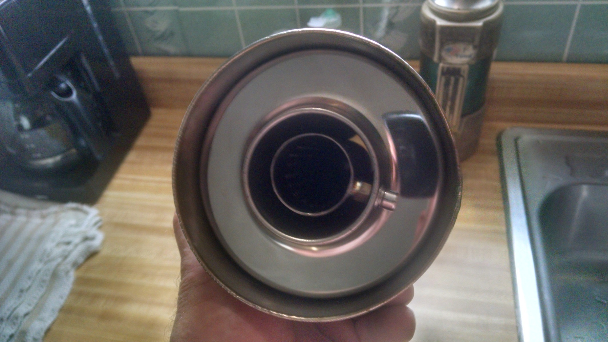

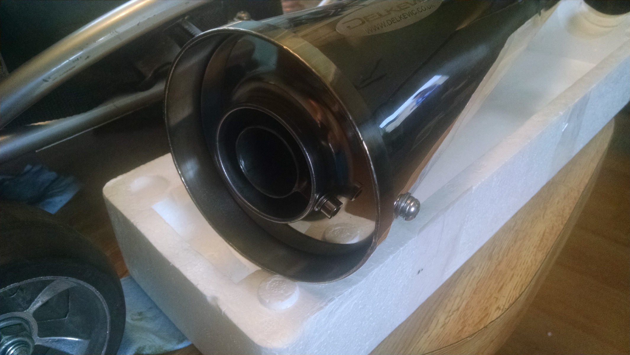

Here is a close up of the baffle end dave. It has an inner and outer baffle that can be removed progressively. The documentation list that no rejetteing is necessary if all baffles are left intact.
I tried several times to get a good pic looking into the silencer. This one was with the flash set to on, instead of auto.

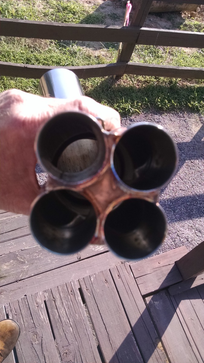

This is the pipes end of the collector. These welds are so tiny and articulate it is hard to capture it in a pic.

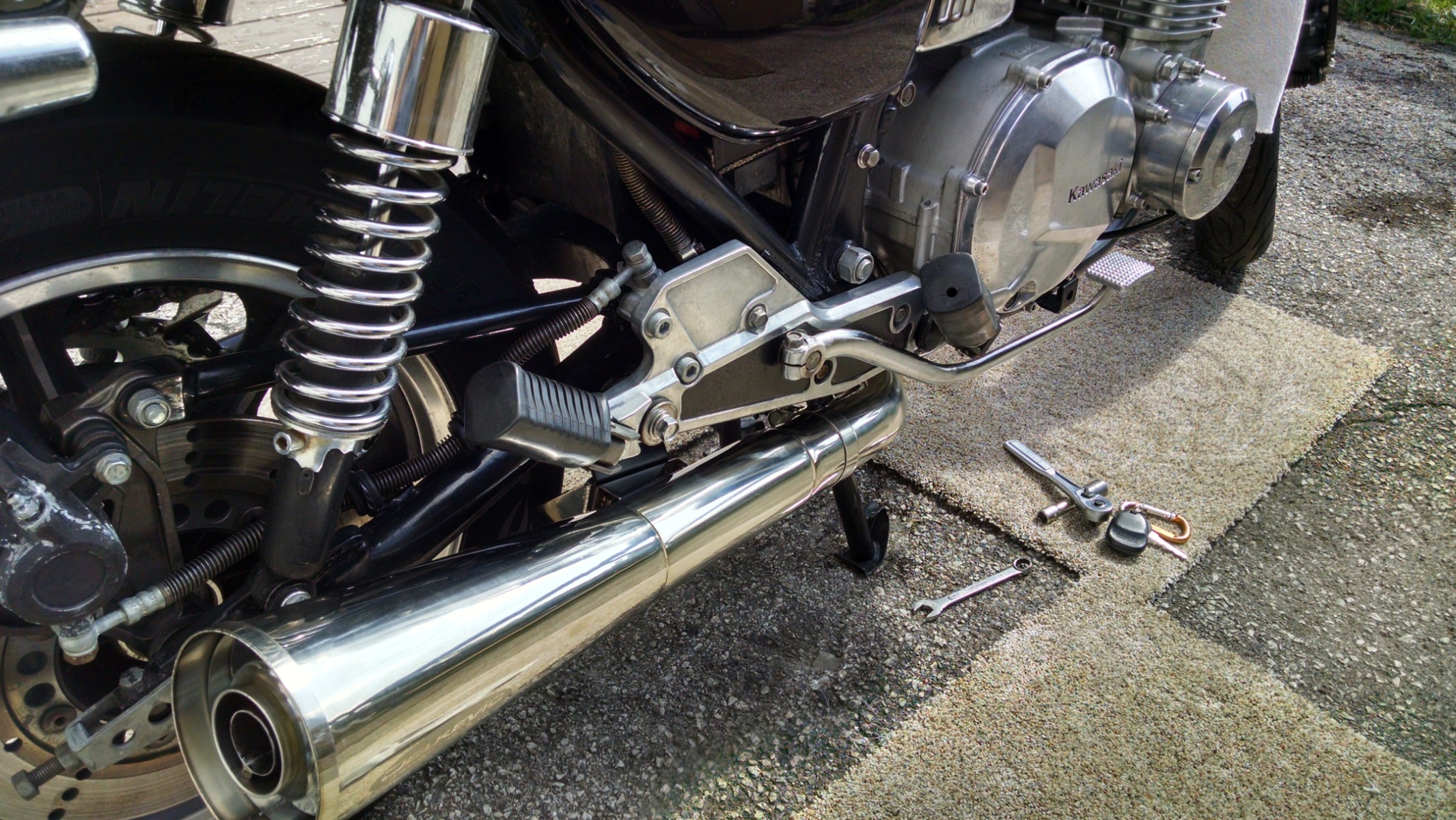

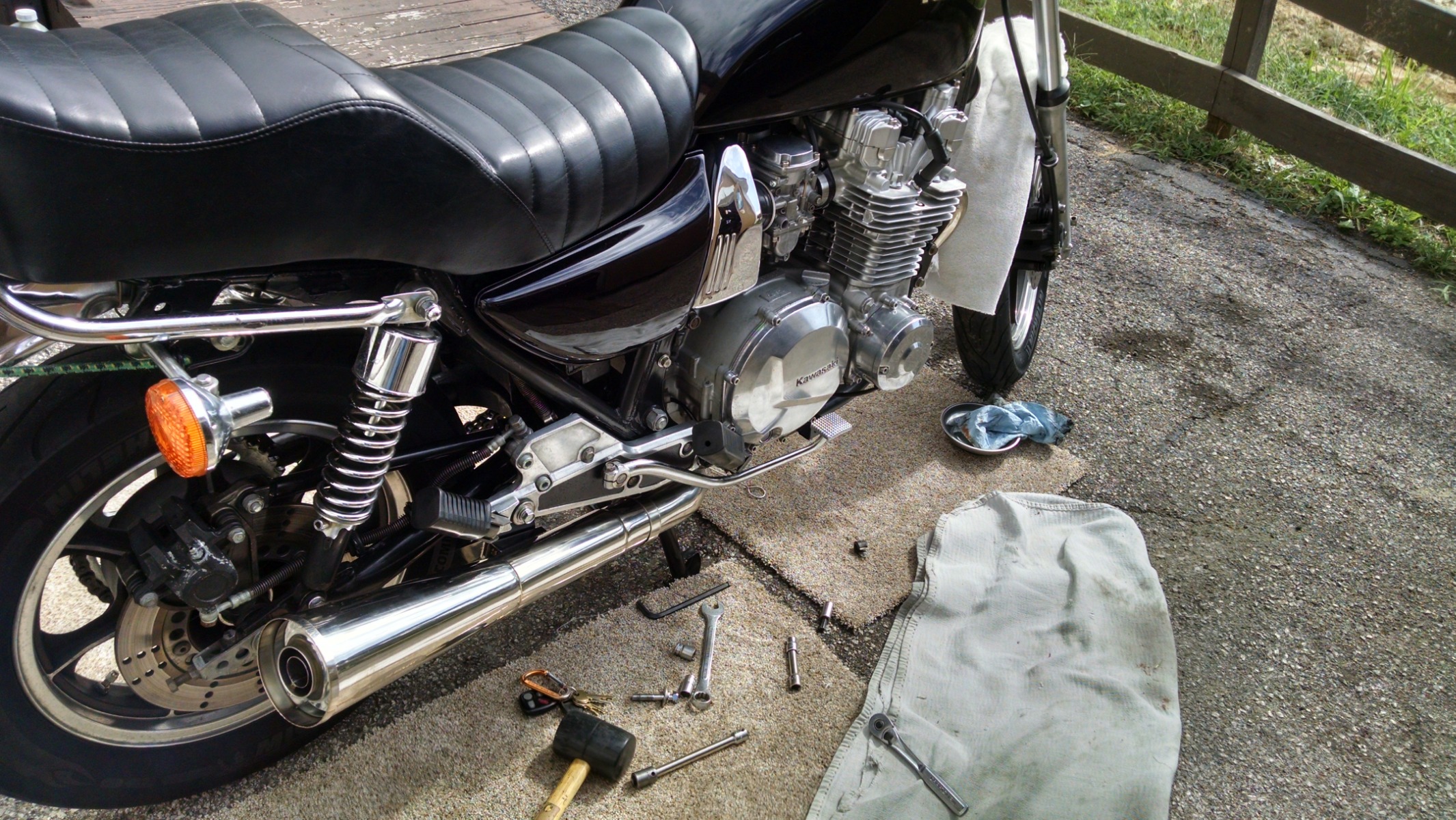

I got it installed today, Perry. There goes my stealth bike.. I seemed to pick up an "escort" within half a mile from home while on my maiden voyage. No more coming home quietly. It does have a deep "knarly / throaty " sound, turning my mild mannered, docile bike into the monster it always has been. (it was lurking under that quiet, muffled persona.)
I went to a carpet store and picked up some carpet remnants from the dumpster a few weeks ago, to try and keep the pipes nice.. at least until I got it installed.

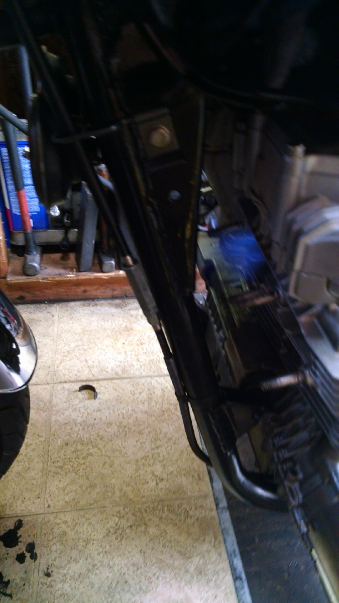

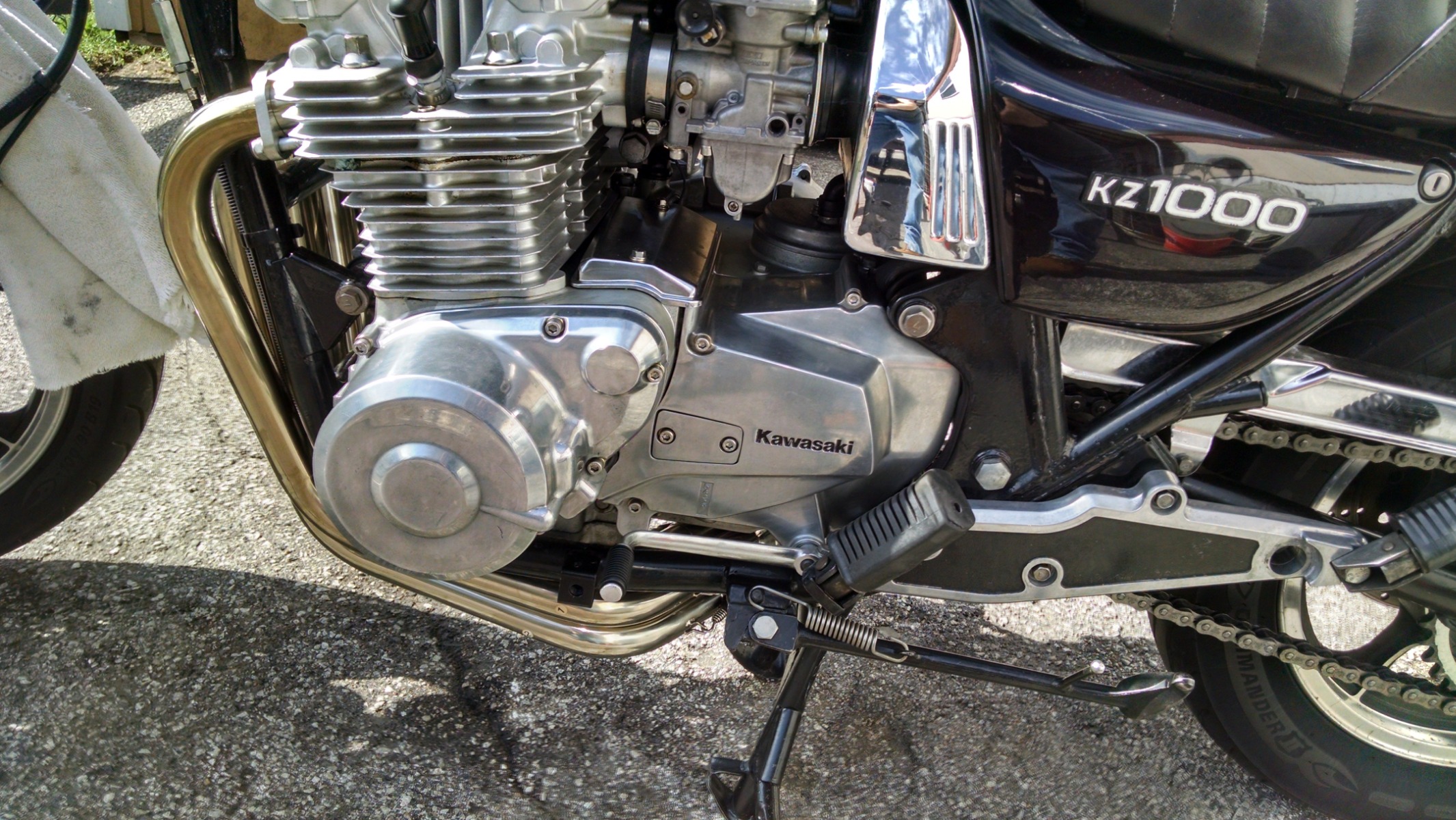

I removed the stock exhaust yesterday. I stuffed shop towels into the exhaust ports, sprayed on cheapo degreaser, then pressure washed the oil and crap off of the front of the engine and center stand. I let it dry in the shed last night with a fan blowing on it, since I couldn't give it the usual interstate 70 dry cycle.
All together, the install itself, after cleaning the bike up only took a couple of hours. It all went together / fit rather nicely. I reused my SS self lock nuts and flat washers on the flanges. They still look great after all these years on the bike. Note how the pipes are yellowing after only a few minutes of run time. Even with the yellowing they still look better than chrome / mild steel pipes turning blue.

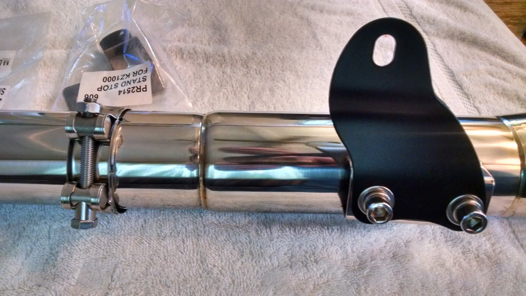

The stop for the center stand runs too close to the rear tire for my tastes. (aprox. 1/2") The pic looks like it is even closer, but it is not. I could have positioned it further away by bolting the silencer bracket to the outside of the muffler support, but that in turn would make the silencer stick out an additional ~1.5" from the bike. I may try to fabricate a different stop for the center stand.

Have you try to bolting the stop for the center stand into the inside of the silencer bracket?
This will give you more distance to the rear tire and a better fitment to the center stand.

07 Oct 2018 15:08 - 07 Oct 2018 15:14I am all for moving it anywhere, but it sandwiches the silencer bracket to the silencer, I don't see any way to bolt it to the other side.
Note that the silencer bracket is installed backwards in this picture.

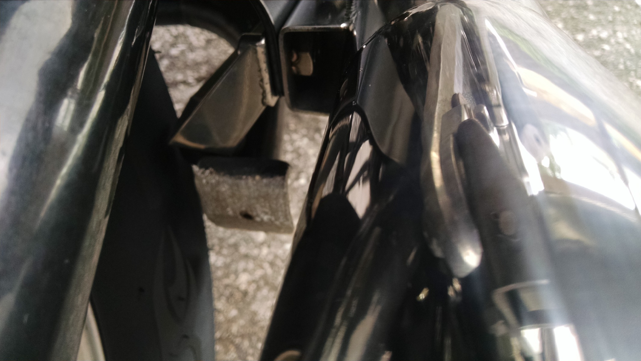

I didn't like the open hole in the left side of the bike at the rear muffler support, so I reinstalled the chrome bolt and rubber bushings by the LR foot peg. The big gaping open hole just didn't look right as you can see in the pic.
