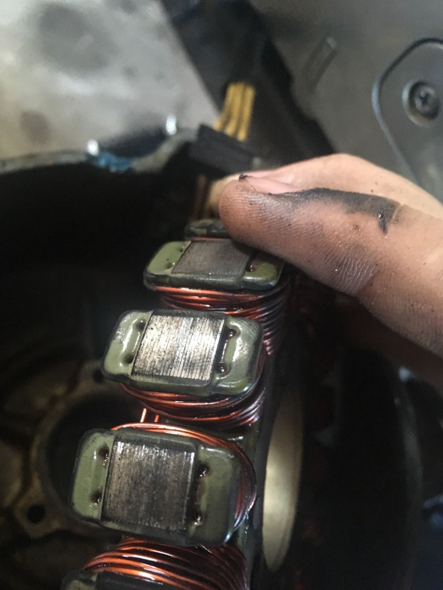

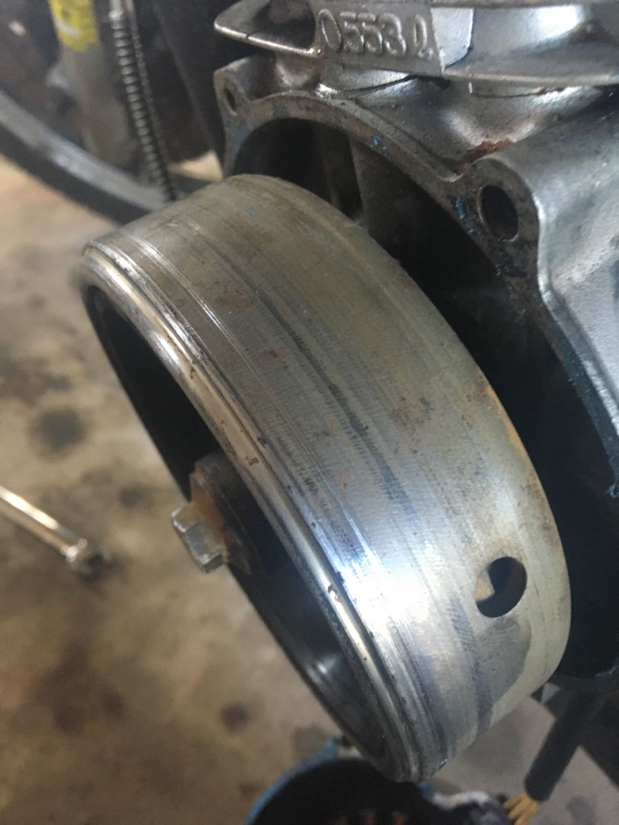

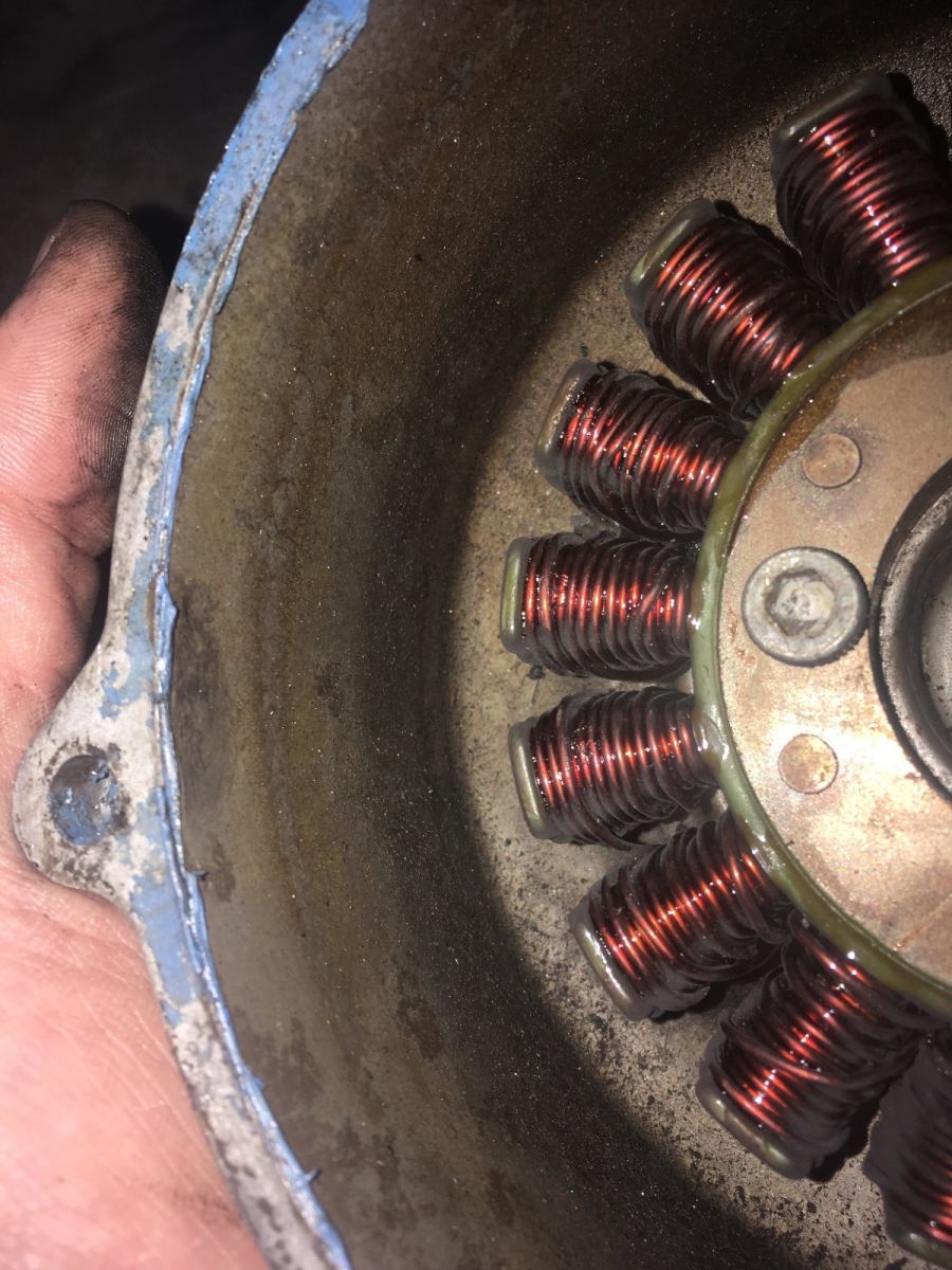

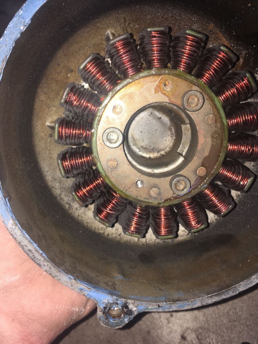

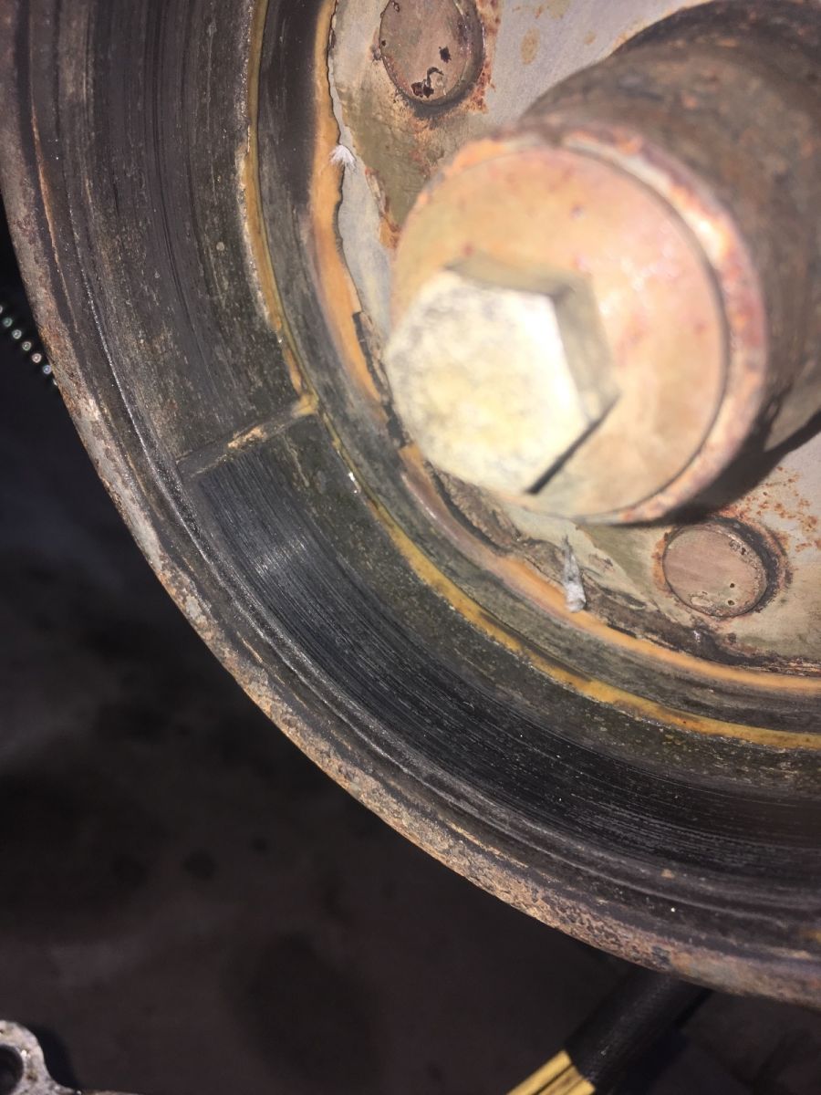

I took these pictures, I unscrewed the stator and screwed it back just to be safe. And there did seem to be some metal dust that gathered in there. Once I put it back together, the noise went away. I’m gonna Ride it around the next couple days and see if it comes back.
Re: Weird noise from crankcase
08 Sep 2018 14:49
Did you make sure the rotor was tight and no loose crap in there? Looks like it was rubbing on something.
