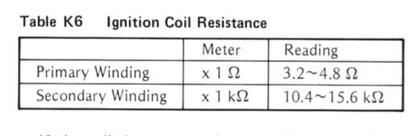

20 Jul 2018 13:46 - 20 Jul 2018 13:47hardrockminer wrote: Kawasaki bikes use two different coil impedances....2 and 4 ohm. (primary) Which one do you have and is it the correct one for the bike?
When the points are open what is the voltage on the green/black wire with respect to battery ground?
My manual says primary is 5 ohm, the coil is close at about 8 ohm. My OEM coil tested the same and it also makes spark when I reinstalled it today. Both have spark, the OEM one seems more stout. I would no longer call it weak. The secondary was 12.5k which is perfect.
I don't know what green/black wire you are looking at, but my points voltage is within 10% of battery voltage.
