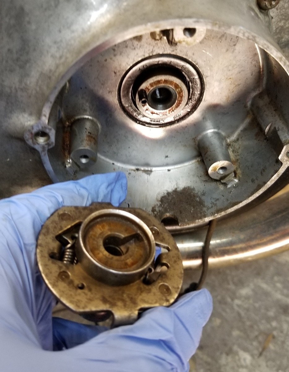

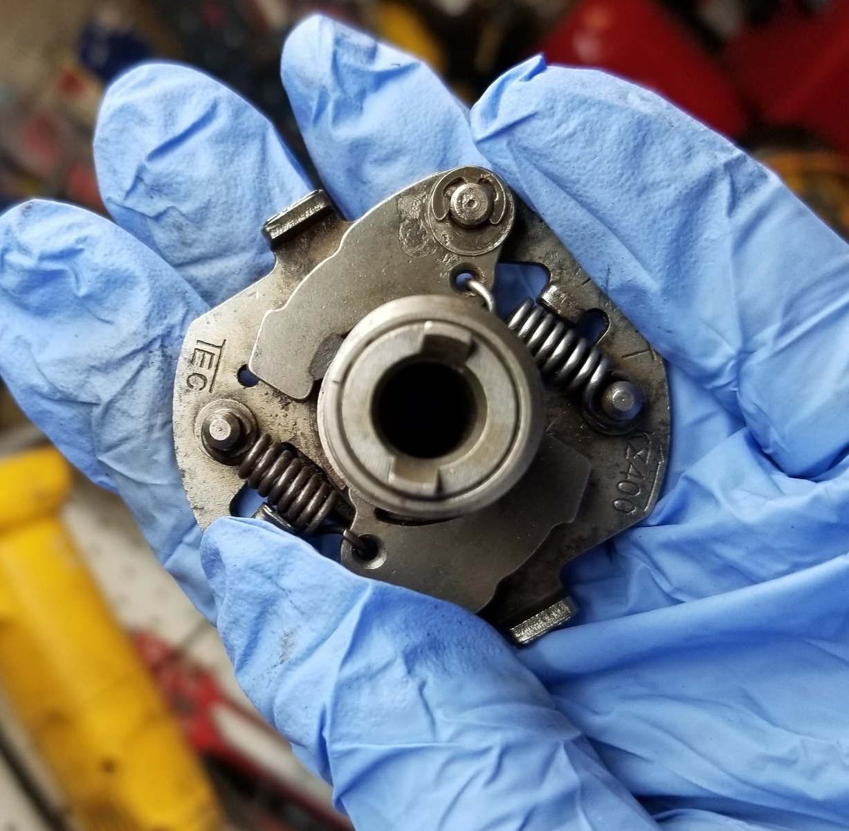

Video of timing. Set to the thousandth. Dead on balls. Contacts open perfect with timing line. Contact gap is. 4mm
Timing advance rebuilt. Very smooth and returns to center. Lobe and mark are lined up correctly.

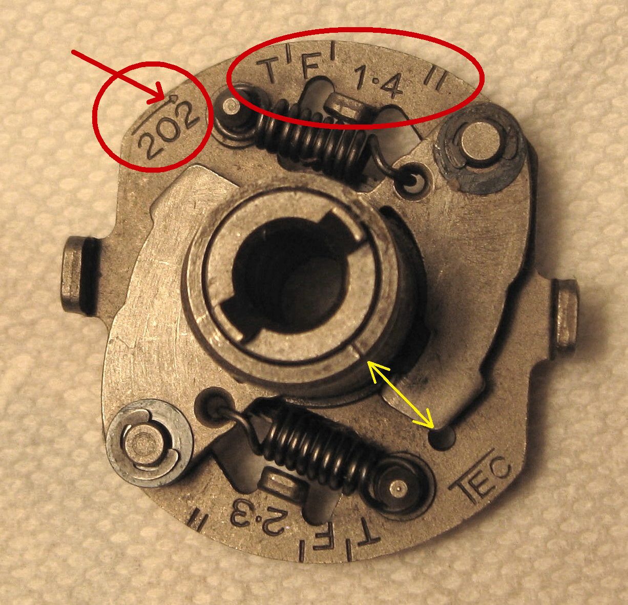

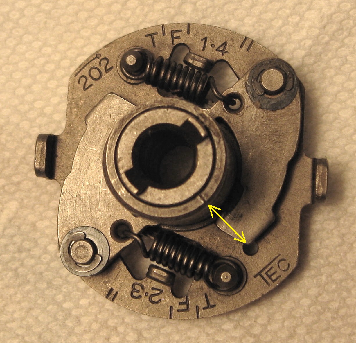

Regarding the points - the cam should have a mark on it and the back plate should have a hole in it. If they more or less align the points cam is on correctly; if they are 180 degrees off the points cam needs to be removed and re-installed so they align. See image below. Ed

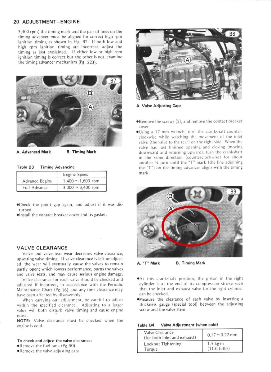

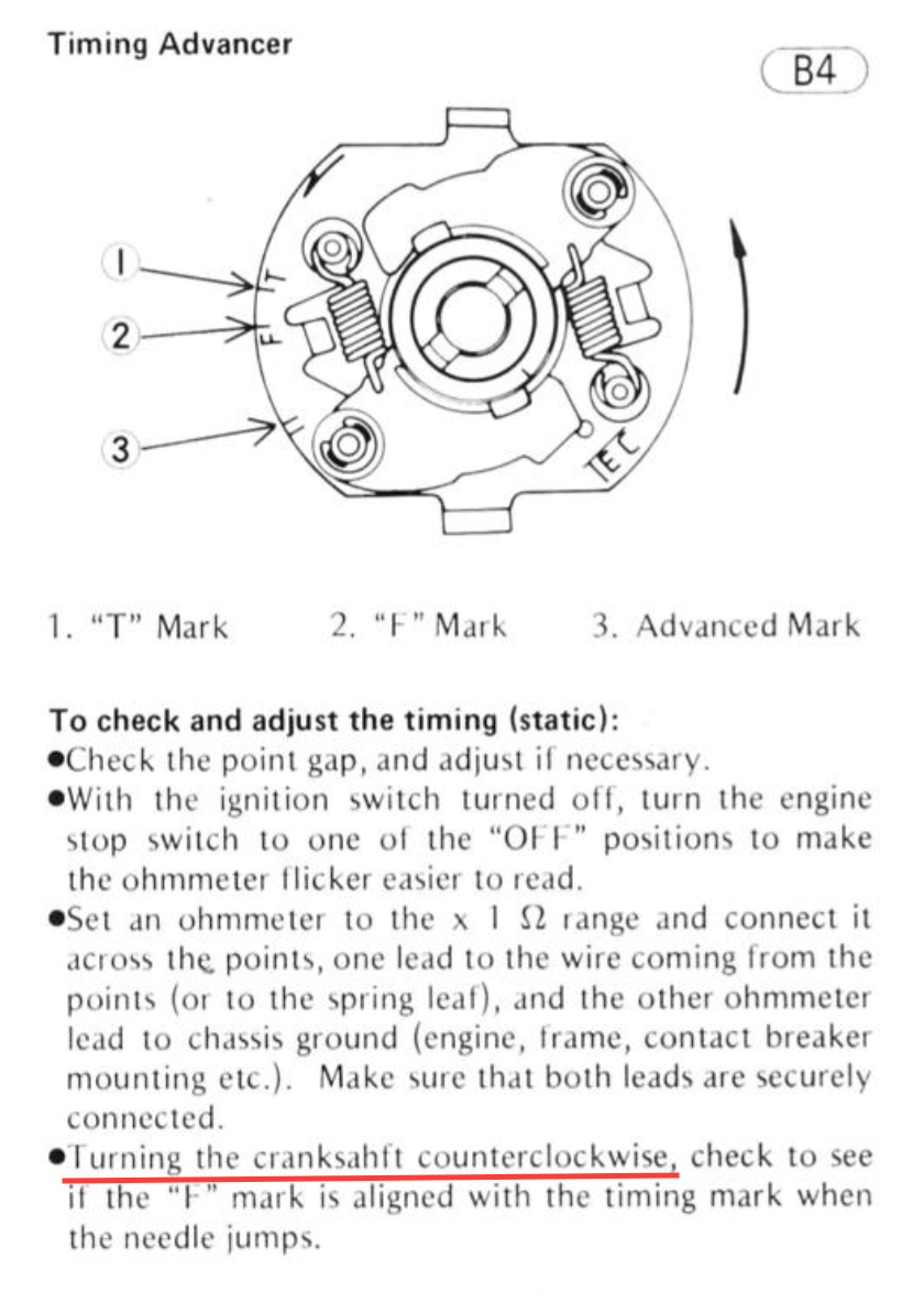

It´s sounds crazy but I think i got it!!!
In your video your engine turns/rotate clockwise on the pointer side with the e-starter motor. In the manual the timing advancer/engine should be turn/rotate counter clockwise!!!

18 Jul 2018 16:20 - 18 Jul 2018 16:40It's counterclockwise in the vid. I sure appreciate you looking it over, but if you look at my plate i posted the arrow goes the opposite direction than the timing advancer you're showing for the 650-1000. Infact i can't even make the engine go the other direction. Notice the typo in the factory service manual?
I've ordered a new coil pack. Todays testing shows with the plugs out i can fire carb cleaner into the intake and it come out the plug holes so it's doing what it should be mechanically. Even though I have spark I'm not convinced it's enough spark and still believe it's weak. Delivery is monday so we shall see!
