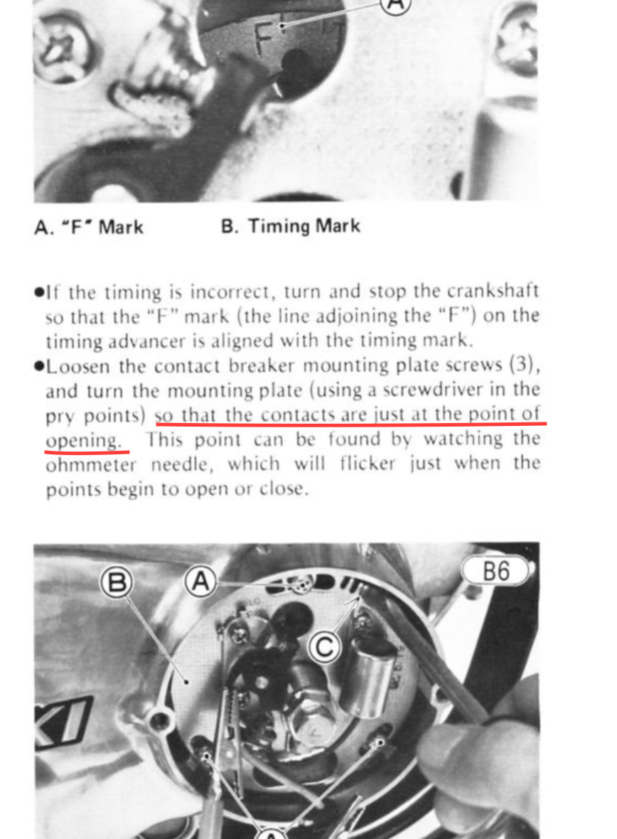

Just for giggles TRY rotating the advance sleeve 180 degrees on the plate to see it it pops? (as Nessism suggested)
I can't do that because the contacts would be CLOSING at the F mark. Review the video and you'll see they are opening.

Re: Best oil to unstick a stuck ring?
18 Jul 2018 16:46 - 18 Jul 2018 16:48
Are you sure it´s a typo???
Watch your e-starter video 10 times and for me the engine turns clockwise.
Try to push start the bike!
Last edit: 18 Jul 2018 16:48 by Scirocco.

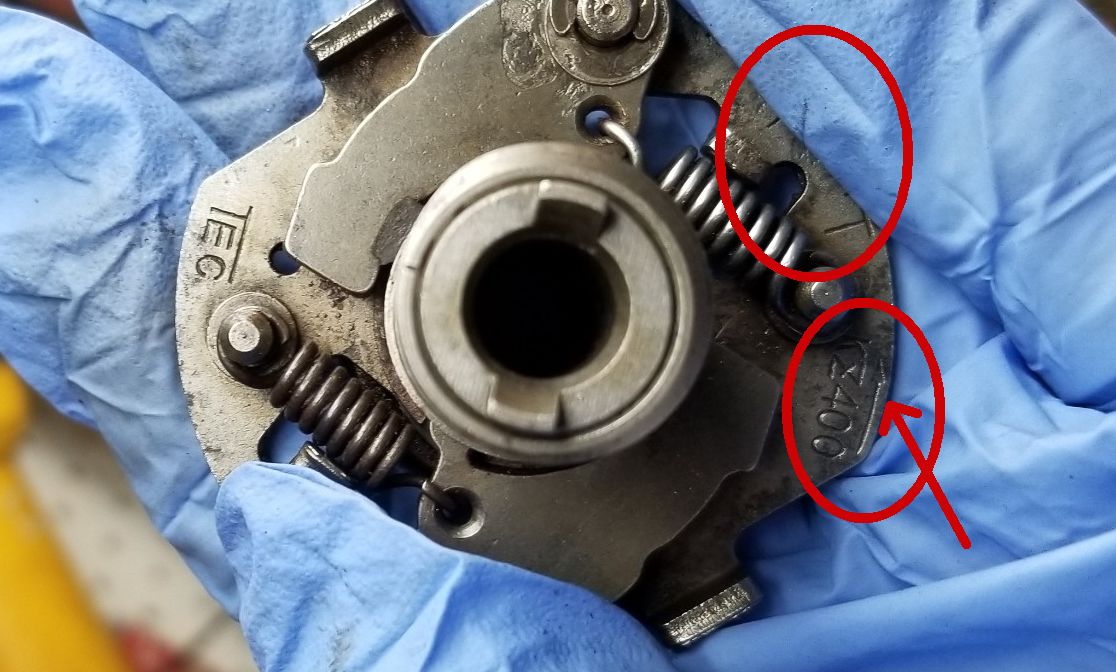

- old_kaw
- Posts: 929
- Thanks: 270
19 Jul 2018 22:48z1kzonly wrote: So with all this whatever? Did you pull the ;point cam off of the weights? And turn it 180 just to try it?????
might take ya' all of 1-2 minutes.
It does appear to be indexed properly. If you look at the pic with the blue rubber gloved hand holding the advancer assembly, the index mark on the point cam is indexed with the small hole by the "Tec" marking.. if indeed still indexed there.

Scirocco wrote
It´s sounds crazy but I think i got it!!!
In your video your engine turns/rotate clockwise on the pointer side with the e-starter motor. In the manual the timing advancer/engine should be turn/rotate counter clockwise!!!
I dont think its crazy. Very sane actually
I always thought that the kz twins are "backwards" running engines. If someone has managed to make a twin turn clockwise then ...................
See what Patton has to say here www.kzrider.com/forum/2-engine/592509-cr...t-rotation-direction
Likely because the running KZ750 twin engine crankshaft is turning opposite from the bike's forward rolling wheels.
In other words, the running KZ750 twin engine is turning counter-clockwise when viewed toward its starboard side.
Sometimes referred to as a "backward" running engine -- just like KZ400 twins, and Ed's old BSA 650 twin engine (even though BSA's sister Triumph models have forward running engines, so I've been told -- go figure).
