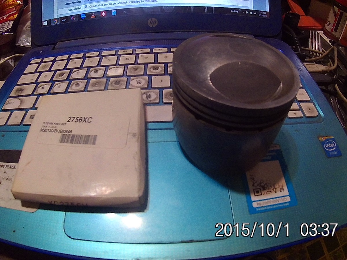

Thanks TexasKZ, and SWest that's exactly what I was looking for on the cams. It seems I got a deal for what I paid for that engine and it's not just a boat anchor. Now I just have to decide about the pistons. I am still wondering if they are wiseco's or something similar. If so there must be rings and buttons available to swap them over.

Re: anyone have info on the old Andrews 2x cams and piston kit
25 Jun 2018 14:34
They look like Wiseco's but put up closer pics inside and out to be sure. I have both styles. The rings fit both.
20 Oct 2018 17:34
SWest piston looks similar, obviously yours is cleaner
