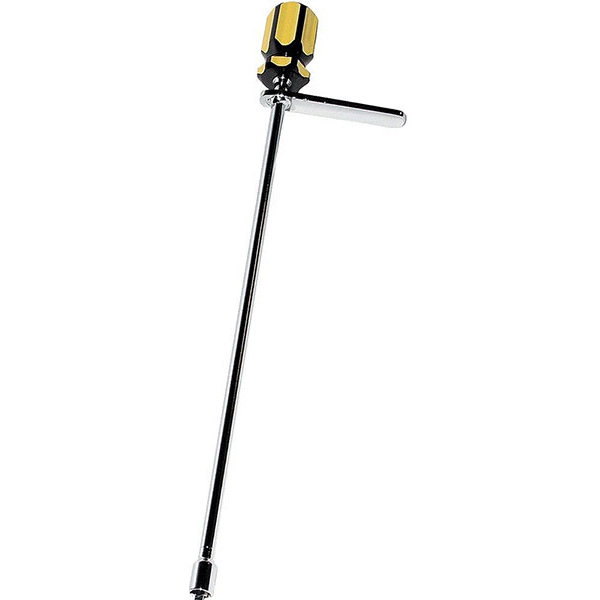

OK - thanks again. I've looked at some of the stuff you have on your webpage about the TK carbs - and I am going to resynch them using the tip you have about getting a hollow tube to hold the lock nut. I did find when I was doing it with a wrench that I was having a hell of a time keeping the adjustment where I wanted it when tightening down the lock nut which put things out a tiny bit.

Oh yeah. It's so touchy, I don't think I could do it without the hex tube.
And the locknut really only needs to be snug. The threads are super-fine, so easy to strip.

If you are running the stock TK27 Carbs, carb sync is made much easier with this tool. Motion Pro 08-0022.
