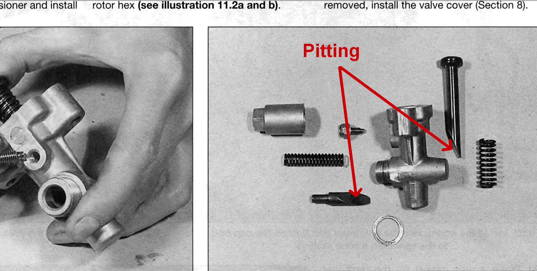

Don´t trust an automatic tensioner.
Have to do some work on an automatic tensioner on a friends 750 Zephyr, same symptoms like yours.
The automatic tensioner internals are stuck without any re-tension movement.
Have to do some fine sanding/polish and cleaning on wedge shaped tensioner rods, (a little pitting marks), to get the movement back to normal automatic mode.
Try to reset the automatic cam chain tensioner.

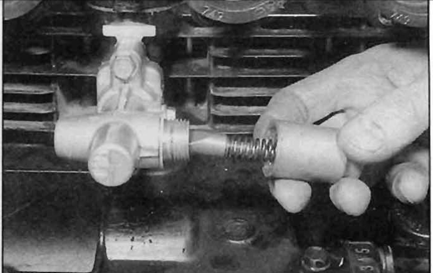

I don´t know if it look like your tensioner but some pics of your tensioner would help.
The Kawasaki ZR 550 750 Zephyr 1990-1997 cam chain tensioner parts
550
750

I've never seen a 550 have a tensioner problem (unlike the 650 and 750's).
If you find you need to remove the valve cover, you might want to read the valve train warning in my signature. It will also have a bunch of cam related info.
