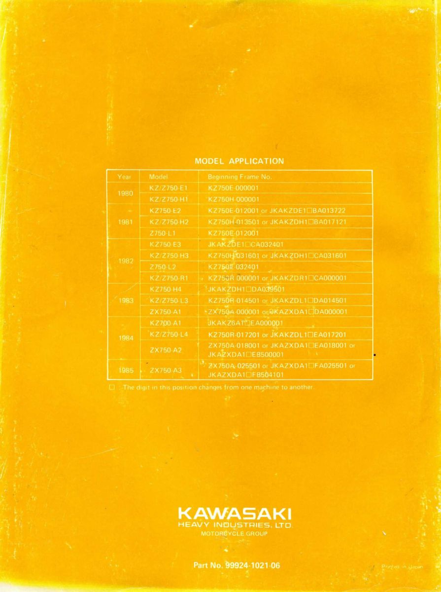

Lift the valve cover and check the valve clearance for hard facts, do a write up for later adjustments. Get a service manual @
www.750turbo.com/manuals/GPz750_Base%20Manual.pdf
