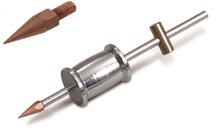

Another option is a sliding hammer, (dent remover) with a dot welding electrode.
