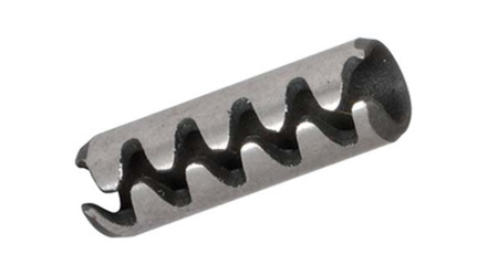

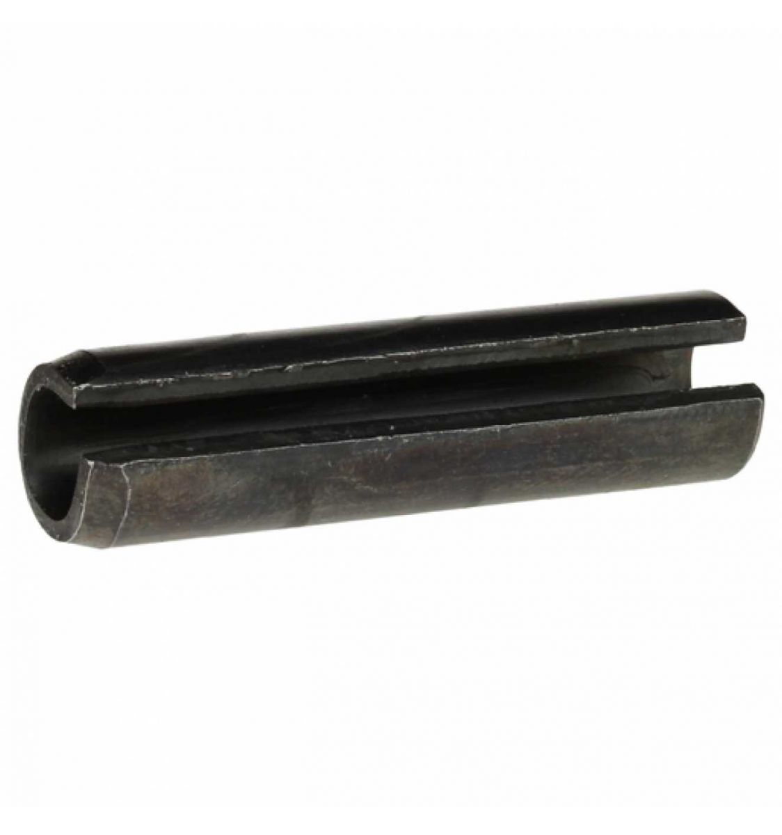

29 May 2018 15:38I have done the same thing. Use a carbide drill bit and get a compression pin and tap it into the hole. It is always nice to drill a straight hole and it is a lot easier to do this with a carbide drill bit (I think I already mentioned it). I have fixed several this way and it works fine.
This is the compression pin wiredgeorge talk about. This would be a good alternativ if a bore have a little greater diameter as the dowel pin.
