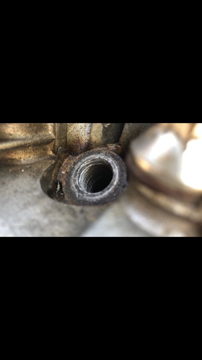

Was working on my bike. Took a day off because its HOT here in NYC and I wanted to ride. Changed the clutch cable this morning on my 77 KZ650 and then the mrs got upset because I was in the garage doing other stuff from 7am to 9am.
Took a break and then thought I should change the plugs. When back into the garage and was changing it, and the Mrs comes, yelling full tilt that I havent take the kids clothes out of the dryer. I was annoyed and continued screwing in the new spark plug. She distracted me and it stripped the thread in the block.
I was so angry i nearly fainted. Now what? Here is a pic

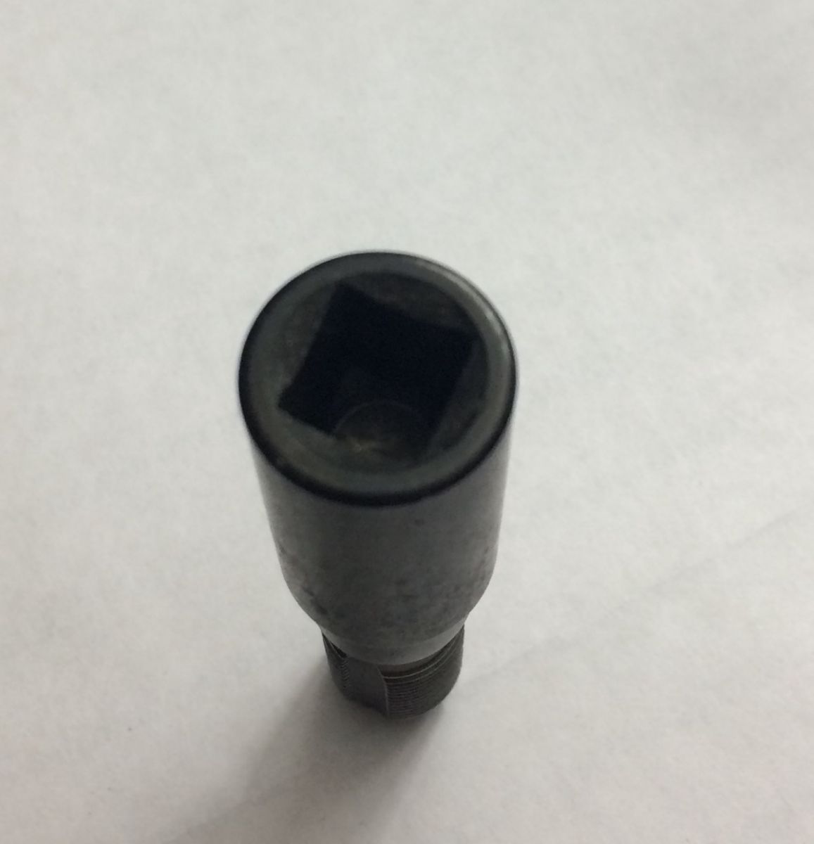

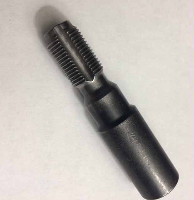

I was going to post this for the other Guy 9er in Colorado.
But this is a must for your tool box for working on old motorcycles, or anything with a 14mm spark plug.
Common at all Chain Car Part stores. This is about 20 yrs. old. 3/8" drive. Has 3 slots in it, hardened steel. Don't waste your time and effort grinding slots in an old plug. These are under $20 bucks.
A little grease and turn it thru all the way. It's as good as it will get it.
If too cross threaded you will need a time sert or heli-coil. Both can be done on the engine without taking apart! Remember aluminum shavings are soft and wont hurt anything in an engine. Just look at an oil pan taken off a running bike, It's full of crap most times
Good luck!

Sorry to hear, wife's and bikes don't always mix that well.
Anyhow, head off and helicoyl, v-coil or timesert it.
People have done it without removing the head, but that is not the best of ideas in my neck of the woods.

Thanks for this. I have a local shop nearby and they fixed it....for $100. Beats hearing my wife yell at me for being in the garage.

So I bought A 14 mm x 1.25 back tap through amazon, $29.00 It arrived in 2 days. I was charged for 1 but they sent me 3 Ill give it a try and then maybe buy a plug tap.
