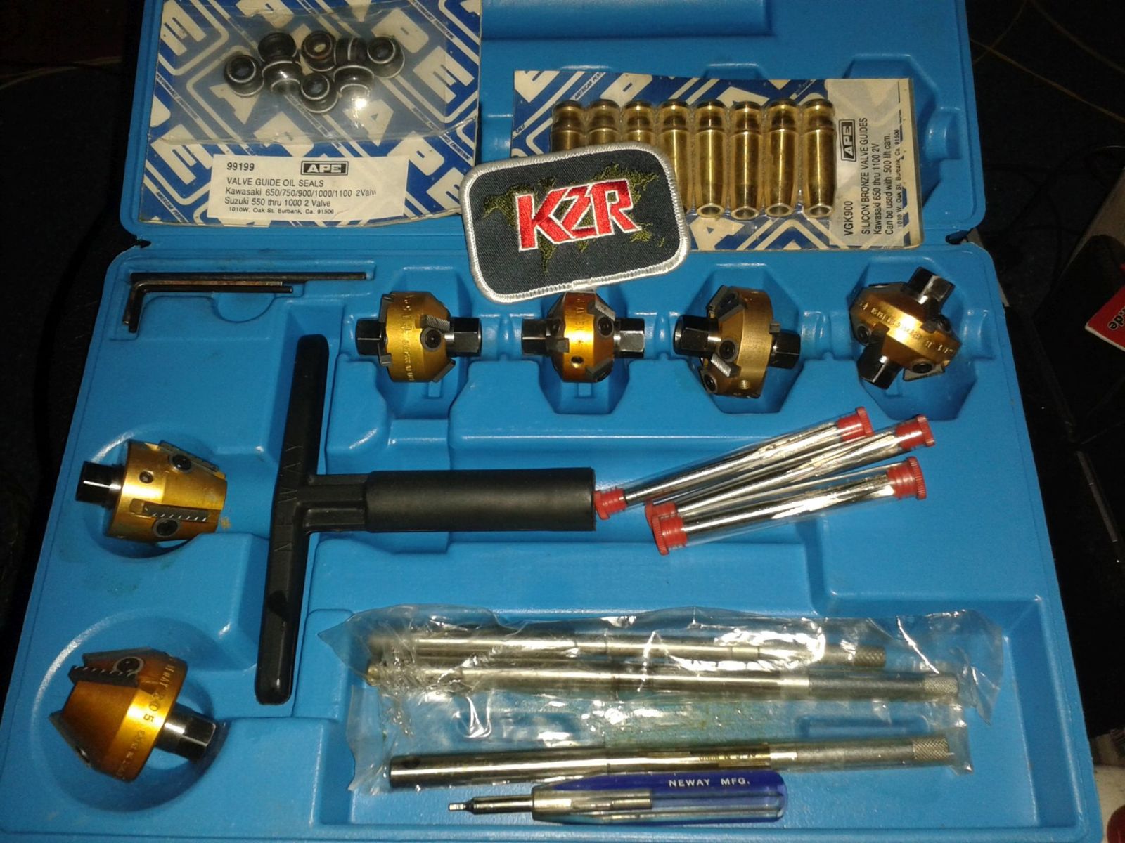

The law for every 3 angle valve job is = less is more.
2-3 turns with a NEWAY valve seat cutter on a valve seat ring is more you need to resurface
the leak between the valve/seat surface.

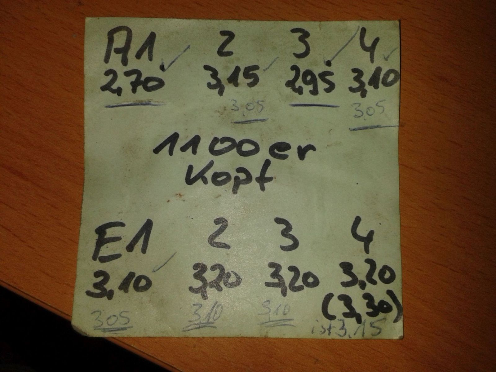

I have to renew all my valve seat rings in my head a decade ago. My shim size is now 2,70 - 3,20 mm.
