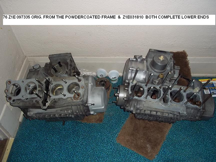

No eBay APP ID and/or Cert ID defined in Kunena configurationThanks Doc, good info to know, I forgot about the aluminum expanding with heat. All said and done.
I am not doing this now. I listed a 1015cc block on eBay. And I did not want to list that it could fit on to a stock 900 engine.
Of course if someone has engine apart, and knowledge. It is no big deal.
But good to know for future reference. I keep saying I am done with this stuff. But more parts seem to turn up onto the garage floor.
Selling this on ebay:
