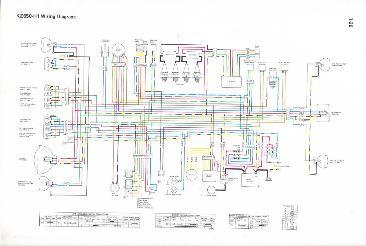

will try to get some more pictures with a better device. my phone is too old to send the pics to my email to post on here and my tablet is weird with its camera. but i did contact the motorcycle shop again and they told me i needed 2 main grounds, one to the engine block which i have and one to the chassis which i do not have and is what im expecting is where the ground connector came from. i was looking at the diagram and there is one thing that is making me confused. at the left side of the diagram where the ground wire connects to the turn signals (ground is black/yellow) it splits into two black wires. one to each turn signal but on the diagram there is an empty circle where the wires come off the lights, does this indicate a chassis ground?
