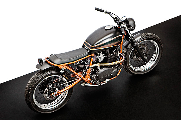

I believe that is the first big bore bike Per from Wrenchmonkees built, 970cc.
The bike I was talking about is his own bike which have a similar 970cc engine in it.
