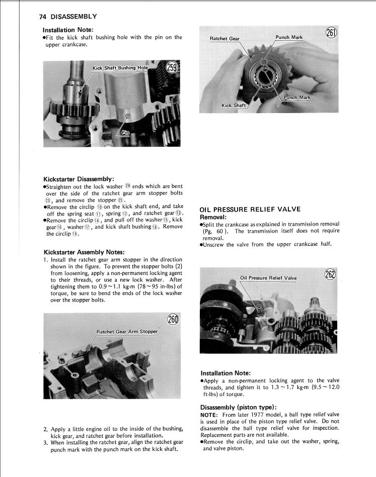

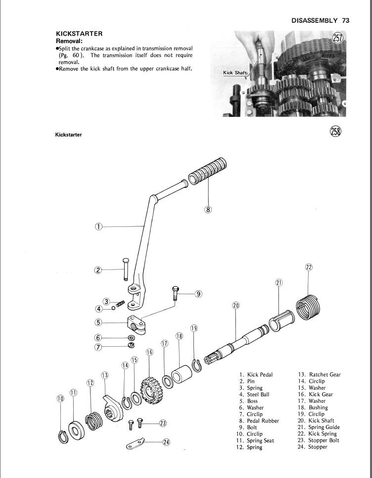

1978 Twin that has been idle for 12 years (notice the mold on the grips)
. Just got the engine unstuck but the kick start will not return upright. I pulled the cover and it was hard to get off. The shaft does not look centered for the cover hole and when I actuate the shaft with the kick pedal the shaft swings in a small arc. I can't believe the shaft would be bent as the pedal and cover look fine. Is the shaft maybe not installed or seated properly? Can I pull the shaft without messing up the gear and ratchet mechanism? Thanks. [attachment=113040]20171105_133429.jpg

Hi,
I#m running two Z 750 twins and I can confirm that you might have bent the kickstarter shaft to a runout of about 1 mm just by kicking the twin engine
To improve the situation I have installed a shaft with increased strength

Unbelievable that a tempered shaft can bent by kicking a twin engine.
Must be a faulty construction. Is the new shaft a new stronger revision by Kawasaki?

Thanks for the response. I believe it is bent now. I put in a new seal (old one was damaged) and it seemed to help but I still have to lift the pedal a bit before it returns. Oh well, hopefully not going to be kick starting it much.

If material stresses from use are overseeding material stress limits also a tempered material will plastifie and the shaft will bent. The new shaft isn't Kawasaki oem, I had it made by a prototype workshop.
The good news is that you can also straighten a bent shaft.
