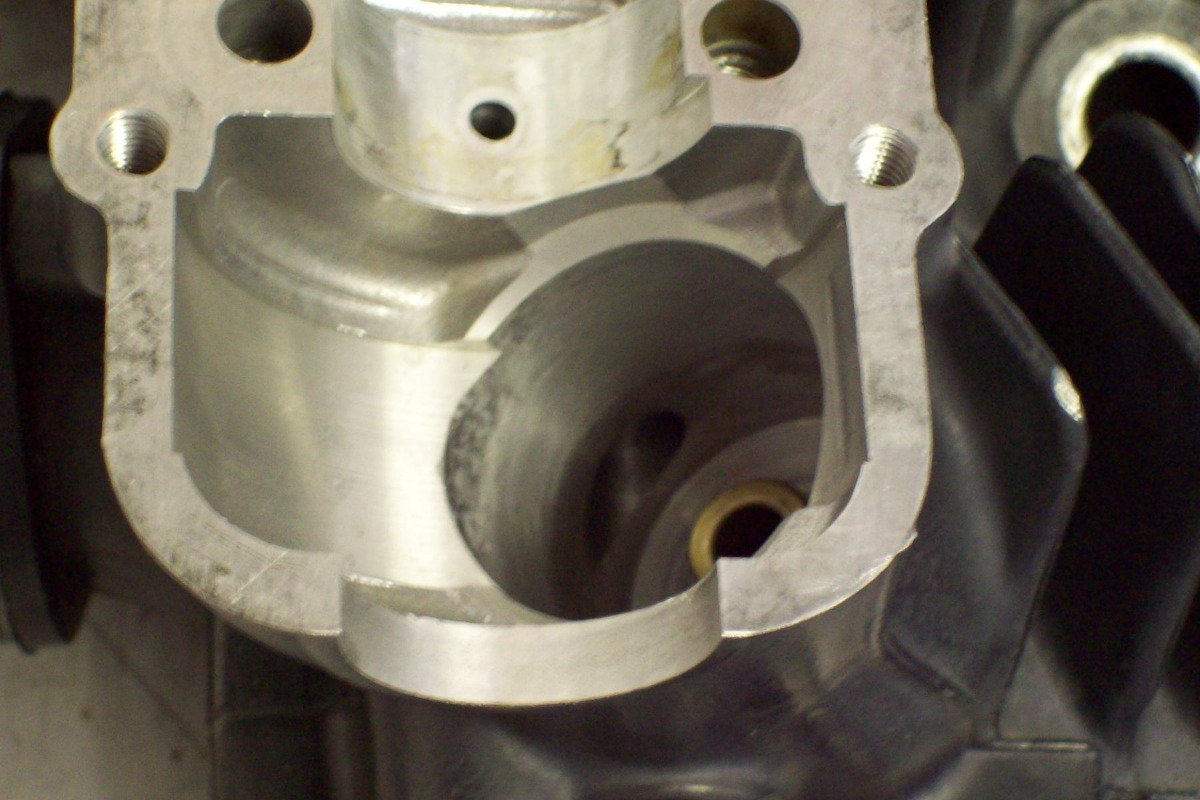

.440 lift cam is pretty big for normal street use. You will need to relieve the head on the thrust side of cam lobes too. Plus I don't know if the valve reliefs in stock pistons are deep enough for that big of a cam. Better check piston to valve clearance real carefully!! Heavy duty valve springs are a must with that big of a cam. I ran shim under buckets in all my KZ motors. With that much lift, they are a must!!!
Personally I would try something around .385 to .410 lift for a nice street cam.
Here is a early model head relieved for .450 lift cams.
