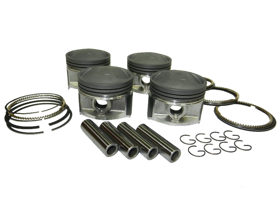

Here you can get piston kits with +0,25 / 0,50 / 1,00 / 1,25 / 3,00 mm over size for your bike
with MOS2 coated and annealed pistons.
He can also doing the the drilling and honing of the cylinders - in conjunction with the piston purchase at a bargain price.
www.scheuerlein-motorentechnik.de/motorr...750l1-l2-1-uem-.html

Scirocco wrote: Here you can get piston kits with +0,25 / 0,50 / 1,00 / 1,25 / 3,00 mm over size for your bike
These is top quality?

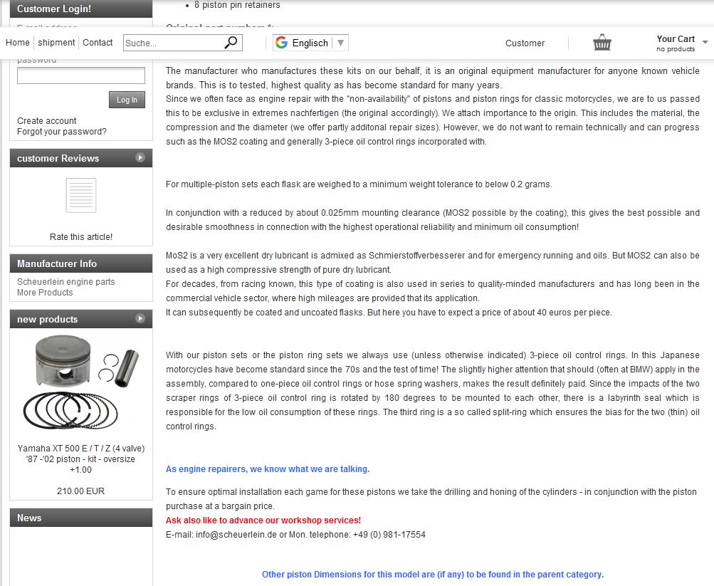

Re: 750cc oversize piston +0,5mm
13 Dec 2017 14:15
#775995
"The manufacturer who manufactures these kits on our behalf, it is an original equipment manufacturer for anyone known vehicle brands. This is to tested, highest quality as has become standard for many years."
It is OEM quality made in Japan
13 Dec 2017 14:19
#775996
Yes I saw that line., just dident not if it was true...
Thank you for link to these page, now I need to talk with the engine workshop 0,25 or 0,50.
Thank you again.
