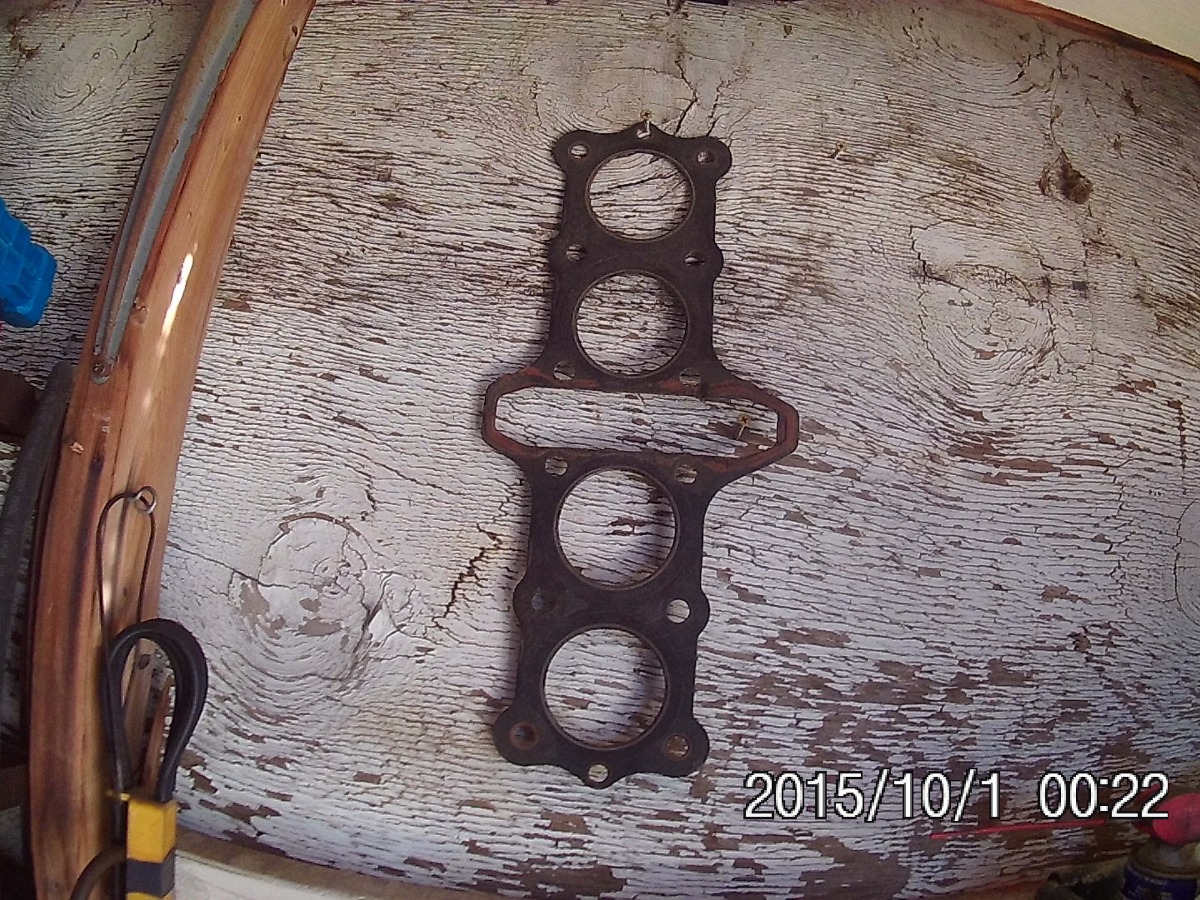

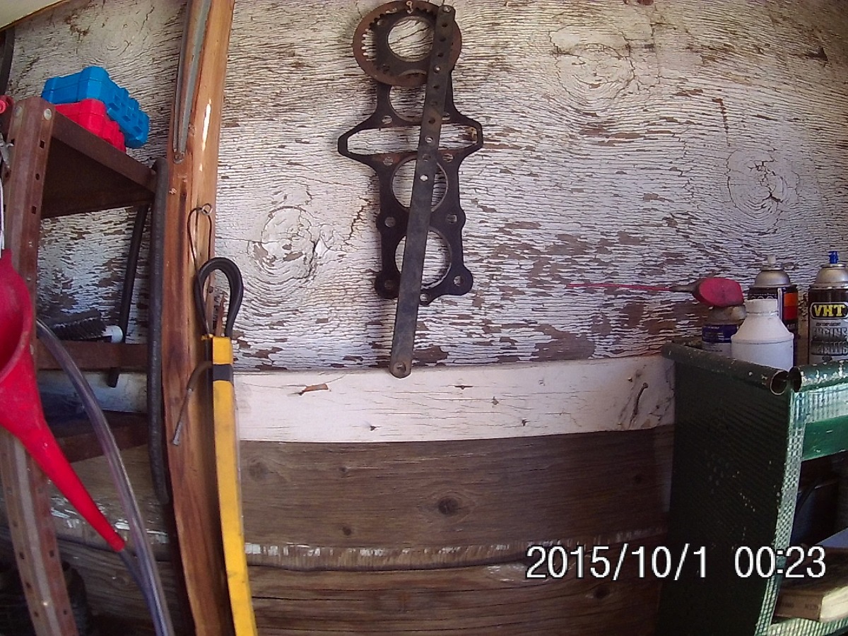

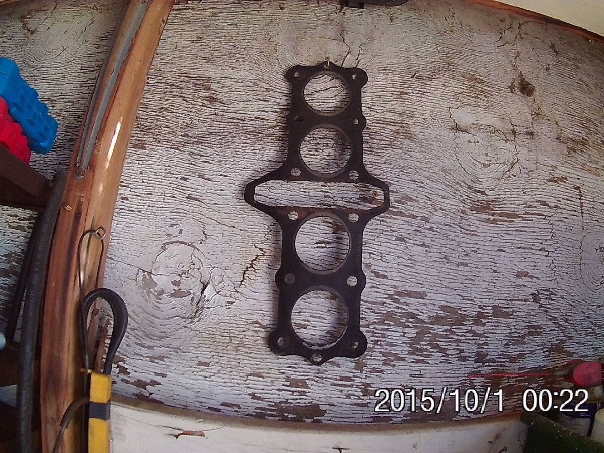

I got the early Z1 gasket because it was cheap and to see of it would leak. It worked great but I could see in my mind the edges glowing and causing detonation. It didn't but I feel better having the proper gasket this time. This is the second use I've gotten out of it. I have the other one hanging up in case I need it in a pinch.
