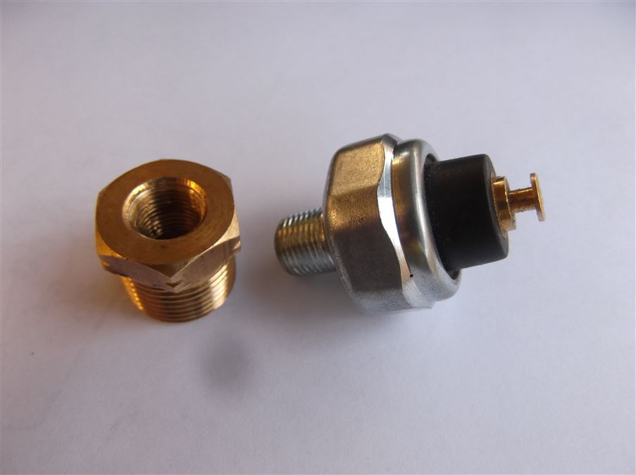

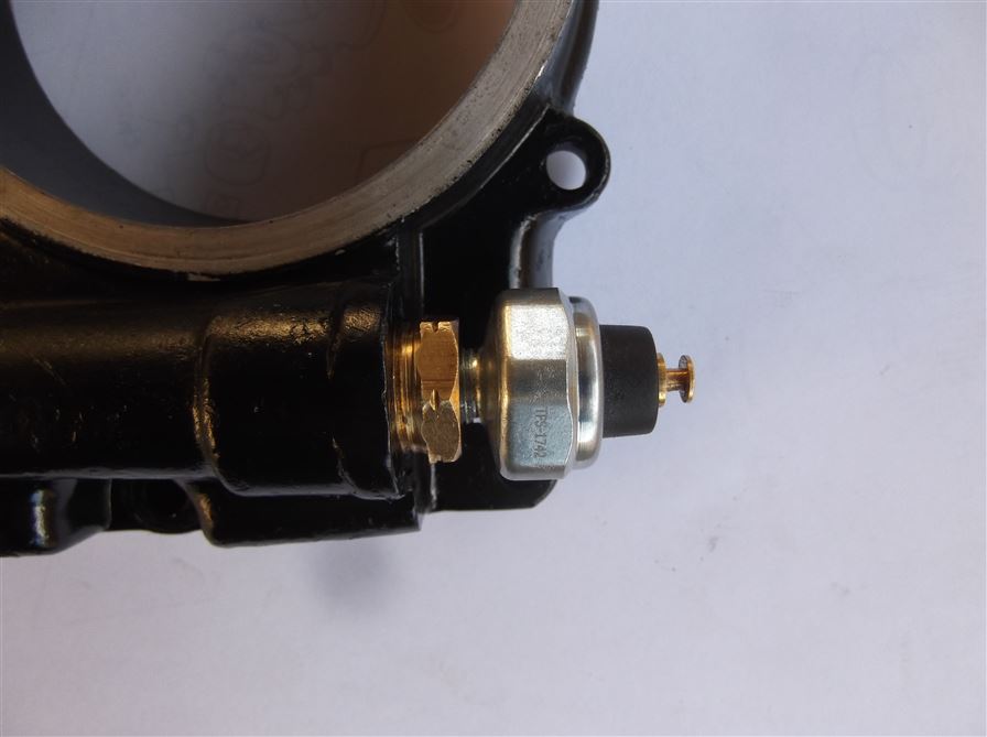

The local auto parts store will have a 3/8 male-1/8 female reducer.
While reading the FSM on came across the OIl switch thread size/ its a bit ambiguous as all it says is PT 1/8..
i cant find the factory pressure switching point so i cant just buy a cheap after market option

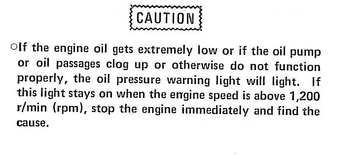

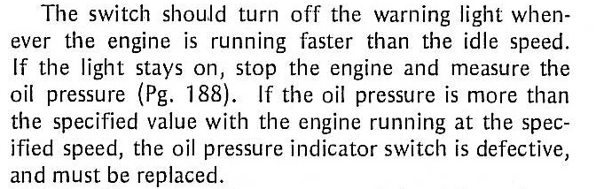

some clips from the base manual.
Sooo if im reading that right. the oil light is on when the bike is idling :whistle:

Maybe my pressure switch is weak and turns off too soon? I haven't ever put a gauge on it.
That's partly why I never put an indicator light for oil pressure on my other two bikes. It seems like the bike would have to be almost entirely out of oil before the light would come on. (My home-made indicator gives me a green light when pressure is good and 4 red lights if the pressure is too low to activate the switch.)
I just make sure to check the oil level frequently.
When I do an oil change, and restart the bike, the light does stay on red longer than usual.
I would revise that text to read "If the light comes on at all while riding, immediately lock up the brakes and stop the motor."

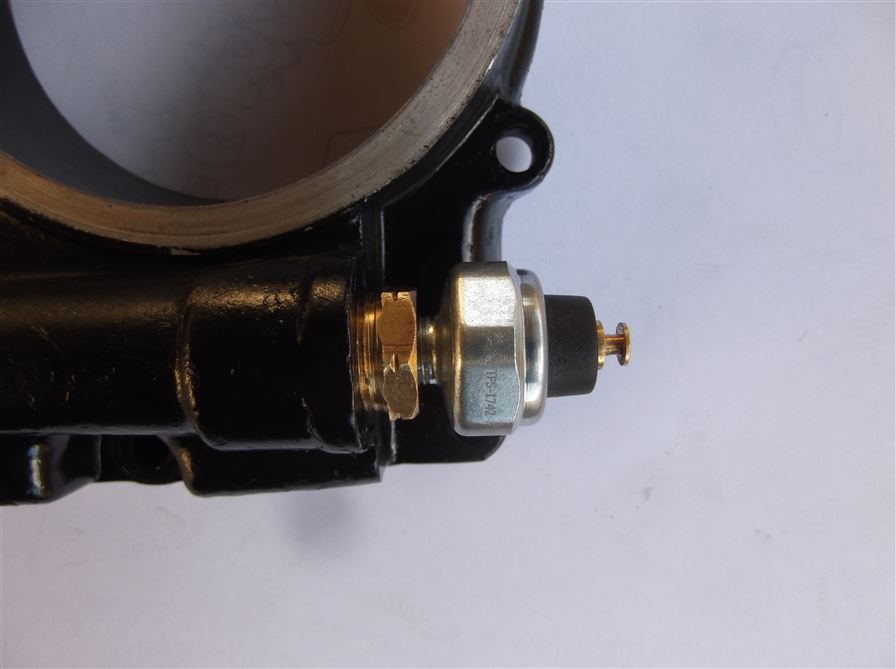

No drilling and tapping required Once the motors back in i will wire it up to an LED.

Back in 2008, I tried adding a Daytona Oil Temp Gauge pick-up to that location, and if you are using a 4-1 exhaust(street or race), it might come too close to the header. Good place to get pressure from.Wozza wrote: I bought a 3/8" - 1/8" BSP Reducing Bush from the local auto parts store and a 6psi pressure switch. They screw straight into the main oil gallery in the oil pan,
I would think oil temperature would be just as, if not more important than oil pressure?

The Light will just warn me something happened in the oil feed circuit and needs further investigation.
I am also going to blueprint my oil pump to get the best from it before its refitted to the engine, then hook up my pressure gauge i use for testing to get a feel for what the pressures doing at different temps and rpm then just running the warning light,
The oil temp gauge would be much more practical as its directly related to how the engine is being used or abused at the time
I thought about using one of these AN fittings to put a sender on the oil cooler line
