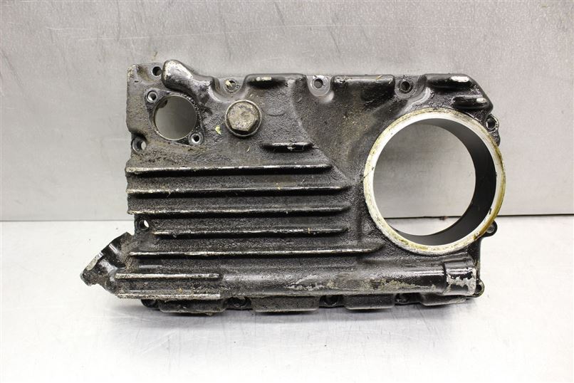

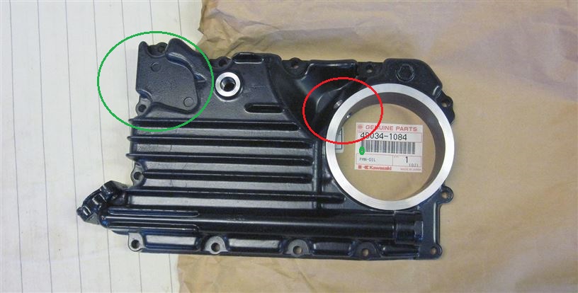

Well I had a look at some photos of the ZR550 Pans and as far as i can tell they look pretty much the same as the earlier GPZ Models . The main difference being if the they machined for a oil level or oil pressure sensor;
This might be a straight swap for someone wanting a oil pressure port,, as I have access to bspt taps i will just modify the one i have
On the ZR550 pan below you can see the spot where the oil level sensor hole would be machined. (green Circle)
the oil sensor gets its feed from the large hole where the oil filter goes (red circle).
Heres a GPZ550H pan with no oil pressure sensorr hole

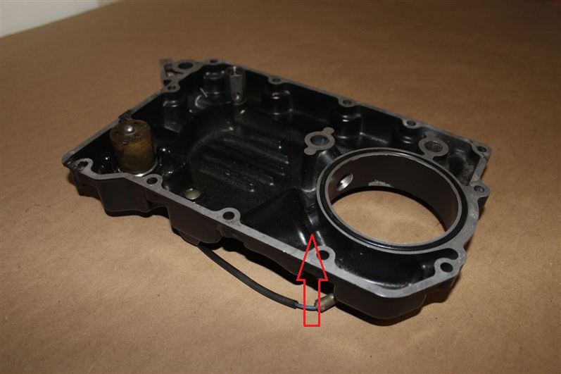

On the other side of the GPZ pan you see the lump (arrow) where a oil pressure sender hole would go as on the earlier and later pans

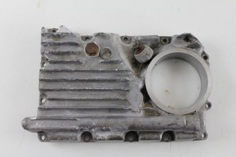

KZ550 pan with oil pressure sensor but without the oil cooler ports for comparison

Great info! You are the 550 oil pan king!
That's interesting that the pressure switch just measures the pressure in the filter housing. Seems like you should be good to go then... just a drill and tap job, correct?
